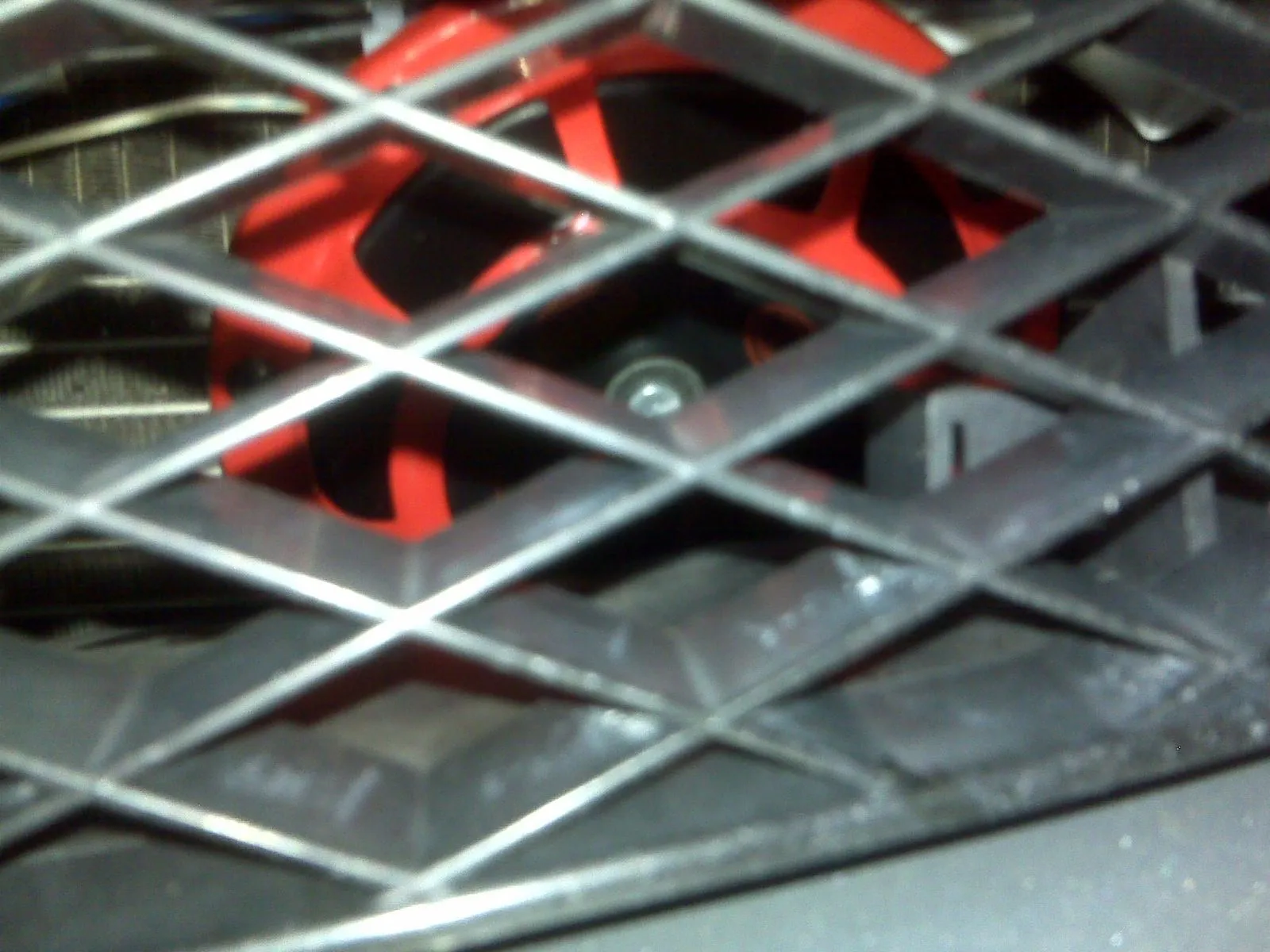

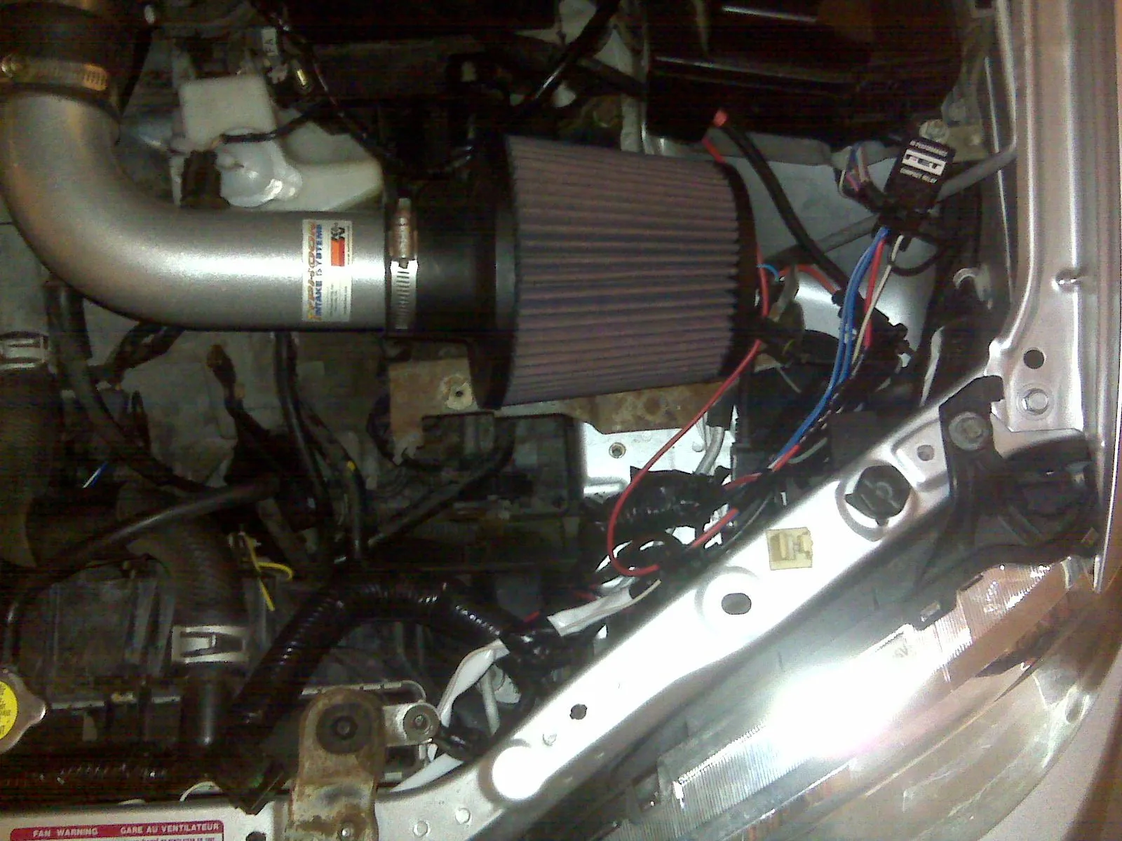

I just did up all my wiring... I had the harness from my Fet Catz SRs, I crimped on connectors and gonna see if it works. All the lengths are just about right, trimmed down some of the wires, and it's pretty slick... I do have extra connectors and a bunch of wire in case it doesn't work. Not sure if the relay is powerful enough,
Alright ladies... I installed the Supertones tonight... They were pretty damn easy to put in, I already had the wiring harness fabbed up, so it was a matter of putting everything in the right place, running the wires, and then getting them bolted down. Wow. What an intense sound, the youtube videos don't do them justice. Here's a crappy video from my BlackBerry... http://www.youtube.com/watch?v=BhpPYoqalRw

I'm wondering if the fog relay I used is really beefy enough, I don't know if it's 30A or just 15A. Doesn't say anywhere in the install directions I got with the Catz SRs. I have a bunch of full size relays around, going to see if I can get better results with them. I like the tone of the horn, not sure if the full volume potential is being realized though.
