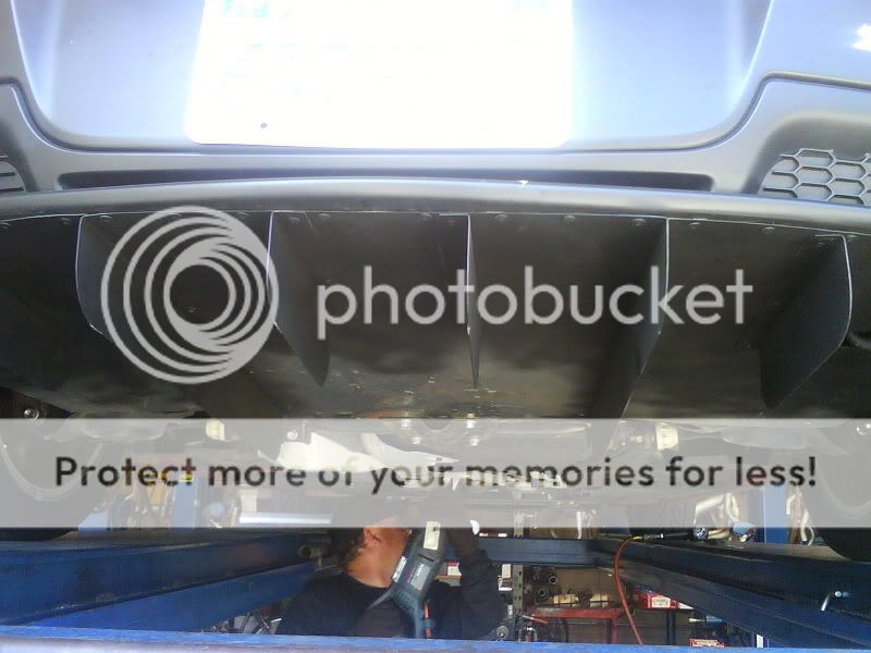

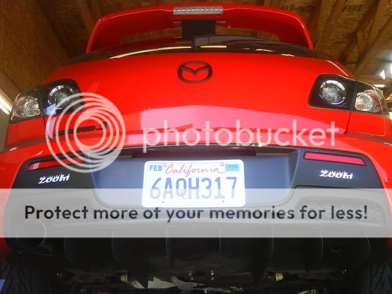

ok, if found these 2. Now, this was the first one he made and the guy he made it for was kind of being a dick so he didnt end up completing it.
I'm pretty sure you can feel rear flying going over 100mph...
hope material is thick enough so those ribs wont flex on high speed too..
would be nice to compare aero test results of this to stock ))

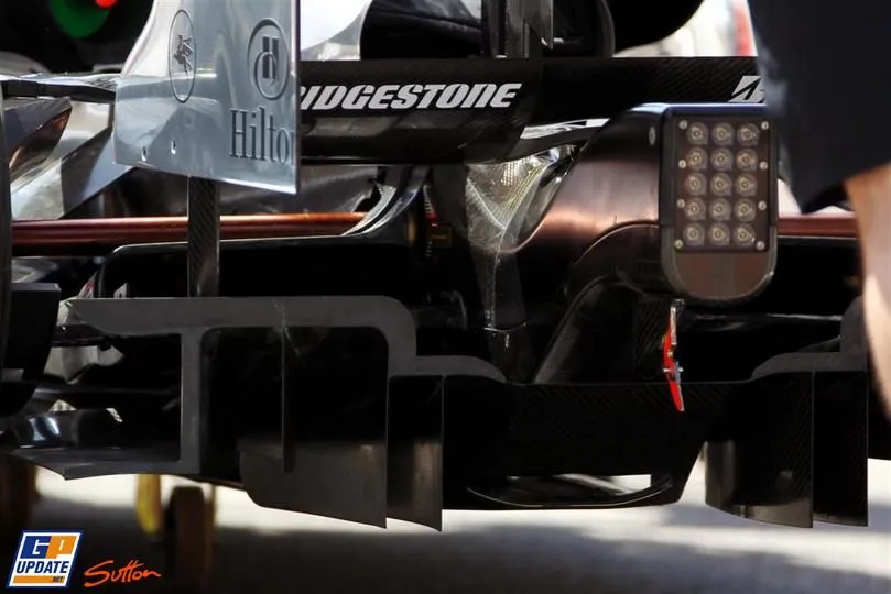

I think the manufacturer is english

Turbo23 is correct. Rear diffusers have an almost negligible effect unless the entire underside of the car is a flat sheet. Also for diffusers to be effective they cannot slope up at a super steep angle. The one we churned out at work for a top speed salt flats car I think was between 7-9deg. I think I remember being told that once you get over 14deg flow separates and the piece doesn't work.
With all that said, I think the DG piece looks great, but I doubt it helps from an aero standpoint.
