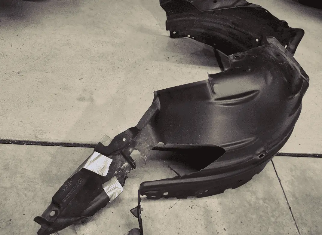

Attached is a picture of a liner that the clips/pins fell off and it hung down and was broke off by contact with the moving tire.

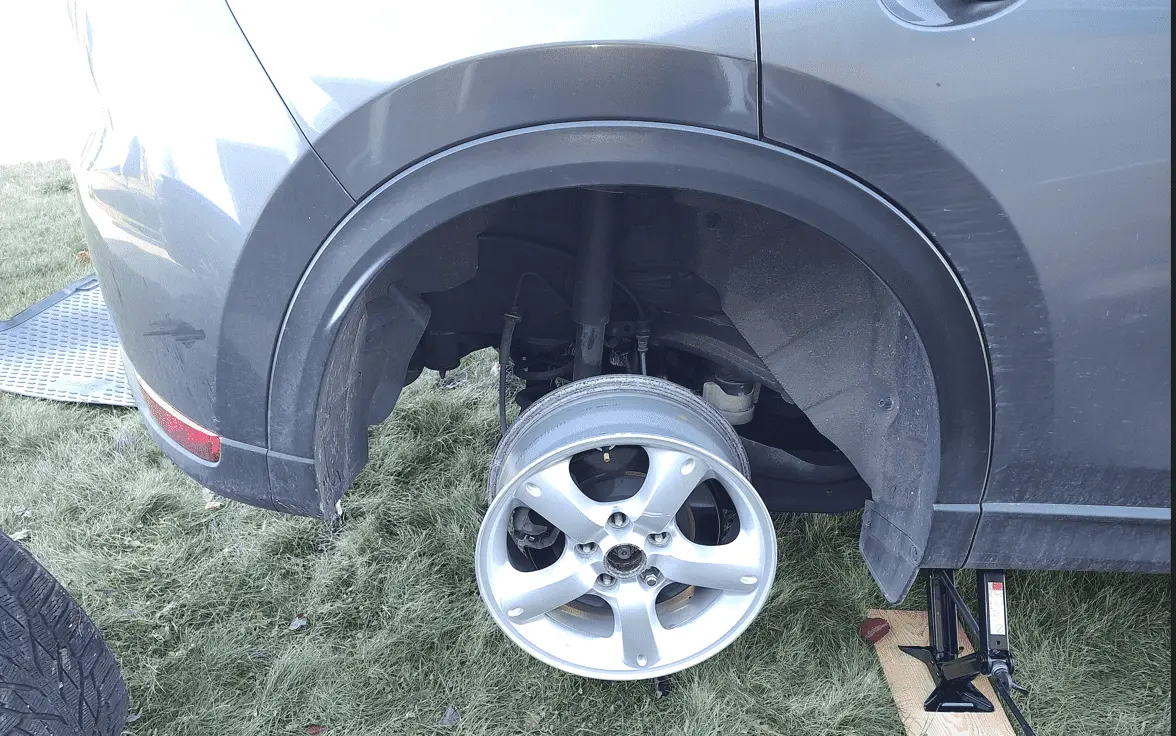

Likewise a picture of the wheel well(if you take the tire/rim off) and how easy it is to see and clip new fender liner... Clipping it should only take a few minutes.
Remove and replace liner should take about an hour.
just make sure you have floor jack under front crossmember and a jackstand(preferably) or your scissor-jack under the pinch-weld. Also shove your tire(with rim under the frame and maybe a wood board or two) so if the car falls, you have 3 points of support.
Its an easy job... you may not want to pay someone to fix it.
If you have three places of support, then if one fails, the other 2 should prevent vehicle from falling on you.
