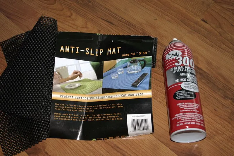

Here's a quick 10-min DIY that adds a liner to the pocket in front of the passenger seat. Doing this virtually eliminates sliding of objects and arguably looks nice as well. A strip of black leather (easily available on ebay) would also work but would not have nearly the non-slip functionality.
attachment.php
Basic materials: anti-slip foam mesh (available locally at many stores), spray adhesive.
Tools: scissors, razor, straight edge

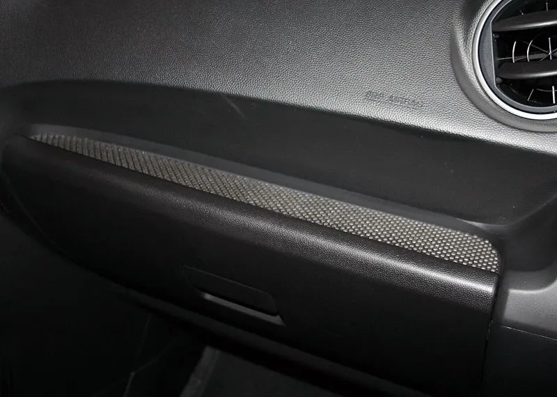

I started by cutting a piece of foam about an inch larger in each direction than needed. I started with the straight back edge, then I cut the curves with a scissors (took a number of trims to get it right). For the front edge, I used a razor and straight edge to get the front of the strip just right. To check the size I had the glovebox open and lined it up with the edge of the shelf.

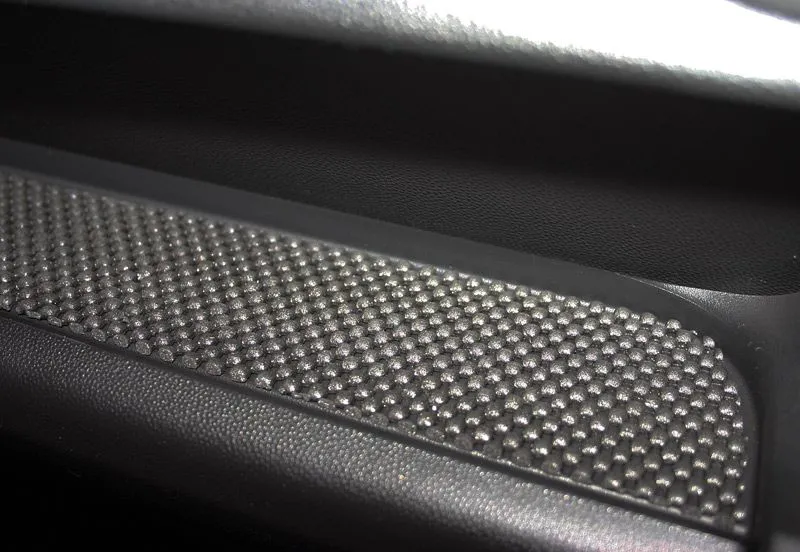

For glueing, I really just wanted to tack it down. Spraying just the piece (outside of the car), I let it dry for a couple minutes and then carefully applied. I don't expect it will come loose, but at the same time if it needs to come out there shouldn't be any difficulty.
I certainly like the functionality, and it turns out I think it looks nice too. There are a few different types of this foam, so shop around and find one you like.
