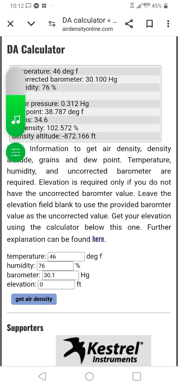

In theory, we should get better FE in colder temps with more available oxygen to burn. The other news, the car accelerated really well and is fun to drive...
Drag racers often use density altitude calculators to predict elaspe time/mph.
Right now thd DA is -870 which is very good. In the summer it's often +2500 and up. At the track we would run at least two tenths of a second faster, -870 vs. +2500. Or the engine is making an extra 80 HP. Back in carburetor days we had to reject the carbs so we didn't melt the pistons and or heads.
Here is a screen shot of our DA a few miles back...

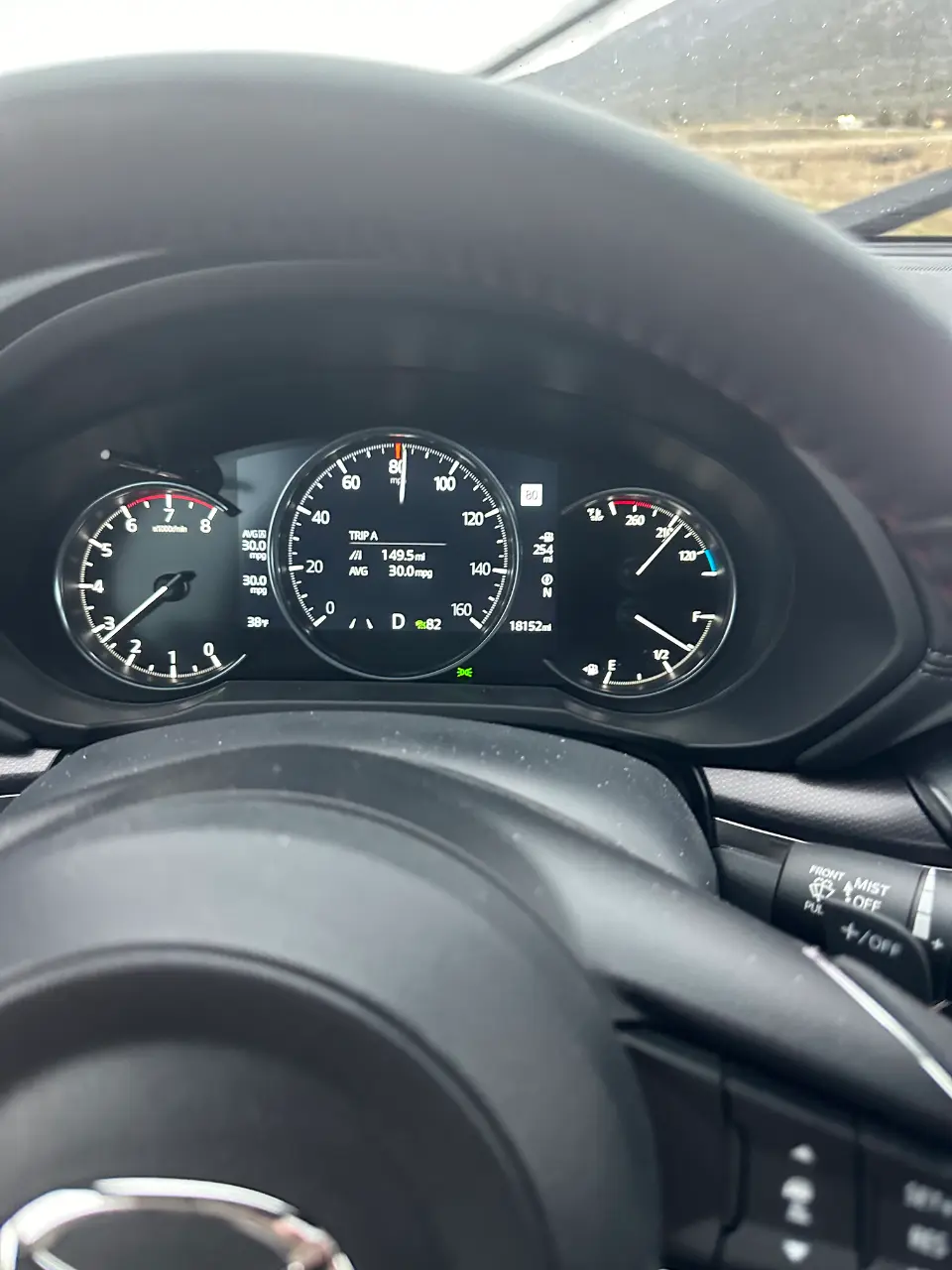

WELL the FE MPG on the Odometer was OFF. I'm somewhat disappointed but not entirely surprised.
The LOM, Lie O Meter, has to calculate mileage across a wide variety of variables. Also my ECU has been tuned. On our diesels we see our LOMs read different when we load different tunes. Even with a Stock tune on the ECU it's off 2 to 3 MPG.
The Mazda's LOM said 30.8 MPG, HAND calculated was 32.2 MPG or 5%. I do not fill after the pump cuts off. This may or may not be the same every time but the best I can do. Each pump may sense "full tank" different and the car may or may not be sitting level. When possible, I fill up at the same pump, in the same direction. It was not possible on this trip.
I may have gotten a tank of WINTER BLEND fuel in SC! If so, that would explain the drop in FE.
I'm burning 93 octane with ethanol. I often wonder how old is the 93 Oct at the stations. Where I buy at home is next to Barbers International Speedway. They sell a lot of 93 Oct to race cars owners This station also sells ethanol FREE 93 Oct. I'll try that in the future...
So the hand calculated average over 416 miles was 33.60 MPG. That is STILL better than we have EVER gotten.
