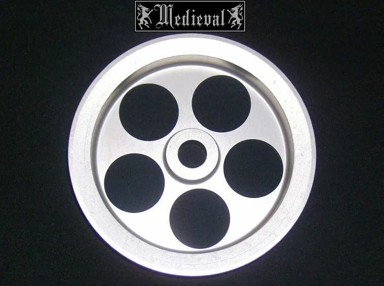

Medieval Protege Pulleys
Protg Alternator Pulley In Stock! Picture of the alt pulley can be seen below on the white shipping box. I will be making another 50 pieces very soon. If you want one of these and missed out, please add yourself to the list.
USA $69 retail

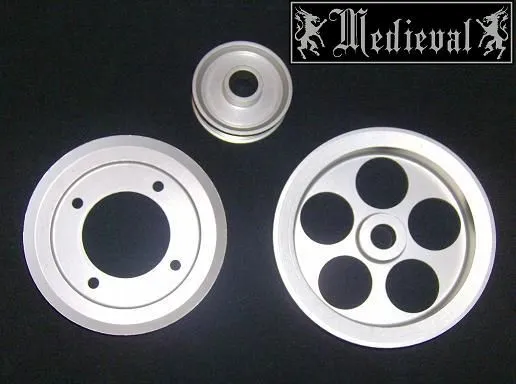

Protege 3pc light weight pulley set. 5-6WHP gain alone (ALT, WP, PS) In Stock
$269 retail
Protege 4pc light weight pulley set. 10-13 WHP gain alone (ALT, WP, PS and Crank pulley) In Stock
$409 retail
