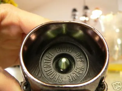

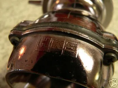

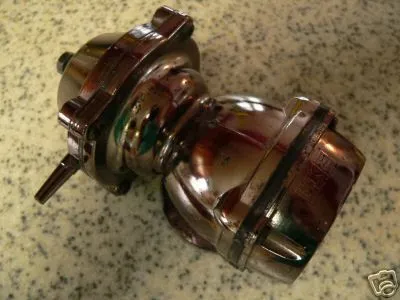

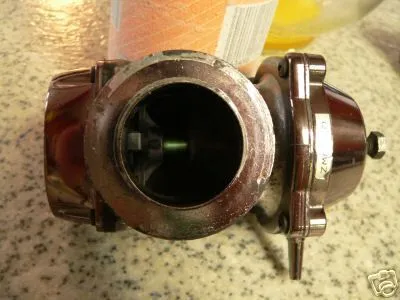

LONG time ago the HKS company revolutionized the turbo industry with the first ever HKS super sequential blow off valve. see pic. below. this valve one a first of it's kind design using a pull style dual functioning valve the worked great flowed great and was almost garanteed never to leak under boost compared to the then and still popular but i believe way out dated push style and plunger style. here's some pics of the very first every HKS SSQ BOV back then they still used the same style flange that is still used today.
