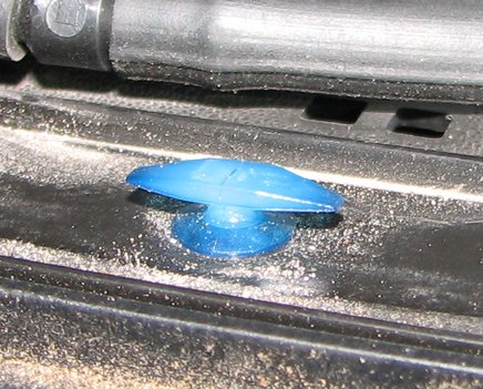

Take the screws out first, then pop the hood. Find the rubber seal (you can't miss it). You'll need to gently pull the seal off a bunch of blue cleats that look like this...
I found stretching the seal to release one side of the cleat then the other worked well.
Be careful, the rubber molding tears pretty easily.

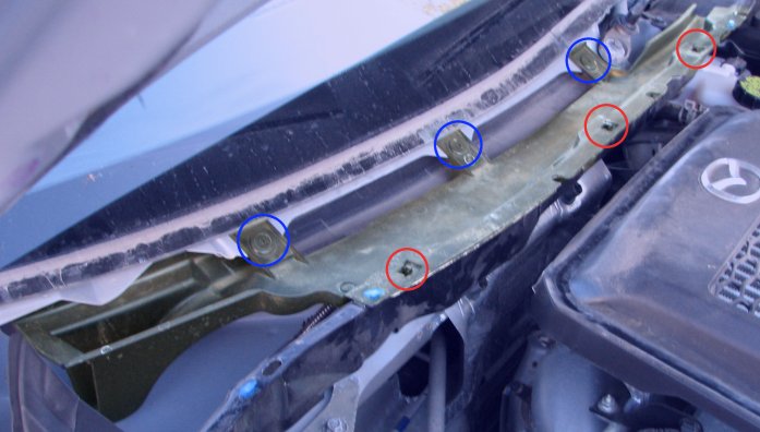

Under the windshield trim there is another plastic thing, I'm going to call this one the "runoff duct". It is held on by 3 round detachable anchors and 3 clips. To get the detachable anchors off you need to unscrew the center part 1/2 turn, pull the center up, then pull the whole anchor out.
Take out the anchors, unhook the clips, then pull out the runoff duct and set it aside.
I was able to just push the backside of the clips (blue outline) and pop them right out, HOWEVER you probably should cup your free hand over them.. I lost one that was a little tight and it went flying.

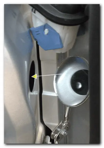

Now thread the wire through the nub thing. I put a little soapy water on the end of the wire to get it started. Pull enough through so the other end will reach the battery.
Some kind of lube is definitely a good idea if the cable is pretty big. I was running 2ga and it was very tight. Depending on the size of your cable, you may want to cut a lot of the nub.
SUGGESTION HERE: It's probably better to push the wire from the engine bay to inside, although inside to engine bay looks easier... The problem with inside to outside is that you may dislodge the grommet from around the white part and it's a Grade A son-of-a-b**** to get back on!! Keep the lube going while you pull/push the cable, it can still slightly dislodge the grommet.

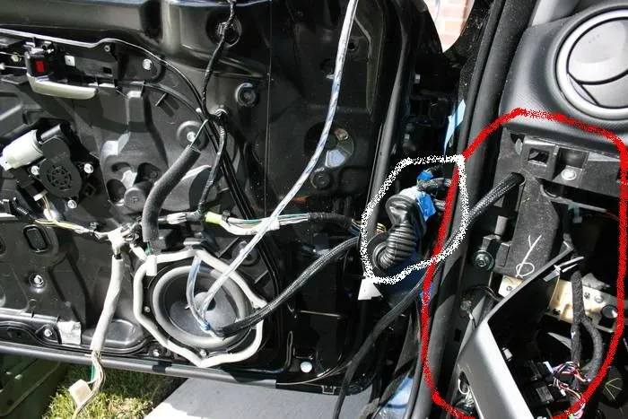

Here's a real noobert question, how do you take off the dash area(circled in red) to get feed wire to the area circled in white?

This is the only post I can find a member explaining how to BREAK-THROUGH to the engine compartment (routing Amplifier power cable). Thumbs up Hirudin! Is there anyone else who has routed a Amplifier Power cable in a different location?
I was wondering the same thing. Seems like a lot of wire, no one found a place to route through the drivers side instead?
It took a long-ass time, and I cussed that damn windshield cowl for all it was worth, but I got my amp wire run today! Thanks for the write-up!
I just wired my amp behind the glovebox, but instead of cutting the grommet, I made a small cut in the rubber thingy where the huge group of other wires go through (below the grommet). Is there any reason more people dont do this? Should i rewire it through the grommet and use some silicone to close my cut?
