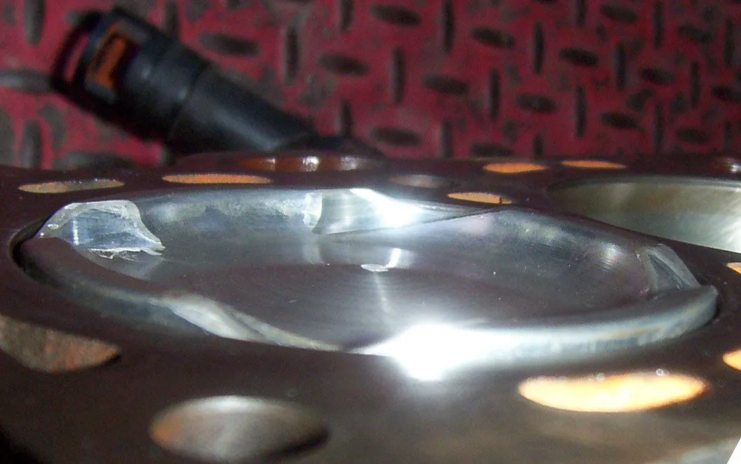

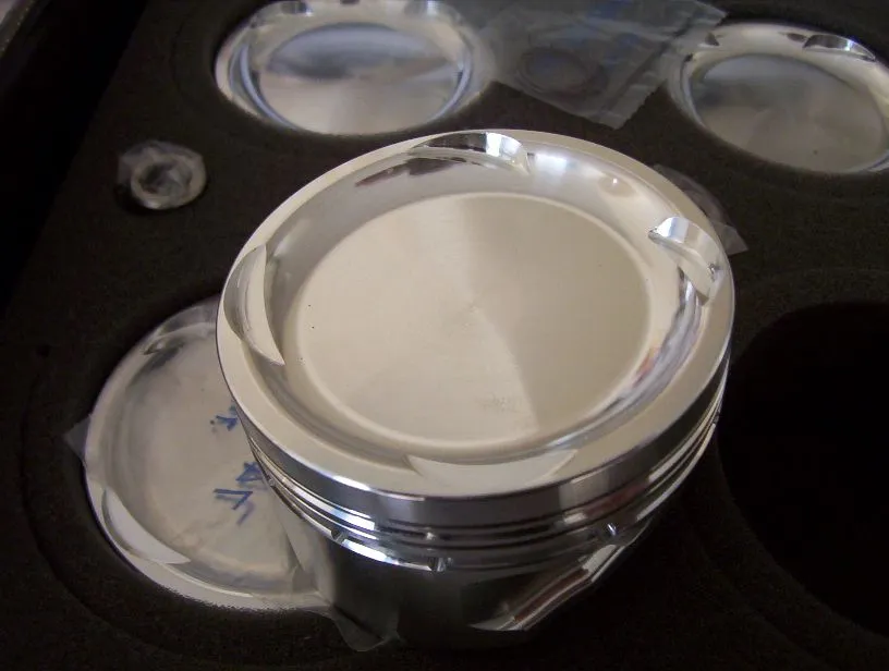

Proyect on HALT: Either pistons or rods are incorrect. Check last pic in this first post.

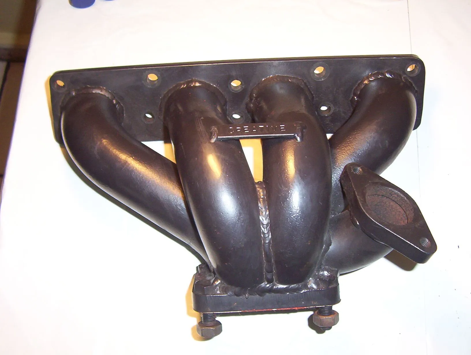

Manifold: Creative Performance Race tubular manifold

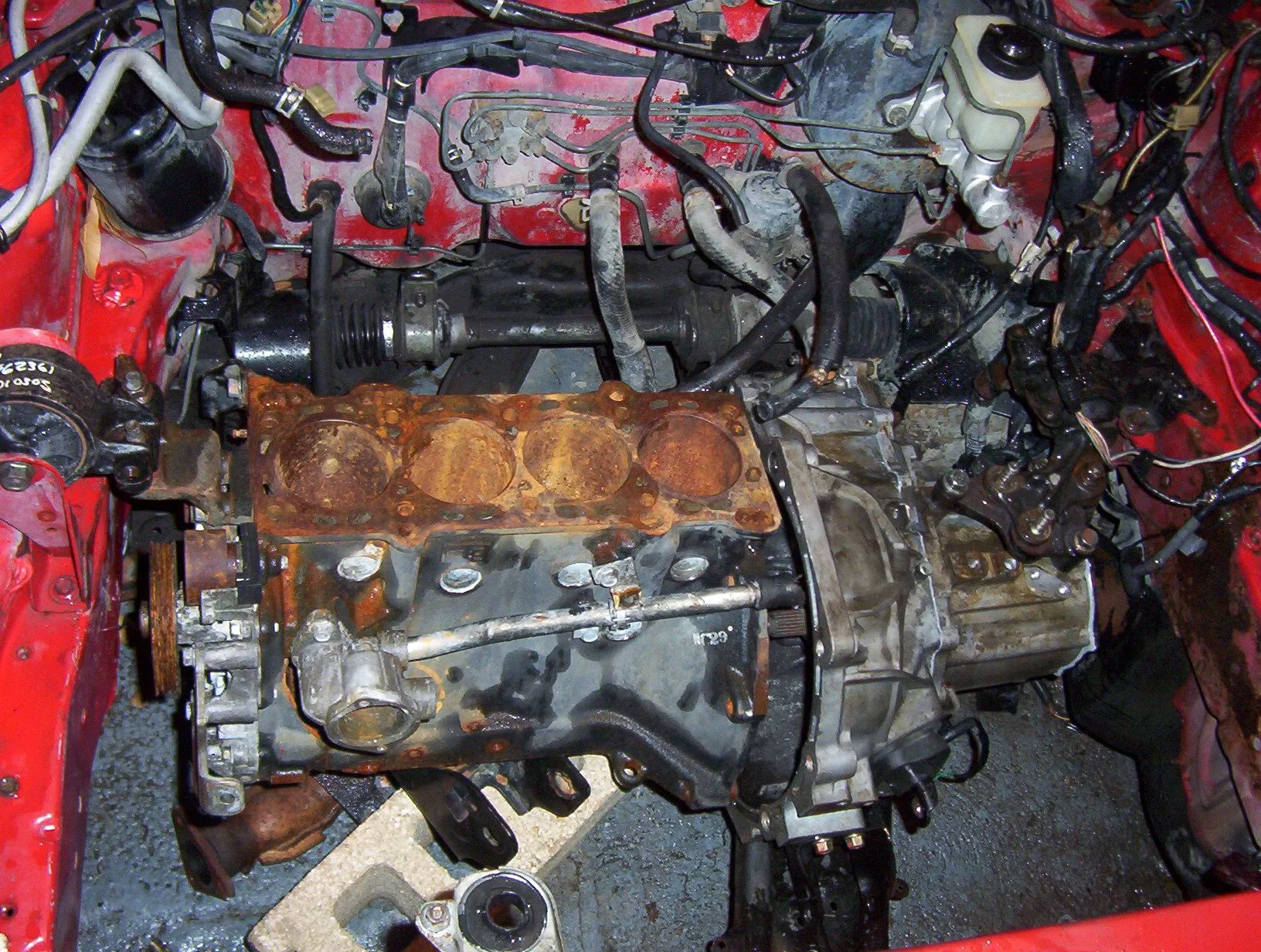

So far the troubles I have found are engine mounts. I will try use stock 323/kia/protege mounts and support, I want to avoid at all cost any welding. Will see how the axles fit and make necesary modifications.

I. Motor Mounts
1. Front: Stock 323/Protege works fine on the transmission.
2. Rear: Stock 323/Protege will also need the trans support to attach to it.
3. Pass side: So far, stock 323/Protege works, needs som cutting or shaving on the small thingy on the side of the engine side support.
4. Trans side: Stock Protege/Kia used. fits perfect.
II. Transmission Arms
1. Stock 323 are fitting just fine. Will soon test P5 arms, the ones I have from the 323 are old and bushings are bad.

Yeah, the manifold im using is from the 9sec 600+whp FSDE 323 from Creative Performance here in PR. Their setup now is the sickest Ive ever seen, hes now shooting for 800+whp and auto transmission.

Today was a good day. Fitment of the engine is almost perfect. Im still missing the front motor mount, but the rest fit fine!!! The shifter poles fit perfect.
Im using a blown motor I have around, and still heavy (while I build the good one). All done by hand, no tools at all.
will be updating first post with pics...
