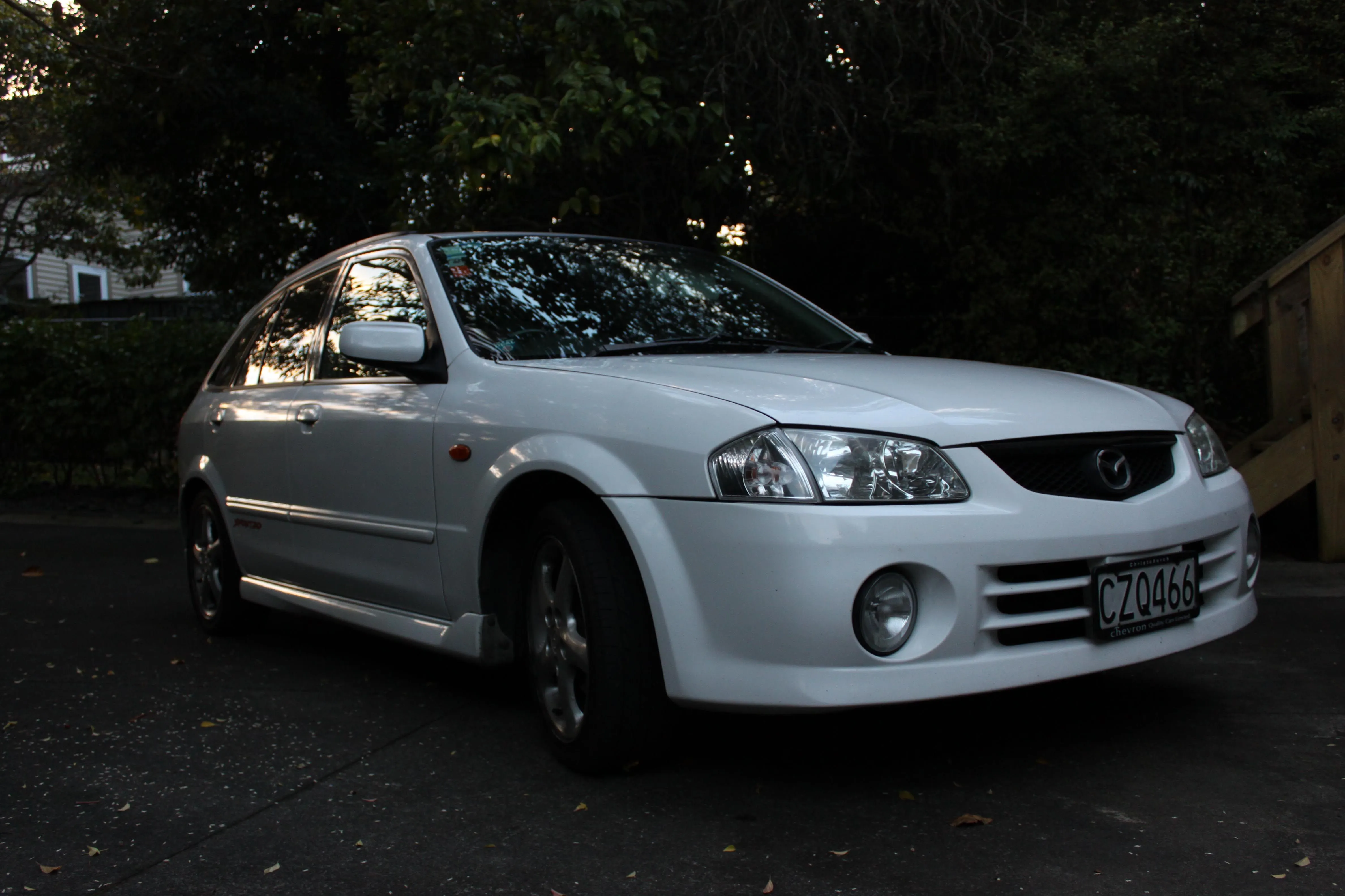

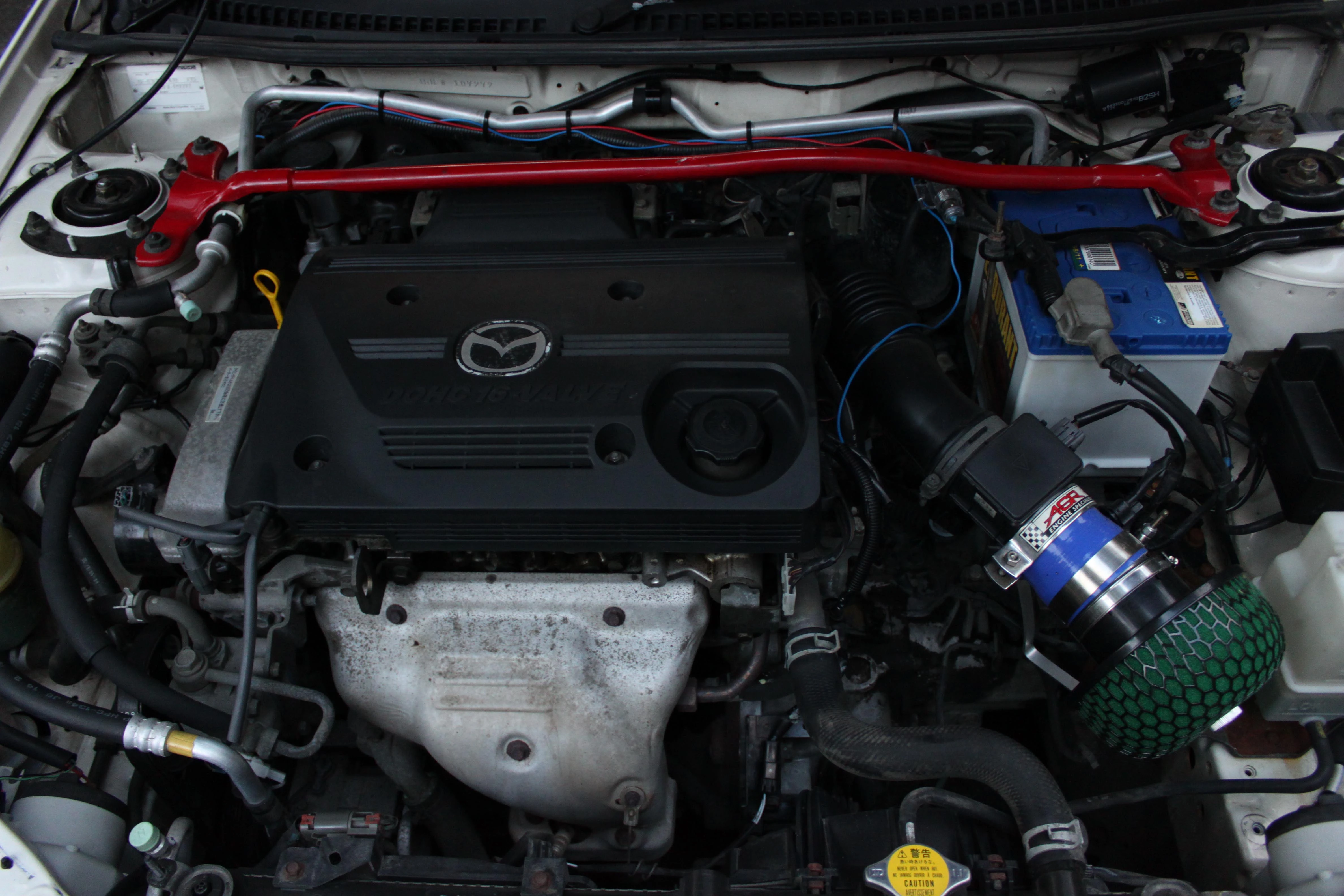

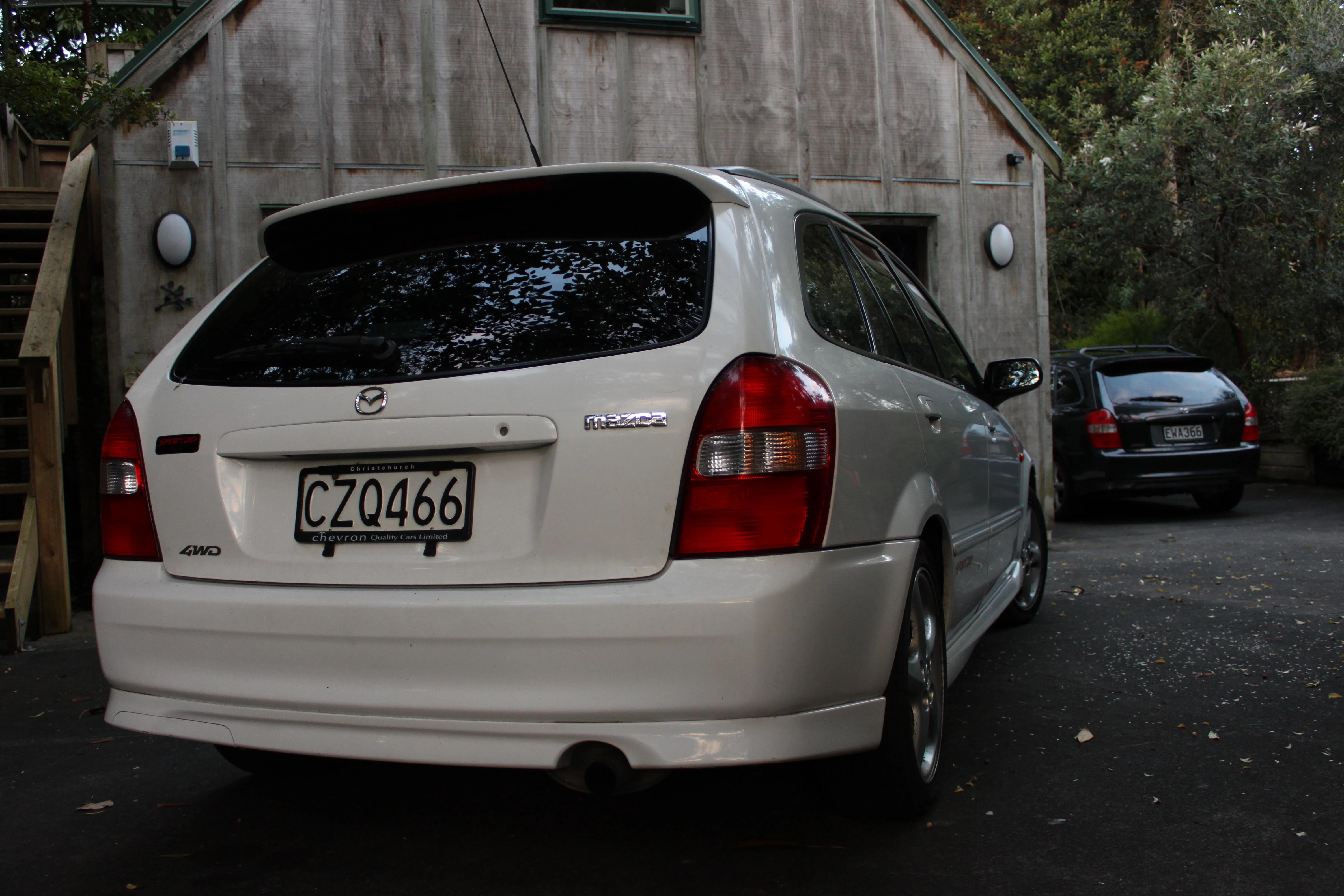

Thanks alot for your help, i will get some photos up for you now.
