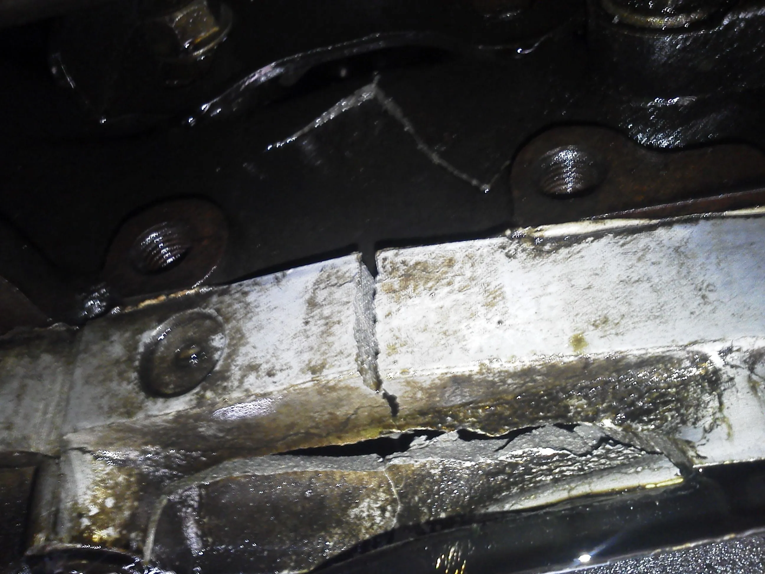

Whats up guys. I blew my one of my rods right through the bottom of the pan, and just my luck... it took the main bearing support plate with it. :( I just bought a 2001 626 FS-DE engine, and I was wondering what all needs to be done with it to make it compatible with my 03.5 msp? I know I am going to need to a drain line inlet on the oil pan for the turbo, and that usually requires a new windage plate, or a new mbsp. I need to know if anyone has one with a inlet for the the drain line, or if anyone has any good instructions on how to tap into the oil pan to put the drain inlet on the oil pan. Or does anyone know where to take the engine to get one fabricated
onto the engine. Please let me know what ya'll think. Thanks! :)
Oh and this is what this side of the block and the mbsp looked like afterwards :(
<a href="http://s978.photobucket.com/albums/ae267/dcdirtrider/?action=view&current=IMG_20120201_145131.jpg" target="_blank"><img src="http://i978.photobucket.com/albums/ae267/dcdirtrider/IMG_20120201_145131.jpg" border="0" alt="Photobucket"></a>
