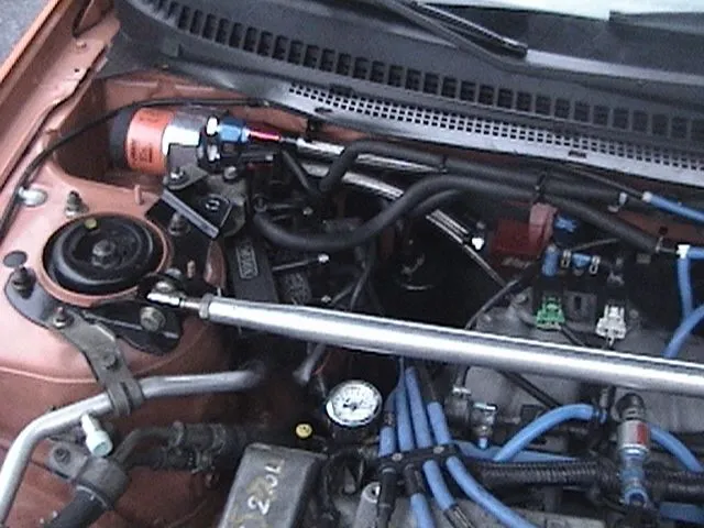

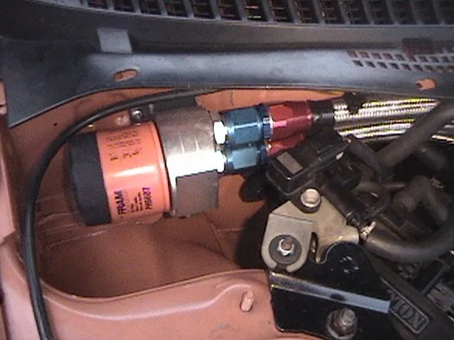

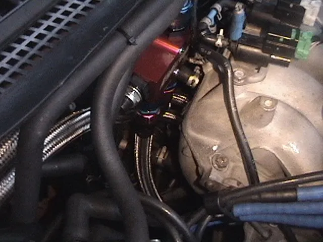

Here You Go Best I have. Sorry about crappy looking valve cover waiting for someone to send me one. Hint Hint

That looks pretty good. Seriously making me consider this in the long run. Doesn't look like it would be all too hard to tap the filter adaptor for pressure and temperature senders either.
Found it on Ebay Billet Aluiminum good quality you should get a package deal working on this setup with filter relocation setup and PRV and pump work and I know you can do it because after motor start up I thought pump was leaking so I removed oil pump with motor in place No motor mount removal or loosing at all, not easy but can be done and BTW it was camshaft seal leaking. Timing belt job twice really but only changed belt once after I found it soaked with oil from the cam seal leak.
