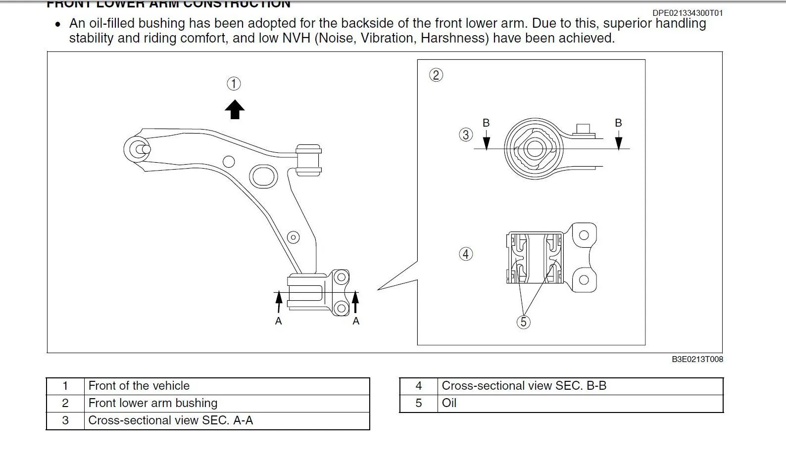

I just noticed that my front right control arm had oil under the big bushing. I have 50k miles on my Mazda5. Is this a common failure, or am I just unlucky? It looks pretty easy to replace the control arm. Any hints?
The control arms don't have sealed, lubed parts. Bushings don't "leak". Assuming it is a suspension part that has leaked, it will either be the CV joint boots on either end of the half axles, or the tie rod ends. Personally, I cannot imagine thick gear lube-grade lubricants pooling to indicate a leak, which is what it sounds like you're describing.
I would first guess that an oil change pooled oil on the control arm and it's dripping. If that's ruled out, I'd look at the differential where the axles join the transmission for leaks. If those aren't the problem come back with more details and let's dig deeper.
Well, I thought it was oil filled based on the factory manual that is floating around the net. See attached picture.

Oh wow, I stand corrected. I've never seen one like that before. I would hope that such a relatively sophisticated bushing could be replaced fairly easily in the event of failure.
