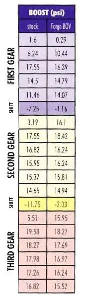

Here's a chart, I guess everyone has seen by now, where Grassroots Motorsports compared the performance of the stock BPV and the Forge BPV on an MS3. Forge did not "hold boost better."
With the particular adjustments on the Forge for that test, they were able to demonstrate that boost would recover quicker right after a slow granny shift (more lively in language of OP) with the Forge, but when you look closely at the chart, once the ECU allows full power (which does not happen until third gear), the stock BPV held boost better and at higher levels than the Forge. Fact.
And who can use full power in first or second gear anyway? Full throttle just breaks 'em loose for me in both gears. It's third gear and up that you really see whether performance gains are meaningful.
Since I flat shift in competition at 5,500 rpm, there is no manifold vacuum during that kind of shift and no loss in "lively." Yet I get the benefit of the higher boost level of the stock BPV. When I'm driving around town and shifting slowly, I really don't want to be perceived by the general public as giving them armpit farts. But Ii recognize that there are those here who enjoy that experience.
So, I think OP is right about the "lively" provided he is talking about lift throttle granny shifting, and that he is also right in calling out the unnatural sounds produced by this valve.
I agree that we should mod for whatever reasons we like, including sound, but let's be realistic about whether there is any true performance reason to criticize the stock valve.

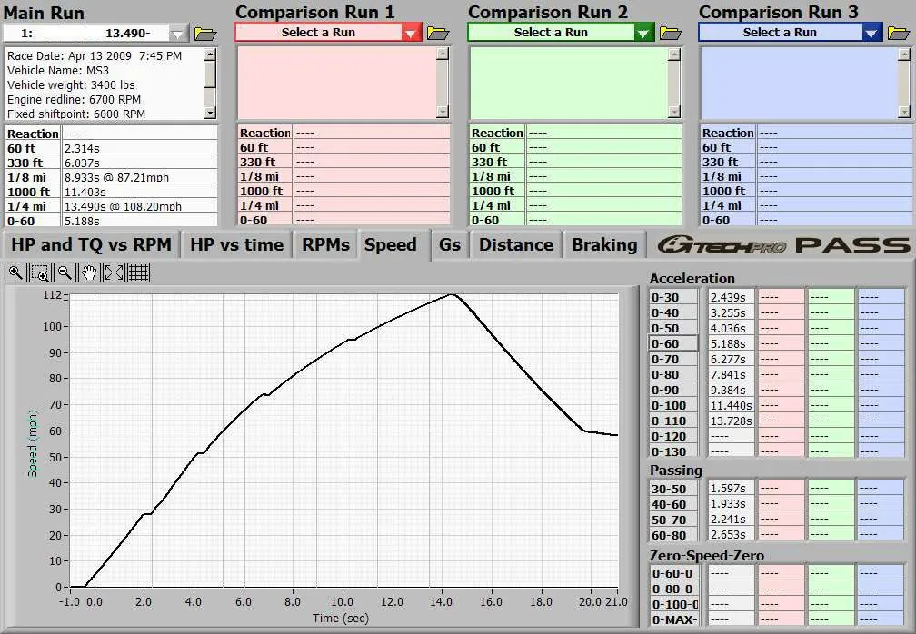

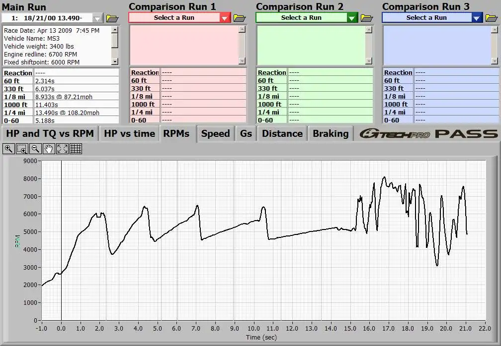

Here's an example perhaps a bit better than butt dyno of performance with the flat shift with the stock valve and simiple mods listed in sig:
Charts were generated by use of a G-Tech Pro accelerometer and confirmed by a recent video of a timed 40-120 run. Get out your stop watch for if you want something a little better than a butt dyno. And then tell me if the stock BPV is lively enough for you.
Just trying to bring a little objective evidence-based science to the discussion.
http://www.youtube.com/watch?v=pRY2wCDcfWA
The video'd run might have been quicker but for the traction loss (even with DSC ON) in second gear and part way through third (time for new tires).
