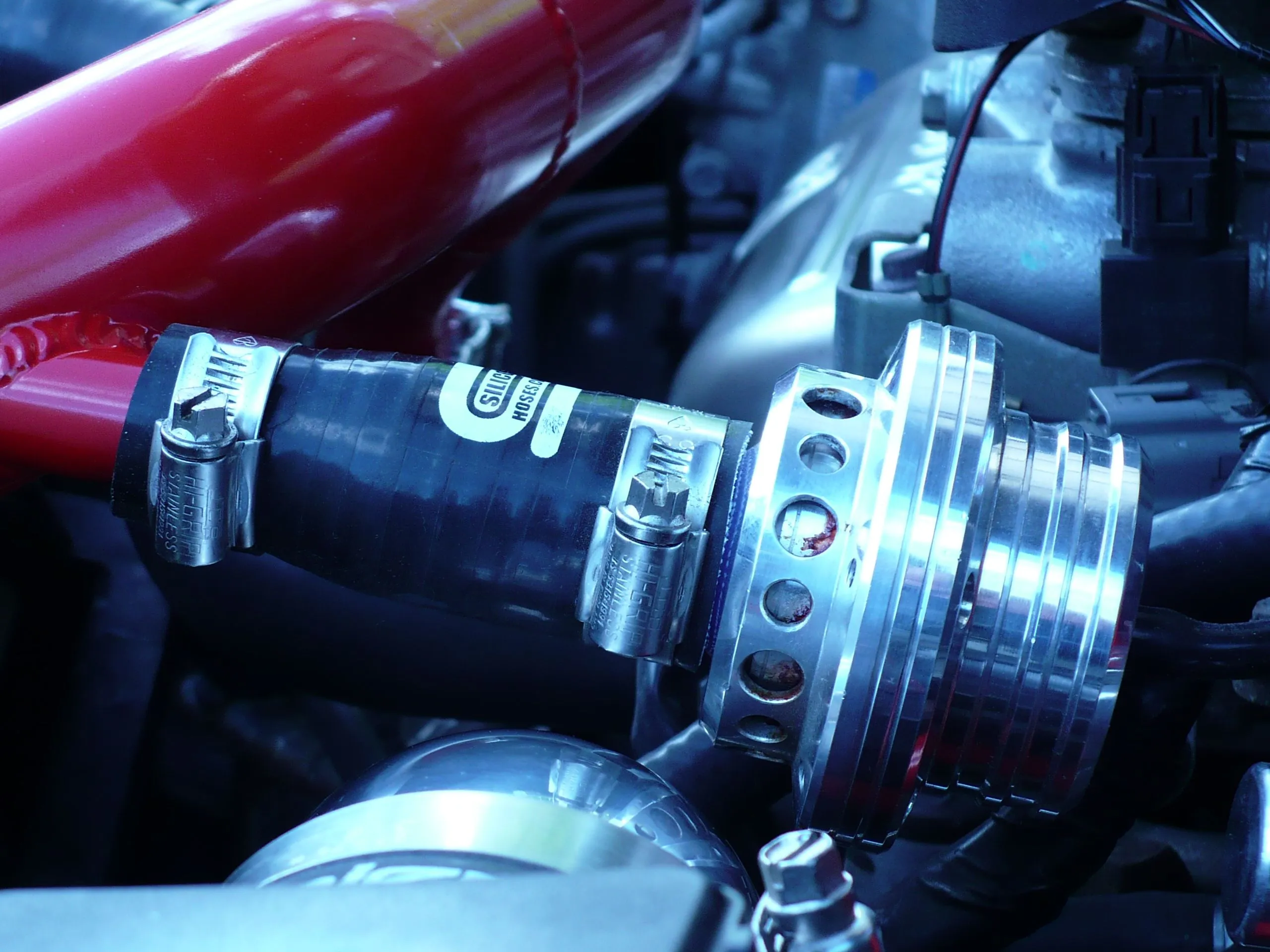

I think its pretty straightforward but I want to hear from those who have the forge BOV installed, besides putting the bov where the bpv was, where does the silicone line go to?
from the hot pipe hope the pic helps......i cut the silicone piping down on mine
do you have the pic of the silicone line runnin into the top of the bov? what line is that? where is it located?
You should use the same line that the factory valve uses.
that is my problem, I have an aftermarket short ram intake and i forgot where the factory line went. right now i have Silicone line-Bypass valve-silicone line-"u" shaped metal pipe- silicone line-metal intake tube for short ram
ok, now since this is a direct replacement for the factory bpv will i stall if i am not running the dual setup or the maf relocate? if it is setup to recirculate like the bpv but get rid of the excess air do i still need to worry about maf location?
