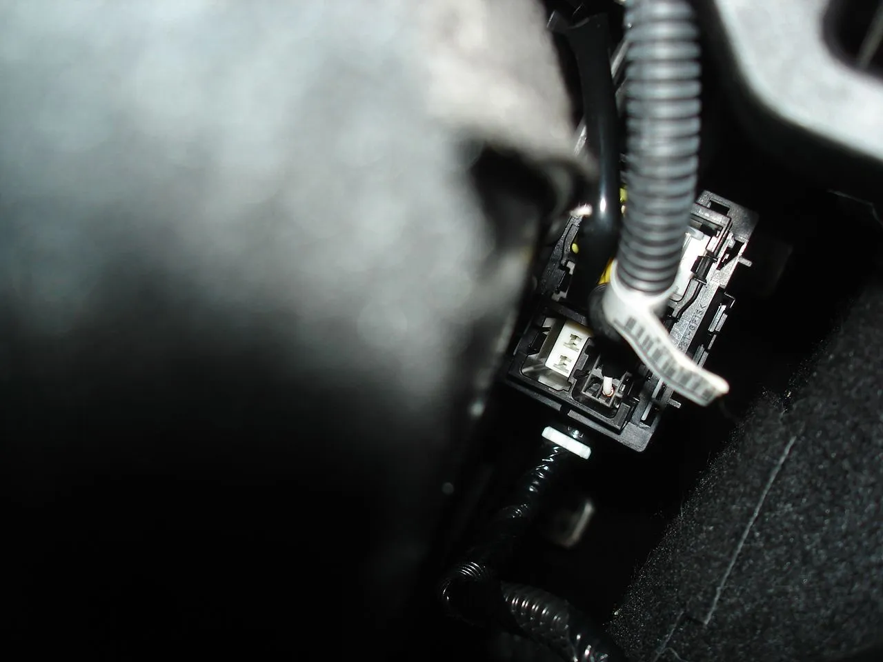

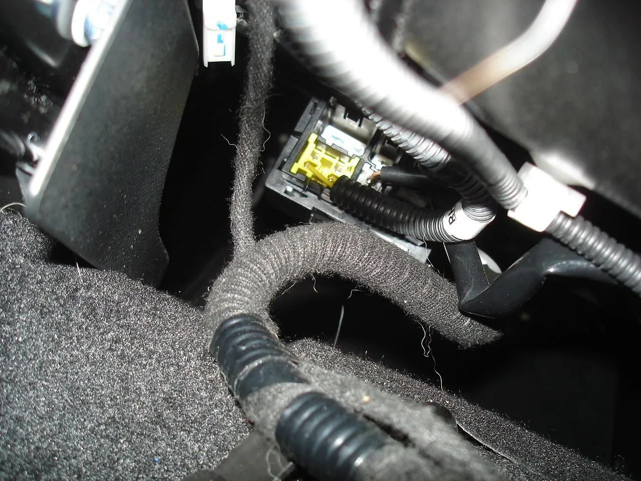

1st pic is under the drivers seat from behind, 2nd pic is passenger seat from behind. I wish I could get better pics but I couldn't get the connector loose from the seat to get it lower to take better pic's.

Thanks, Real Deal, that does help, now if I could get u to do the other seat, I'll be perfect. In the pic its hard to see but on my drivers seat I have three plugs coming out of bottom of it. on the box in the pic it looks like _-- those have plugs in em. That wire in the door, I'm forgetting about(Everything in Door panel works windows, locks, morrors??, I wired new tweets so it wasn't for them, my only guess is heated mirrors???
if _-- didn't make sense, all the top row would be --- from the perspective of your picture, im just making this more confusing..LOL
Thanks again for your help.
Updated the pics in the original reply, it's just hard to get them with the seat in place. The driver's side is like this (where _ is empty & - is populated):
top _--
btm -__
Thanks again RealDefman, it will help allot. Been crazy rain all day, didn't get to put em in yet though, ill let you know how it goes. I'm also gonna do a write-up on my install.
