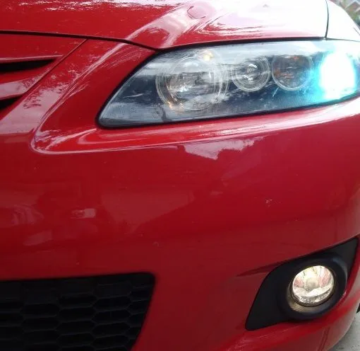

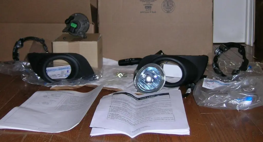

After buying the stupid cheap JDM kit from E-bay and getting burned. I decided to create my own Custom kit (all US 06-08's only) with all OEM parts using the prewiring etc. Install only takes 45 minutes and it is all OEM. including the replacement light switch.
If someone sells you a kit with wiring and togle switch it most likely will not work.

Sorry, posted Pic in response to your request, btw here are the part #'s you need to use the prewire. Can be ordered from any dealer, AMM status requested but haven't gotten an e-mail back
GJ6H-66-122 - LEVER,LIGHT SWITCH WITH FOG 1
LE46-51-680 - LAMP 1
LE46-51-690 - LAMP(L) 1
GP7A-51-684B - BRACKET Right 1
GP7A-51-688A - CORD,FRONT Right 1
GP7A-51-694B - BRACKET Left 1
GP7B-50-C21B - Front bumper cover left 1
GP7B-50-C11B - Front bumper cover right 1
99865 0516 - Self Tapping Screws 6
G22E 51 6H9 - Screws 2
G22E 51 695 - Screws 2

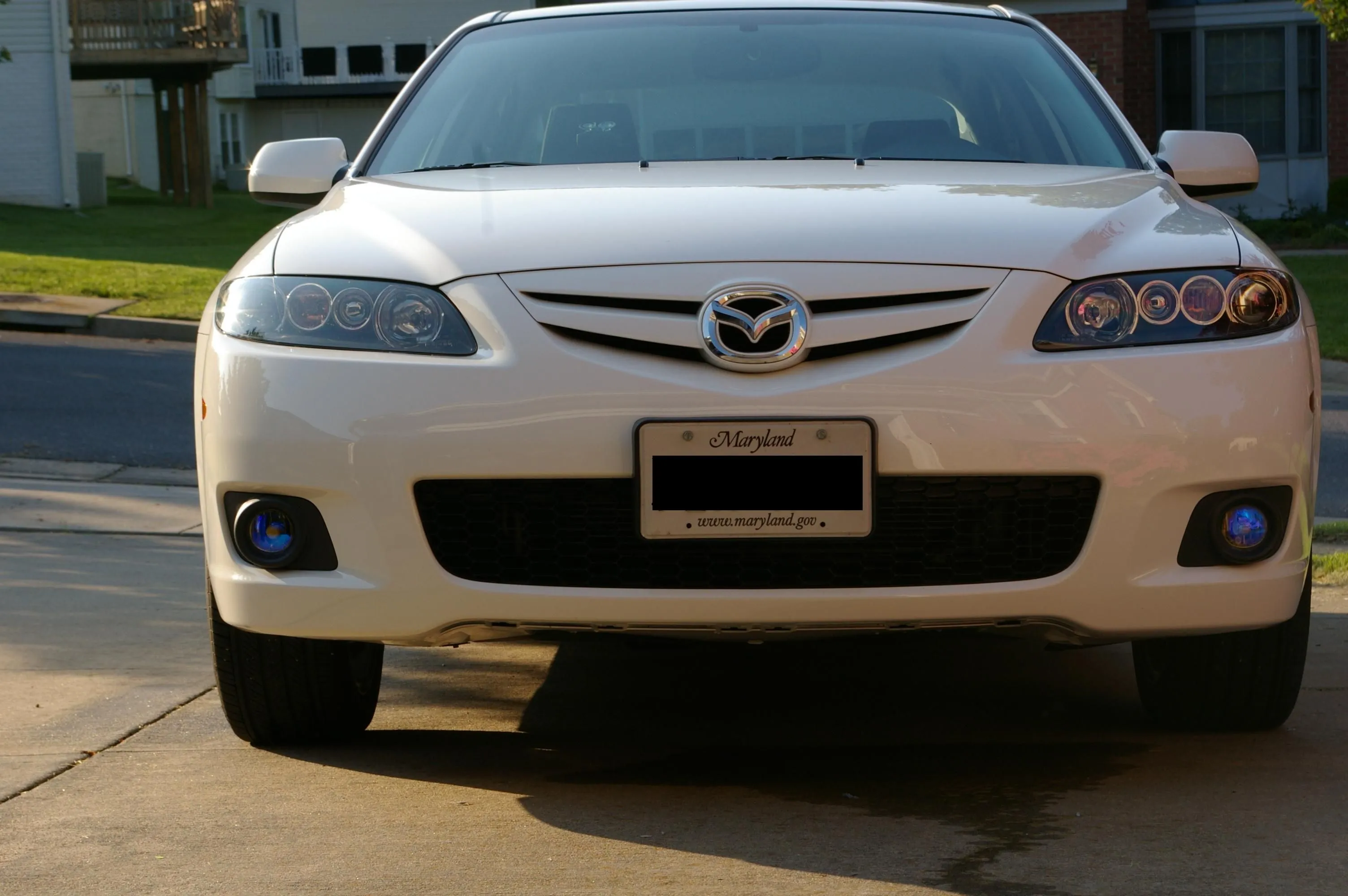

It does help in the fog and snow, some people mod it to make them DRL's. Somewhere there is a write-up on how to do this. Since the lenses are glass they can be easily upgraded to HID's that are H11 compatible.
In addition it looks better on the car. The Mazda 6 GT and MS6 both did come with them from the factory. The base, VE and Touring just have the black blanks, but are prewired and even have the relay installed. On the driver side the wiring is actually attached to the black insert. Installation does require the removal of the bumper skin. Since you have the Perfomance White here they are installed on my own Performance White.
