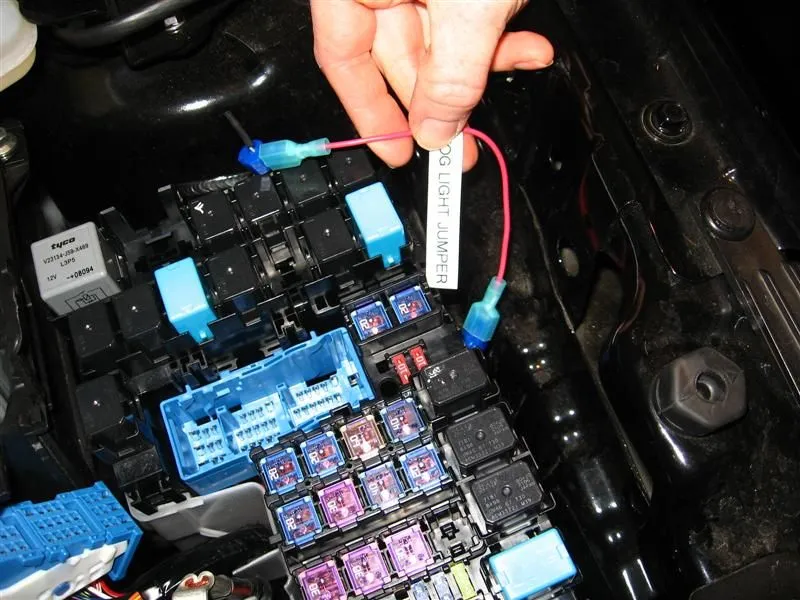

We just finished modification on our M5 GT!
It was quite annoying from the factory, but these forums sure helped.(dance)
...and test for the wire that gets power when the headlights are turned on. Mine was Grey with Blue stripe. When you find the correct wire, mark it. Now to the taillight relay. Test for the wire that gives power out to the taillights when the switch is turned on. Mine was Grey with Black stripe. Now cut the grey/blue wire about 2 inches from the foglight relay.
Our 2008 Mazda5 GT had the exact wiring & coloring as described above.
A few wire taps and heat shrink and we were in business.
michael.

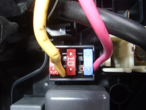

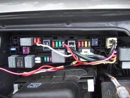

I did not take pictures of the ground yet but GROUND THE MODULE FIRST!!! There is a ground connection on the strut tower.
Fusebox overview...
12V power supply - Red wire (please refer to your module's instruction manual.
Image removed
Yellow wire - high beam light connection and Pink wire - ignition sensing connection which I connected to EFI because it's the only fuse that is only active when ignition is turned on. The yellow wire provides DRL power from the power supply to the high beams. (ditto)
Finally the white wire - low beam sensing connection ... Basically when it senses the low beams have turned on, the DRLs will turn off.
Image removed
Take out the appropriate fuse, wrap the wire around, and connect it to the DRL module. Connect on the side as per my photos because they are the protected size. I've been running this for almost a week with no issues of blown fuses so it's definitely safe.
End result:
