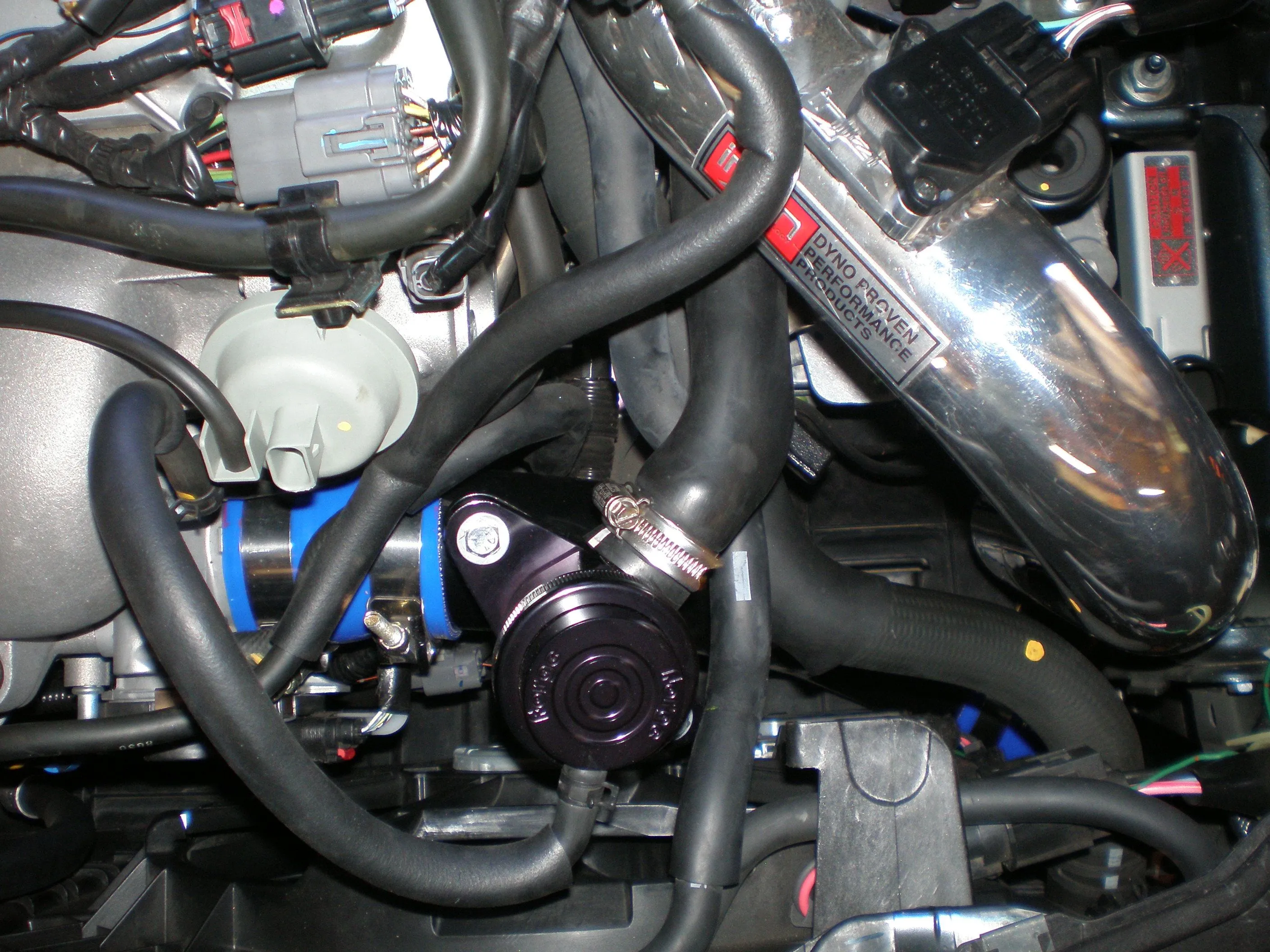

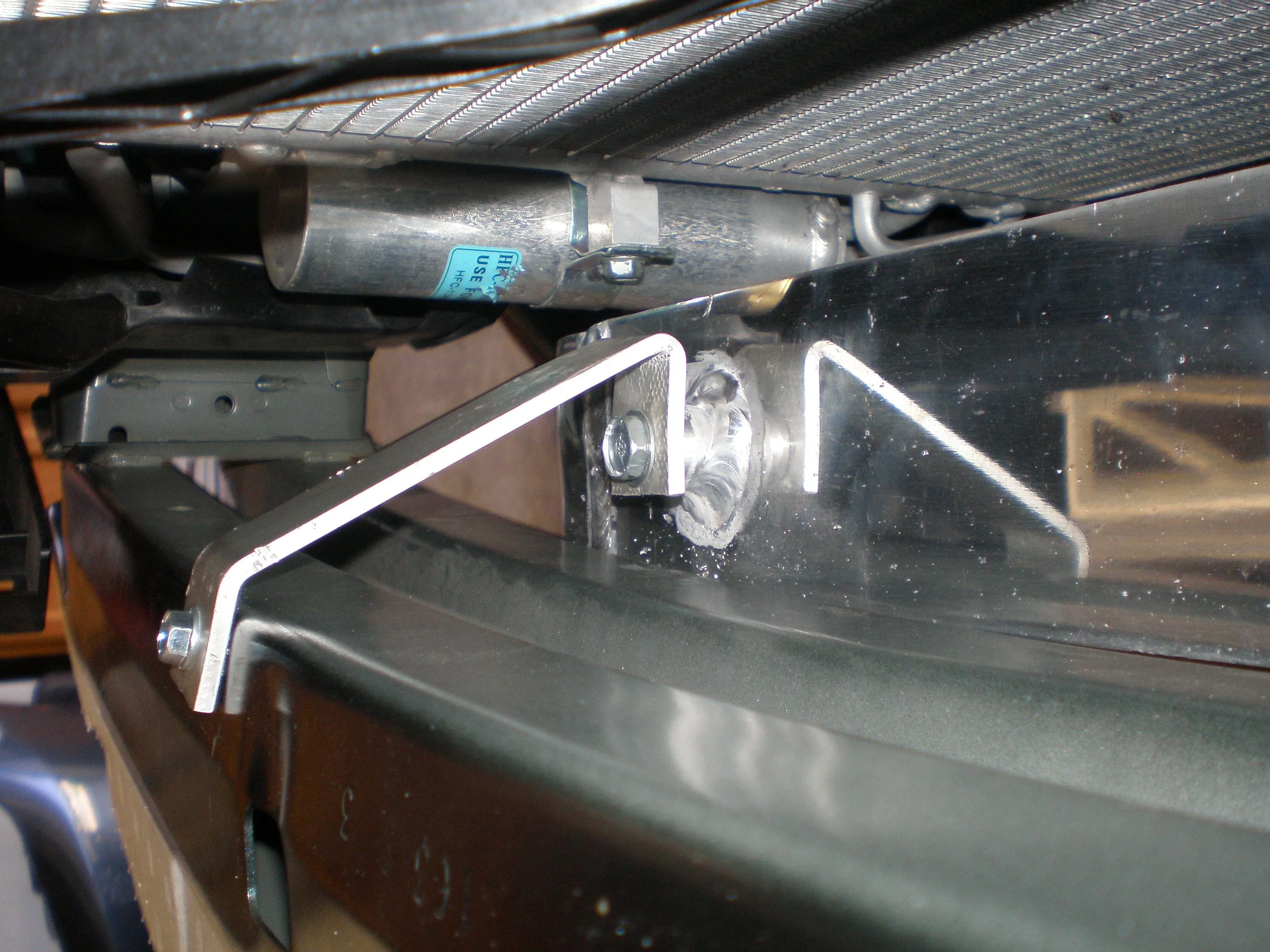

Blow off valve Flange pics for fmic
Sorry i couldn't take more pics, my camera battery went out. This is the flange that i will be mounting my bov to. I thought the kit would be here this week but do to the holiday i will have to wait to next week. But here are the pics.
Hope u guys like these i will try to take more once everything is done but the project has started, I will keep u guys posted.(thumb)
i had a friend buy a JDM sport universal FMIC kit on ebay for his MSP...those polished pipes looked great nuthing like the pics above
The reason the pipe in the pics looks different is because that pipe is not part of the kit that is coming from ebay, the ebay pipe brings a greddy type s/rs flange which will not fit with the turboxs bov i have, so instead of spending another 250-300 for another valve to fit that flange, I went and got the flange and a piece of 2.5 aluminum pipe that will fit with my valve. Once the whole kit gets here i will be cutting the piece of the pipe that has the greddy valve flange and replace it with the one in the pic. But that pipe has not been polished yet, once its polished it will look just like the one that comes with the kit. And yes i did try to find an adapter so i would not have to do this but no one makes the adapter of the stock flange for the ms3, I got lucky cause epic gave me one off the kits they had and I paid a total of 58.00.

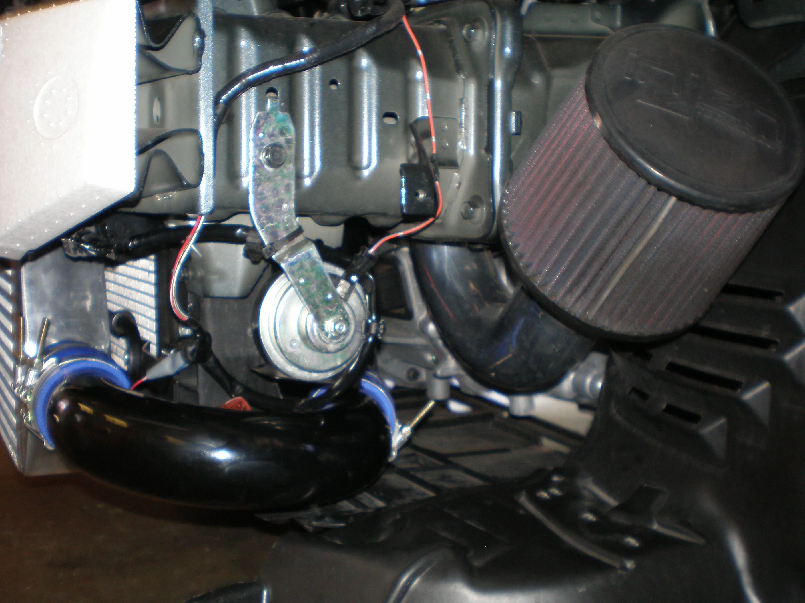

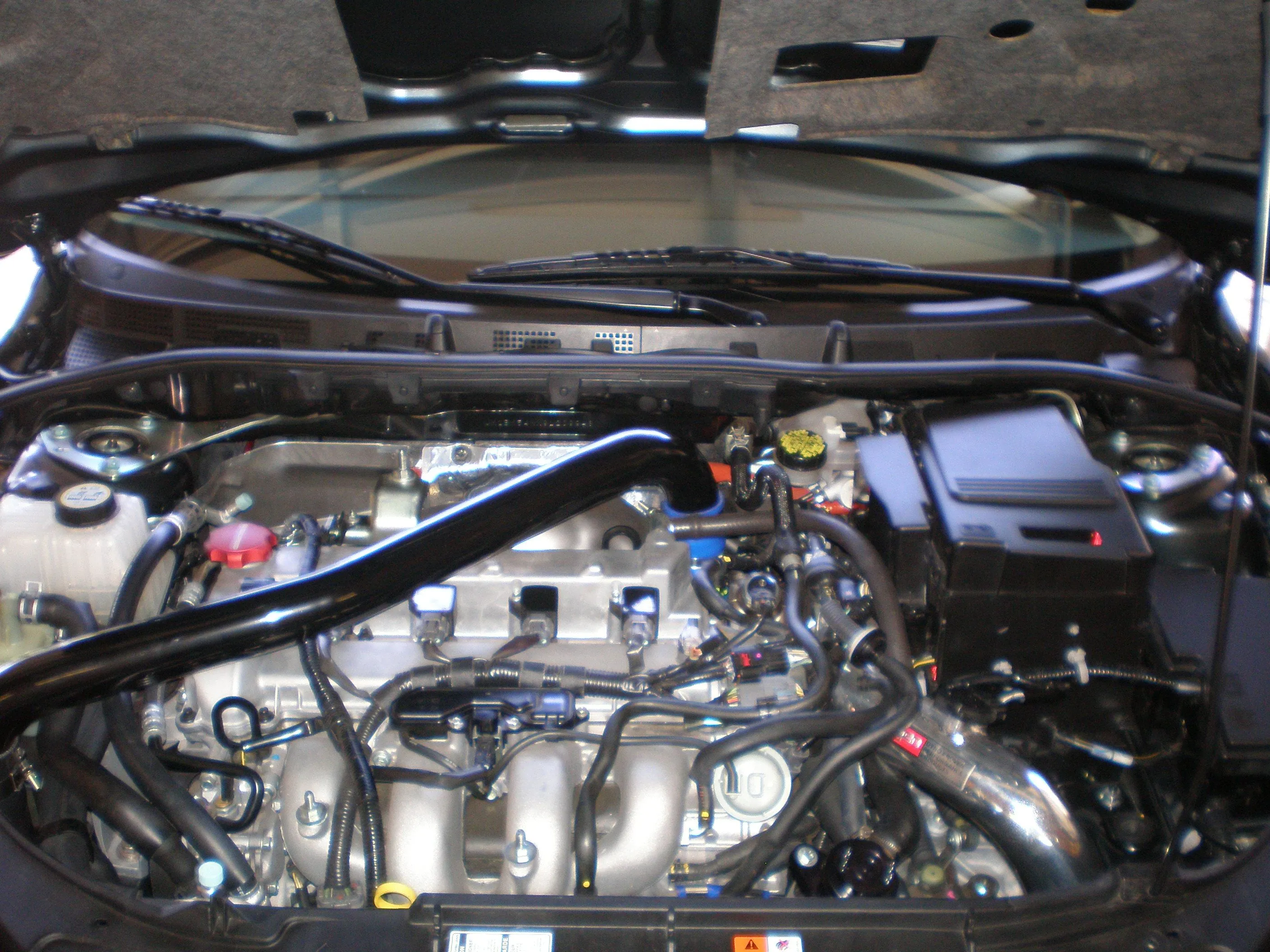

i got my exhaust depot pipes the other day. i did the install, came out good. i just have these pics right now but im planning on taking better ones tomorrow if i have some free time. pipes came powbercoated black, they looked awesome.
Good stuff, turbos3. Did you have to pay extra for the powder coating, or that's the way the sell it?

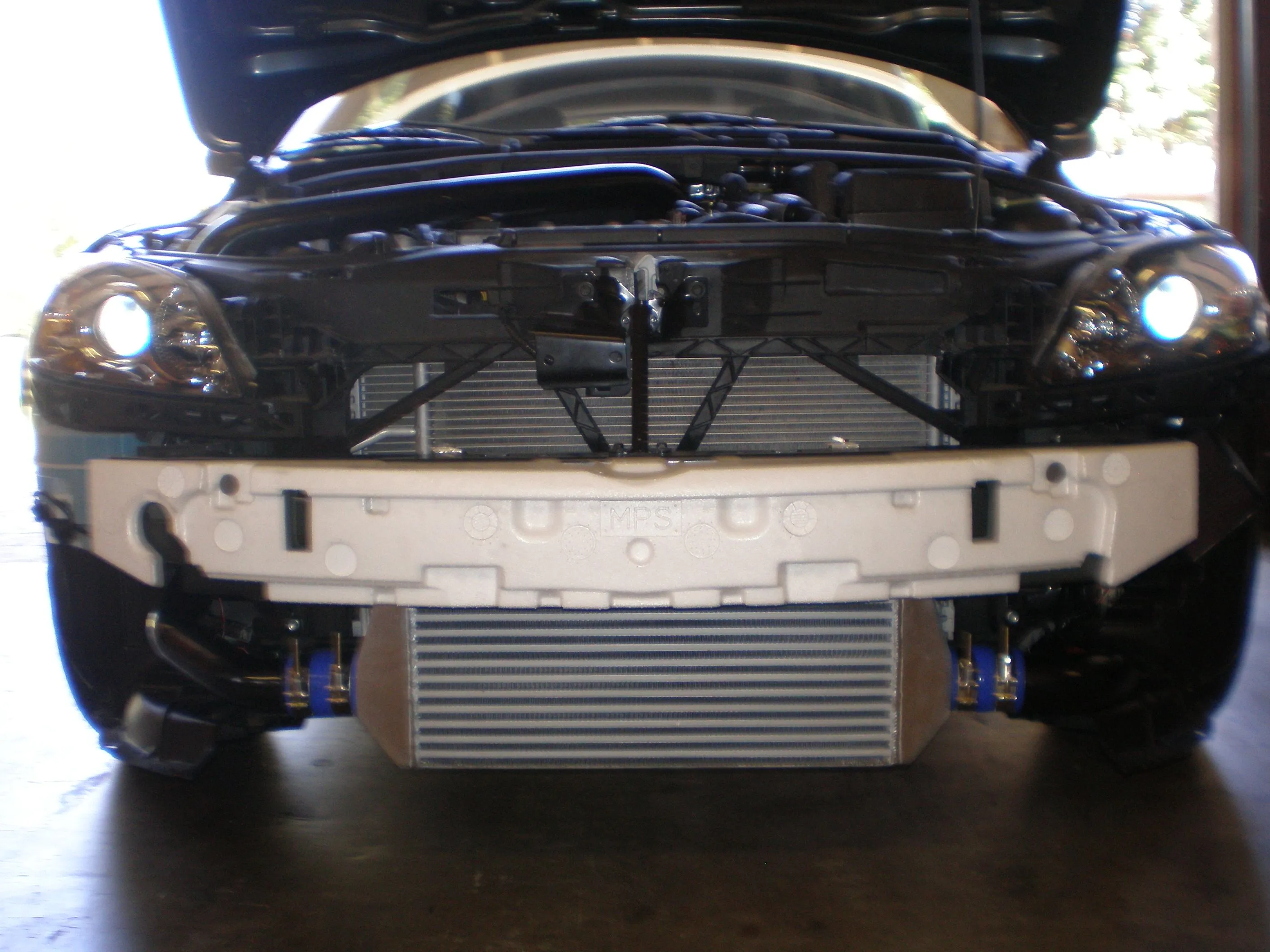

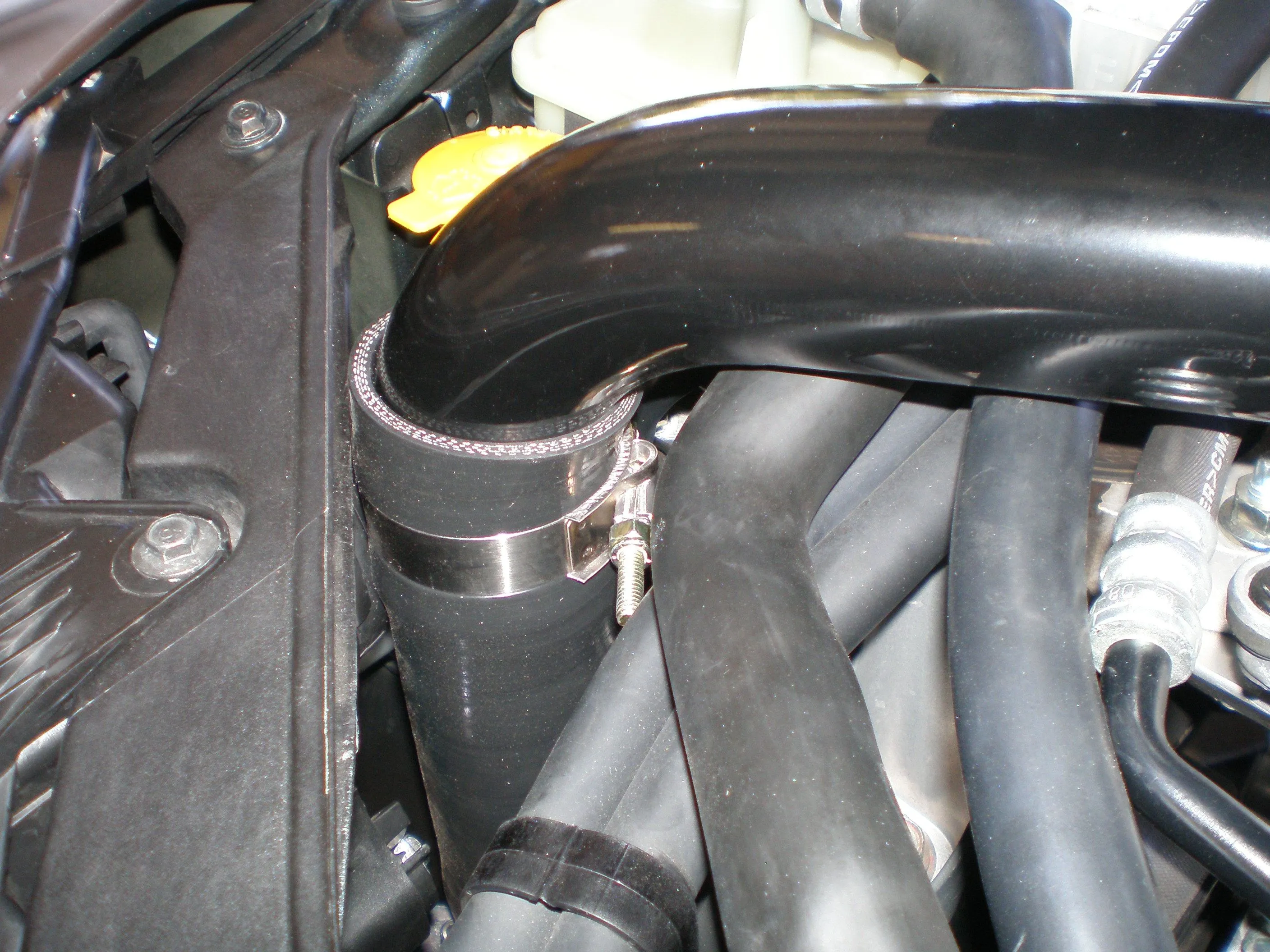

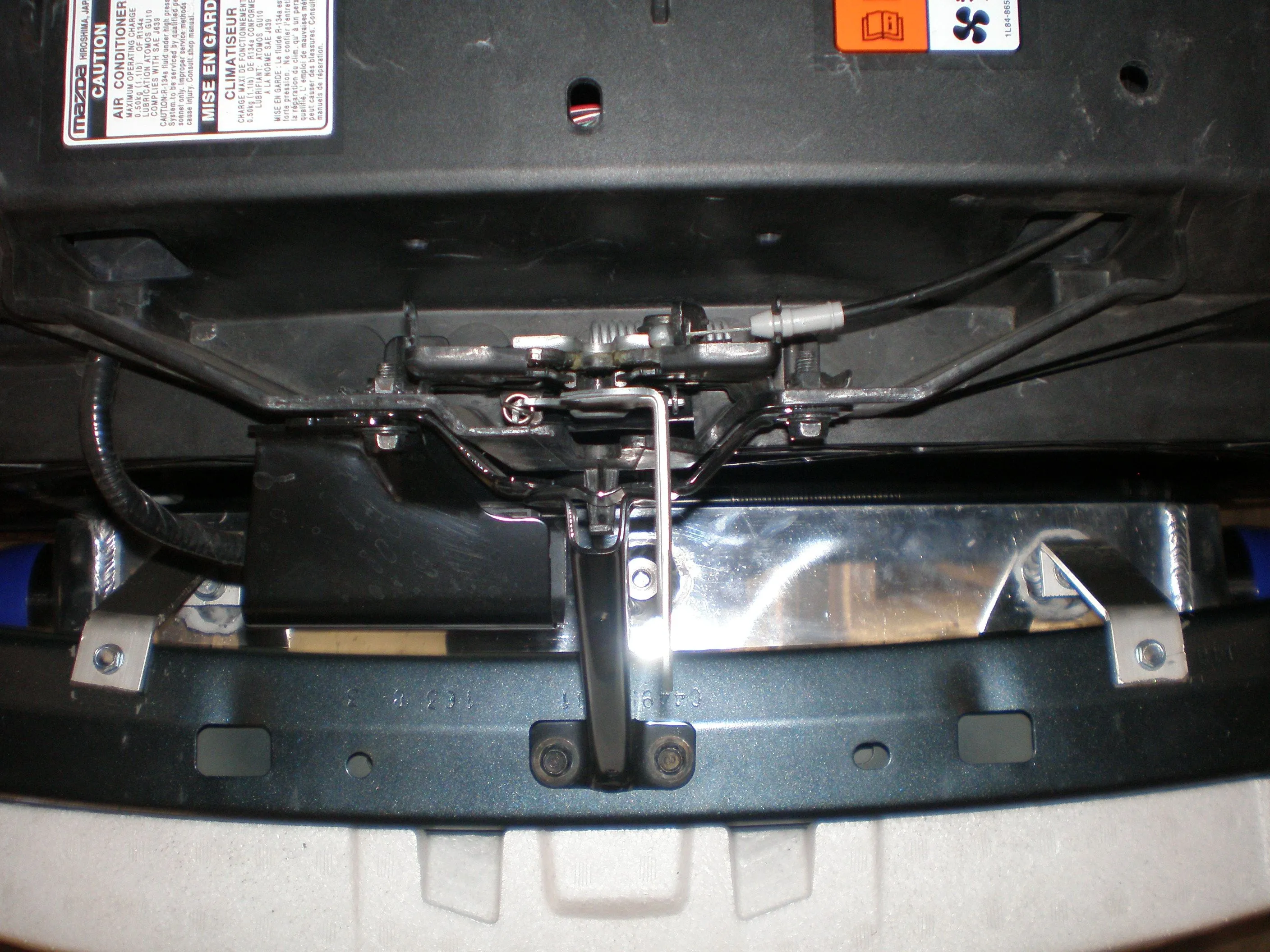

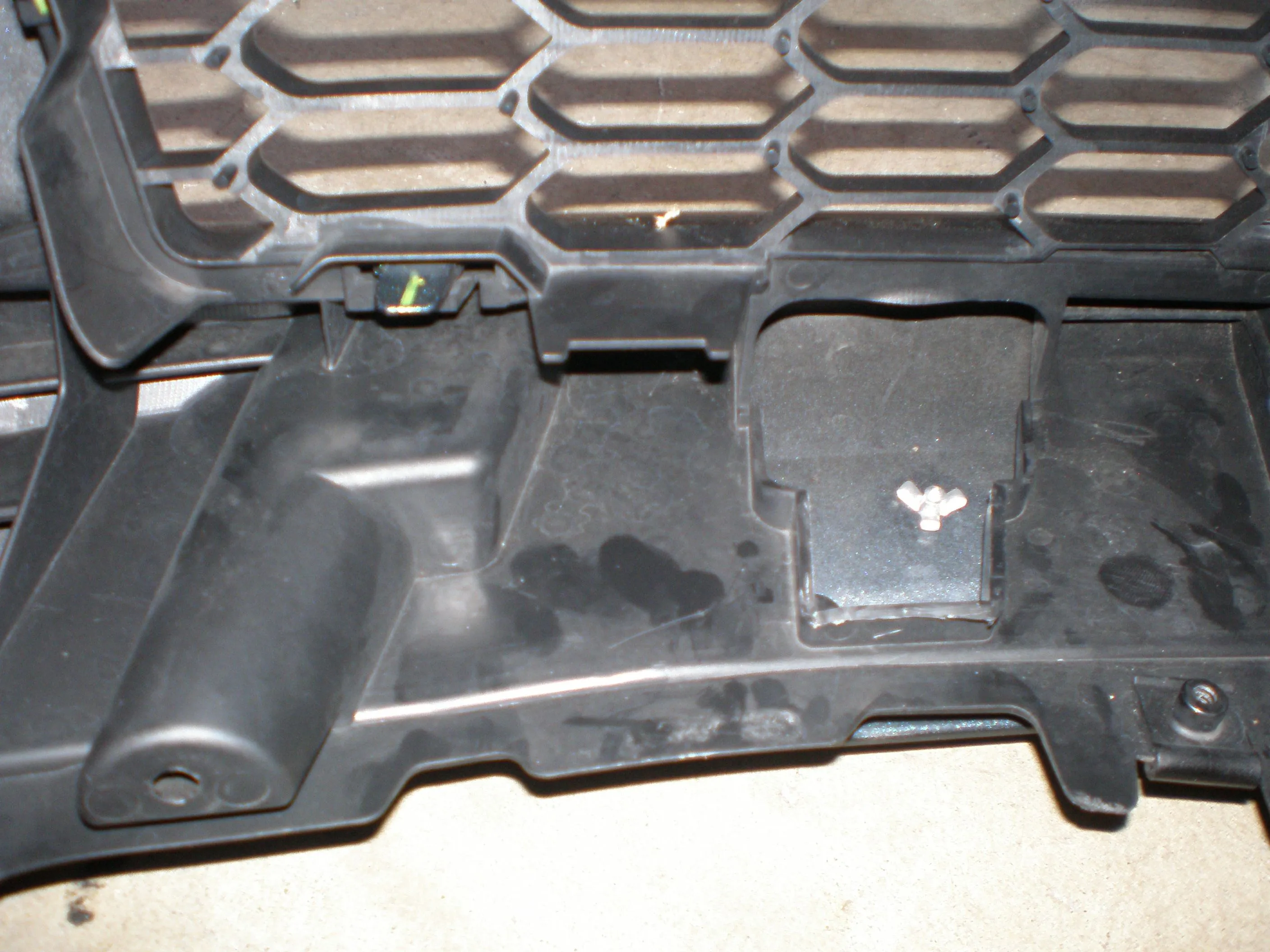

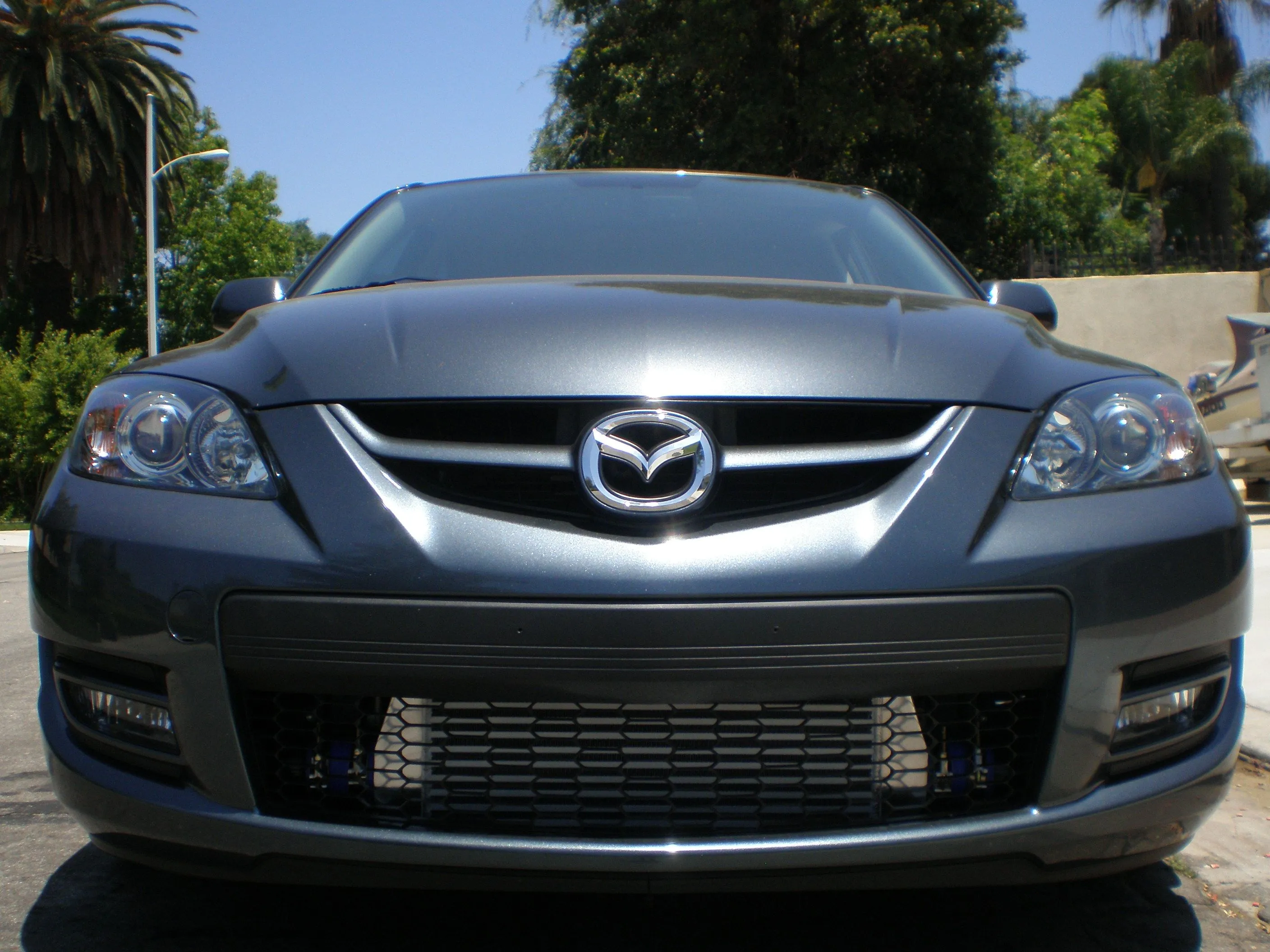

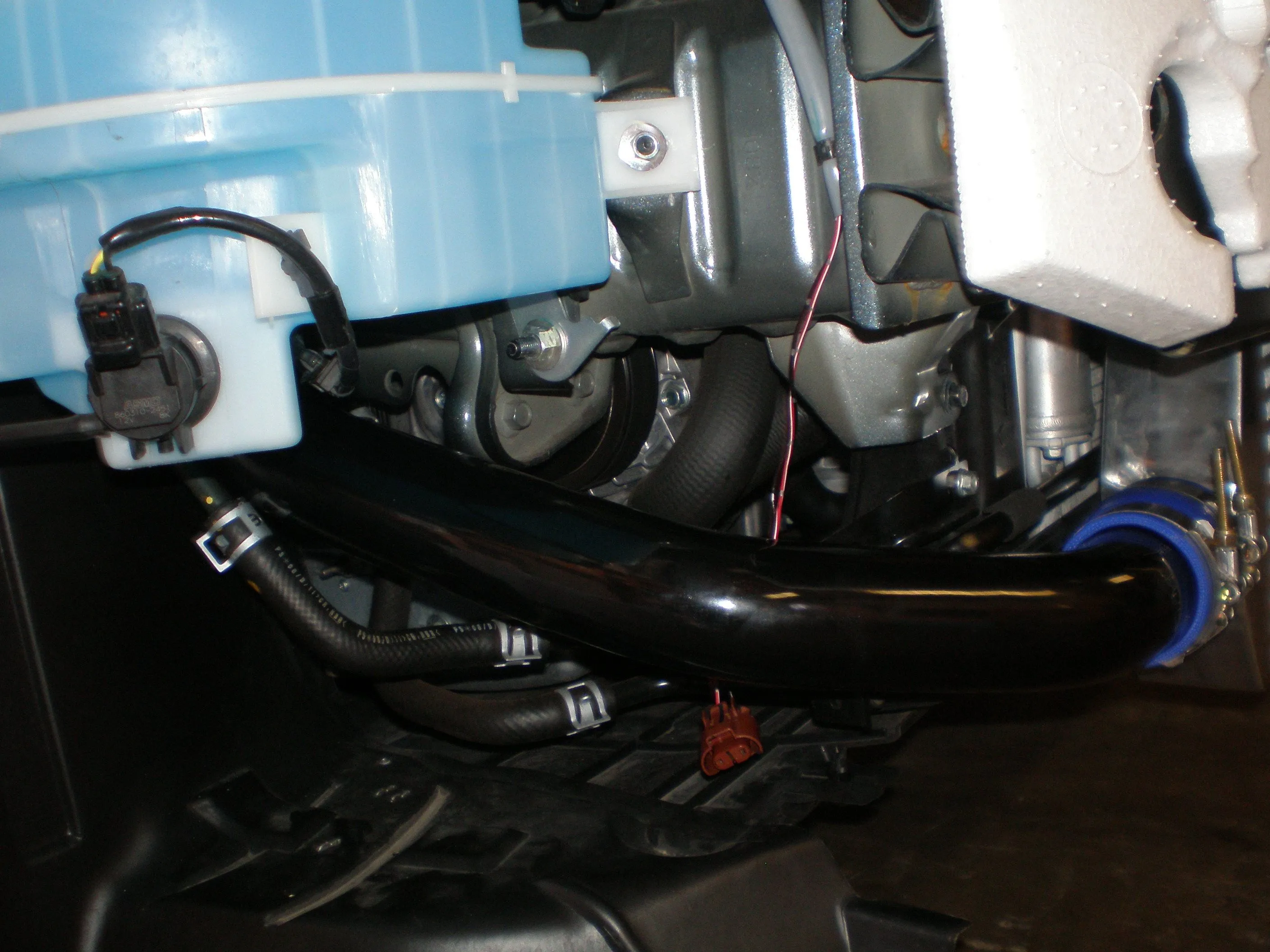

ok so i did the ED FMIC pipe kit with cx racing IC, Couplings, and T boltclamps. I cut one piece off of the bumper for a correct fit (see pics) No big deal, doesnt serve a purpose. im very happy with the whole install and power gains.

more pics from the install. you can see in the second to last pic what was needed to be cut off. let me know what yall think
