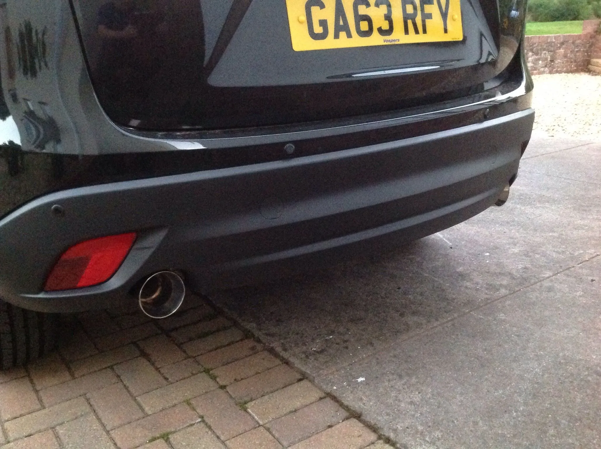

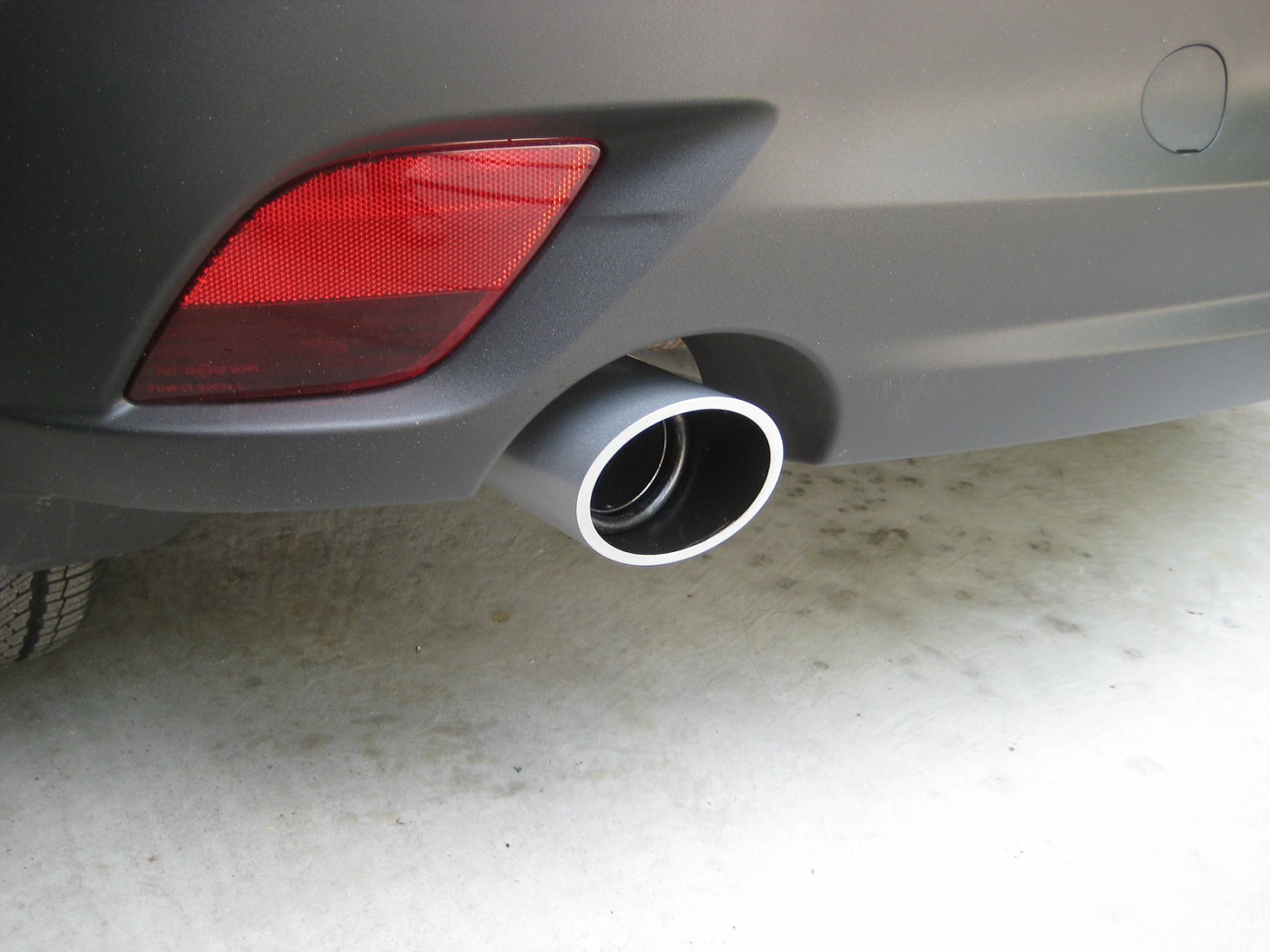

You all know what I mean! Looked around for various ways to improve this but couldn't find exactly what I had in mind so decided to make my own. Had some 3" ID aluminum pipe on hand, measured the valence angle and cut some blanks:
Powdercoated the outside and Painted the inners. Added a few set screws:
Done!
Very nice. I see they are approximately flush with the bumper. Do you expect any discoloration from exhaust on the bumper? I had problems with the exhaust tips on my CX7 and had to get them extended about 1 inch outside the bumper edge. Ed
There slightly outside now. Only on since yesterday so we shall see. I wasn't getting any sooting before though. If you had a CX7 turbo I can see that happening as the turbos run pretty rich
Very nice. Did you just put them over the old chrome tip or over the actual exhaust?
The ID of the tube allowed them to slip right over the existing tips and then held with set screws..

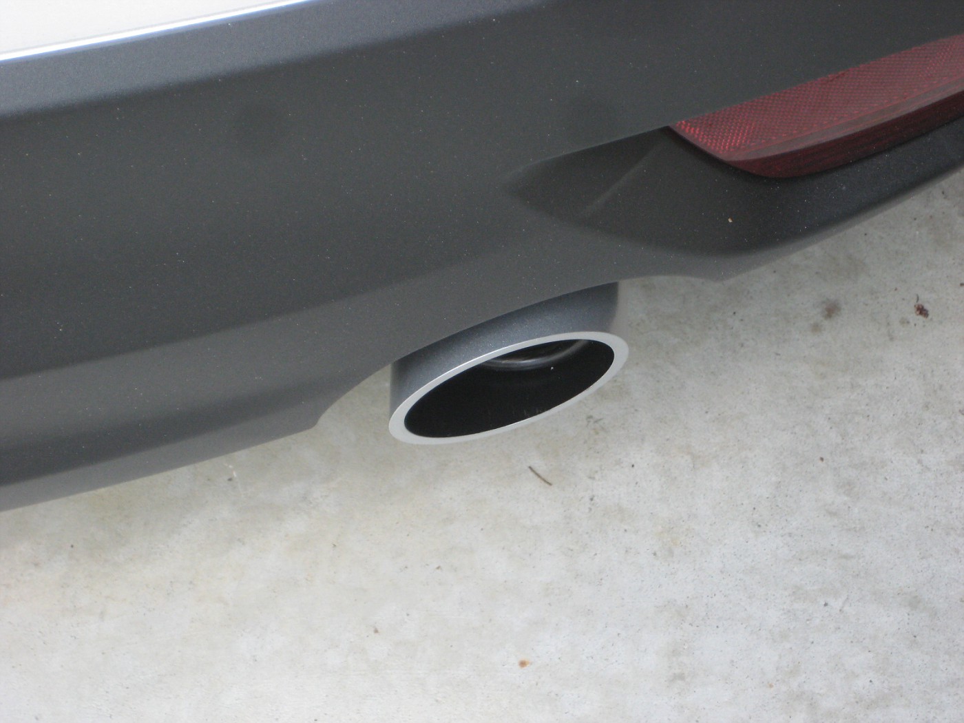

Here's a tip to make your install look a bit better. I put similar 4" tips on mine and ended up with the same shiney raw edge of the original pipe peeking out from the interior. I cleaned the inside and dusted it with heat resistant flat black paint to hide that shiney edge. Looks better to my eye.
