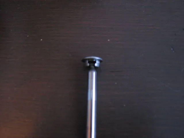

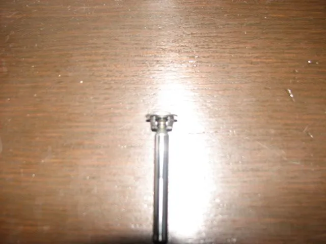

I need a bit of help with this:
How do I get the retainer off the stock internal's shaft?
TYVM.
It's allright, I figured it out. I thought it must be like a valve lock, in that a tap on a socket the size of the retainer would release the lock and, I was correct.
Need one more Q answered...How do I get the little button (stock-style retainer) back ON the retainer? And it's bevel side OUT, right?
Here's my answer I figured out after some head-scratching: I pushed the shaft up as high as it would go, slid a 14mm box wrench under the retainer, laid it between my slightly open vise jaws, with the wrench overhanging the gap, then putting the button on and smacking it with a deadblow hammer. Went on right away, doing that.
