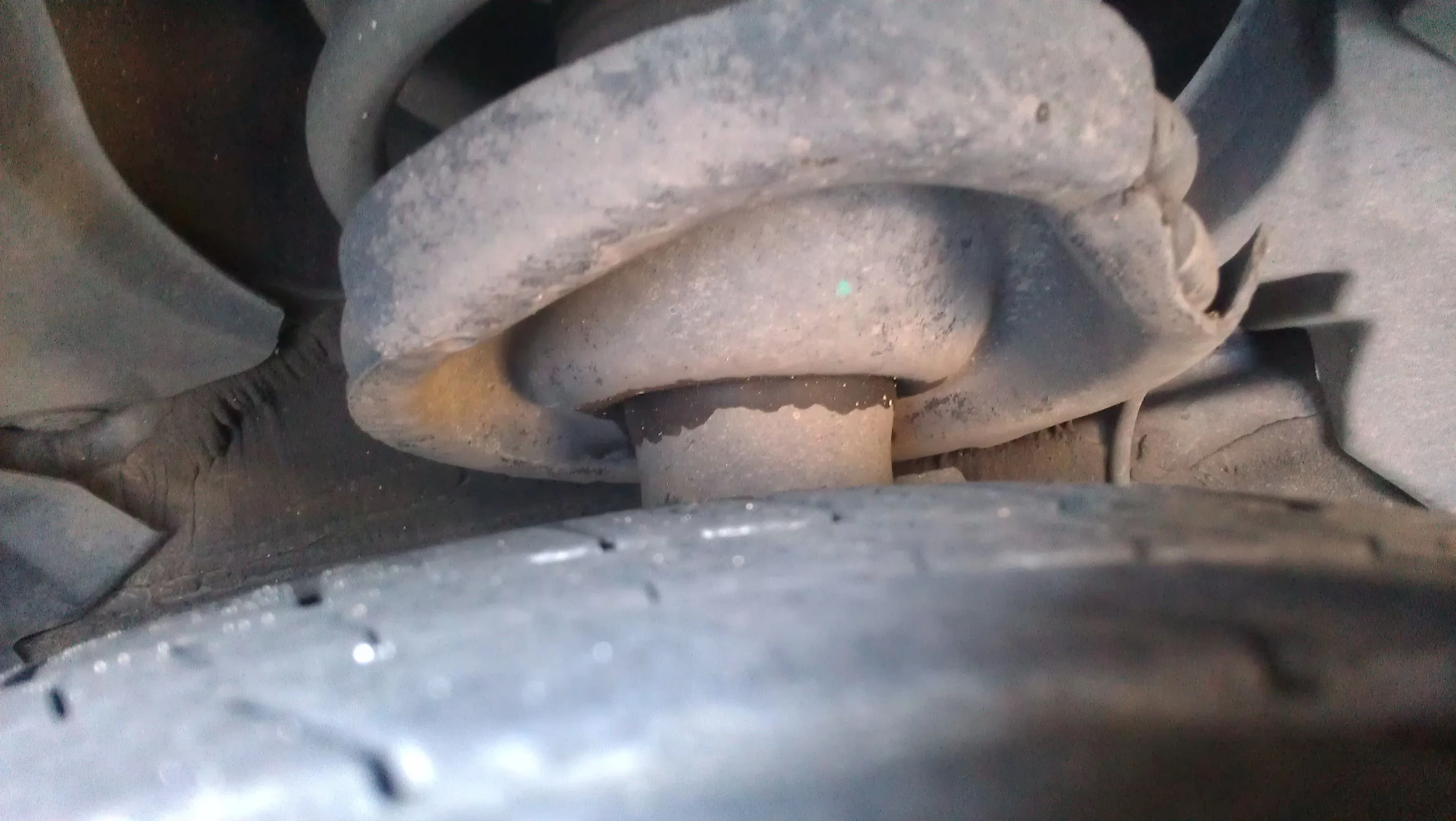

the reason why i need to replace the bushings is because im getting the clocking sounds from both rear and front suspension. I just notice that both left and right struts look like they are leaking. it does not look like too much but it still got me concerned. i attached an image of the driver side front strut. if they are blown, does it means that the clocking is coming from a bad strut? should i still change the bushings? what should i do? thank you for your advice.

If your shocks are leaking, definitely replace them first. Bushings usually don't die out during the normal lifetime of a car- at least 100k miles. The 5's shocks are a little weak for the weight of the car since they came straight from the 3, so they do tend to die quickly. Replace those, (clunking CAN come from shocks), then see if you still have odd noises.
little update. I order the kyb gr2 for the shocks and struts replacement. I did a little research and lots of people recommend those shocks for the mazda 5 oem replacement. But i still don't know what are the best or recommended aftermarket bushings for the mazda 5. any advice?
For about $10 extra dollars/shock, I would go with the newer KYB Gas-A-Just shocks for the rear. I paid about $48 each for these from RockAuto.com. These are mono tube shocks (vs. twin tube GR-2) and are advertized as an upgrade from the GR-2, which is meant to be an OEM replacement. I just installed these on our 2008 Mazda5 which has 62000 miles on the original shocks. It rides very nicely but it's my wife's car so I don't get to drive it too much. Someone posted earlier on this forum that the Gas-A-Just offers about 10-15% firmer damping for a more controlled ride. Unfortunately, KYB only makes Gas-A-Just shocks for the rear, not struts for the front. You could go with GR-2 front struts and Gas-A-Just rear shocks though.
