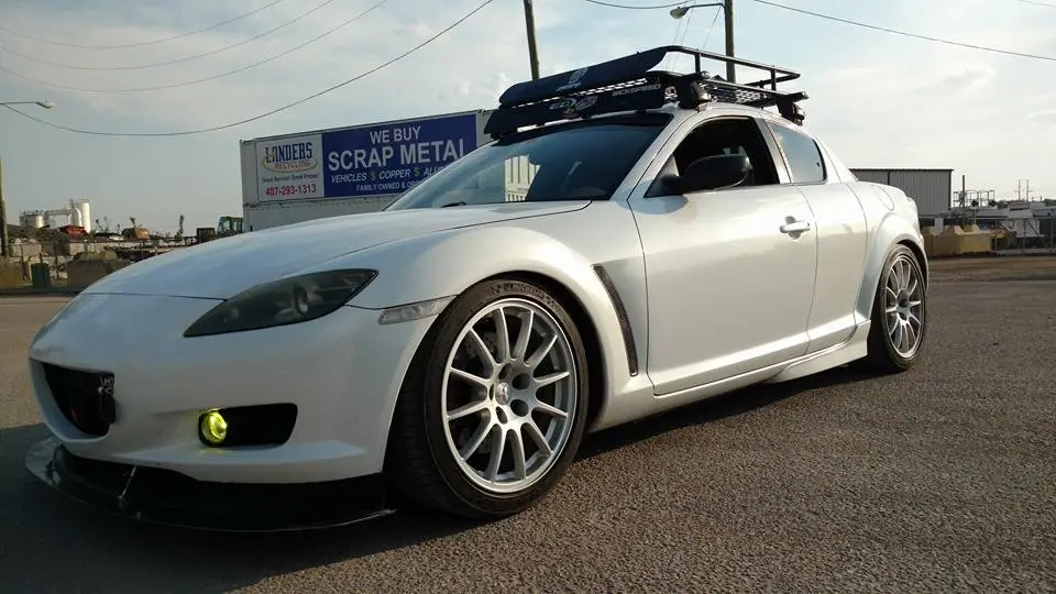

ancient thread update, traded the titanium car for a 06 RX8 with a Petitt Racing Engine in it and a ton of other suspension mods.
The titanium did make some good power, made 361whp and 380wtq on the OEM MSP exhaust minus the cat and a CD DP.
I later then did a 3" mid pipe only setup and it made 382whp and 402wtq
car was stupid fast but I wanted RWD.. lost about 200whp in the trade but going from FWD to RWD is worth it. After a few AutoX events in the 8 I could not imagine ever going back to FWD haha.
will be doing alot of AutoX/Track Day events with this car.

Built motor and minor head work
JDM Cams
SRI
OEM Turbo Mani
GT2871
626 Intake Mani - Not ported
Haltech ECU
3" Exhaust - Mid Pipe Only
STi Pinks - they where maxed out pretty much.
Custom FMIC - not a super big setup
Was at 21psi
Could have made more but I was running out of fuel and the tuner didnt like want to push the limits of the pump gas too much.
car also had straight cut gears too which sounded awesome, car was stout and fast as hell. Just wanted to get into something new and RWD.
