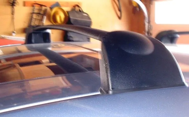

The outer edge covers are on with snaps which are clipped to the inner part that actually is bolted to the roof of the car. Carefully push upper ends straight up.
Then unbolt inner end piece. Remove tube.
Reverse once racks are installed.
