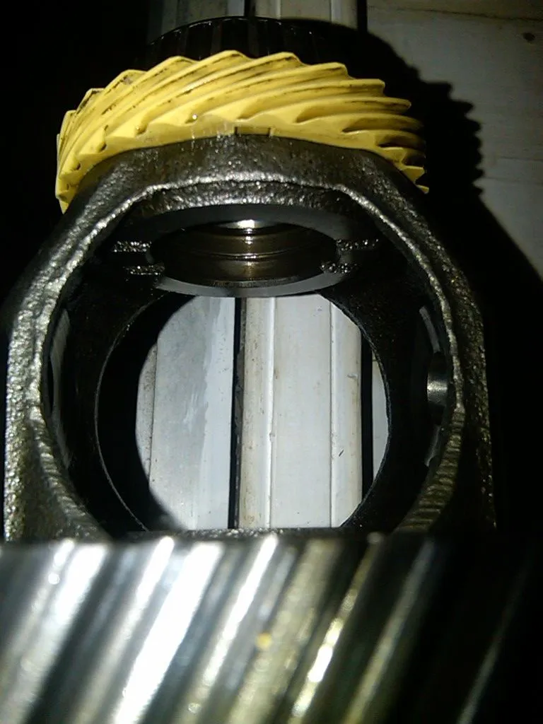

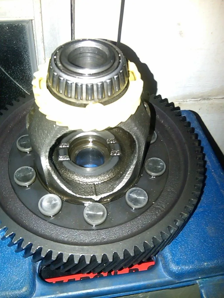

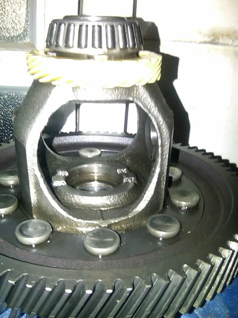

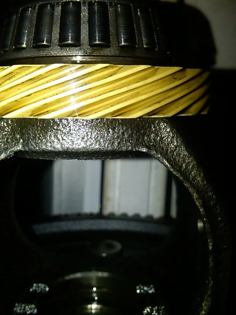

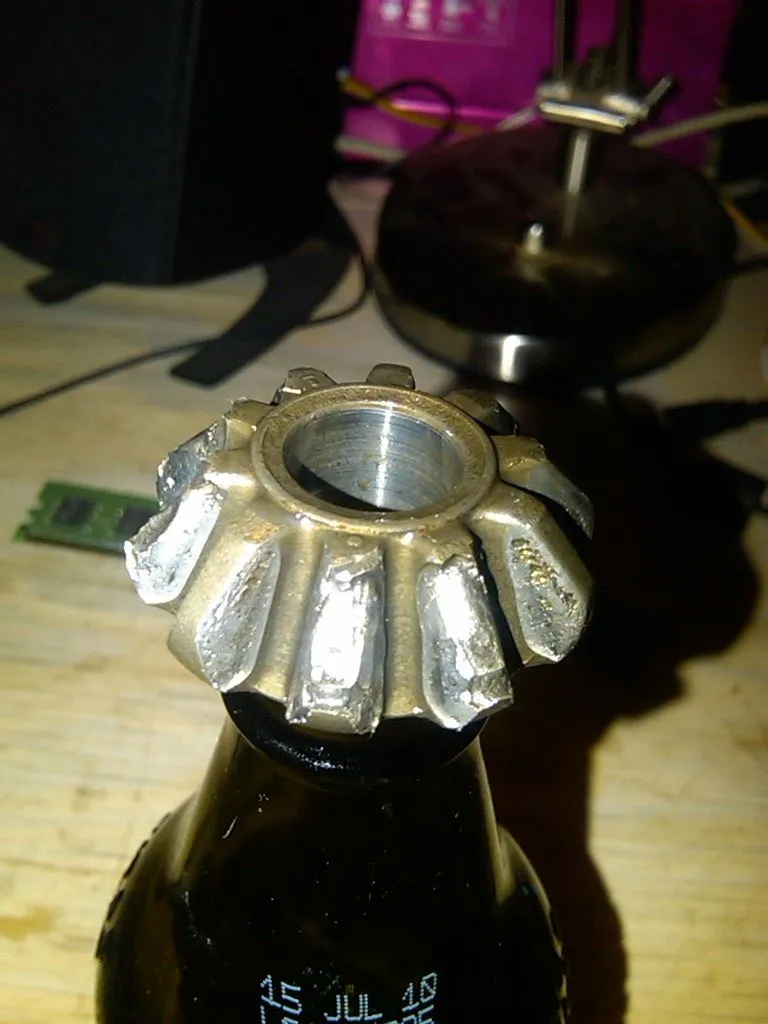

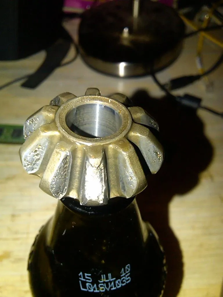

Same prob here check the pics.

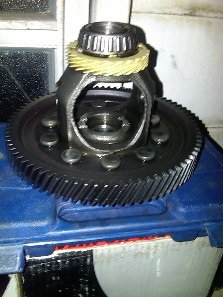

And the rest of them
Um correct me if Im wrong but can us with the F-series tranny make like some wierd sort of F/G combo tranny? Something like swap the axels and something else; allowing your to use the MSP diff and beefing it up to the point were we dont need to worry about blowing it out....? I have already replaced my transmission once because of blowing out the diff; anyone know anything about this concept? would be nice to be able to have one already put together and waiting for when this current transmission blows up, because we know its going to happen again lol.

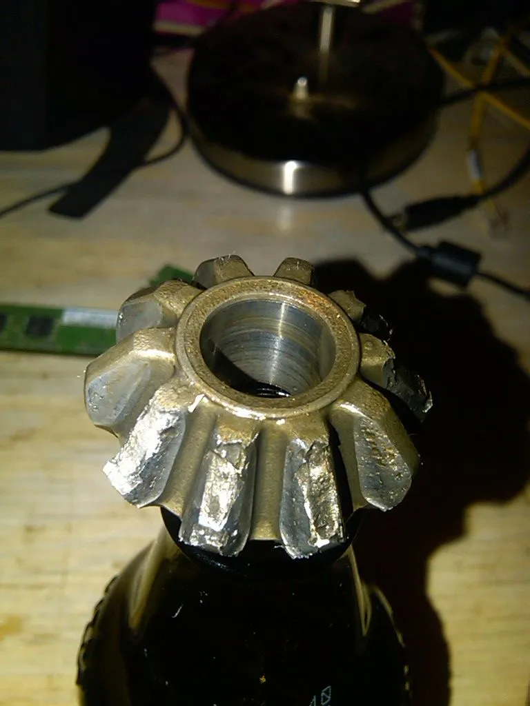

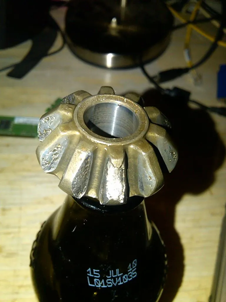

I'll bring back to life this old thread with my F25M-R diff pics!!! Boosting a 1.6L means this: (not so bad because the tranny was working good, and after 270 000km of beating up the car, it's kind of normal!)
So until I find another diff for the tranny, let's clean it up a little bit!
