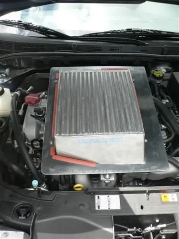

The OEM plastic shroud/cover fits over it, right? If this improves drivability in warm climates, I'm totally sold.

The stock shroud does not fit on any of the ETS TMICs. They come with an aluminum plate that seals against the hood.
Gotcha, thanks for the pic.
