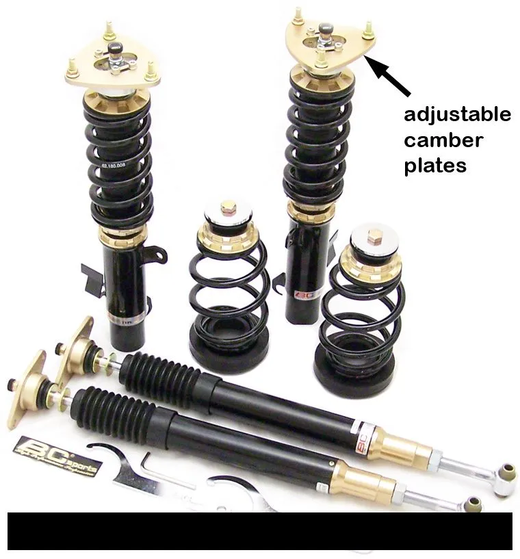

I'm more concerned with the BC coilovers you speak of? I noticed on another site they were for sell but I didn't think they came with the adjustable pillow mounts? So the BC coilover that ********** will sell will have adjustable camber plates available? I'm looking into whether or not to get coilovers and the BC seems like the best option out there as far as price, what was holding me back was no camber plates though.
I know the other site you mention...he doesnt know s***. point blank. The mazda 3 kit that BC makes (origninally overseas as this is where BC is located, Taiwan to be exact) comes with the adjustable camber kit. The guys I have been dealin with have also confirmed this with a pic of the actual Mazda 3 Unit. The problem with the camber plates is the US Spec 3 and speed3 have a top hat just over the front struts that will not allow the allens to be adjusted. They are doing test fitting now to see what can be done...this is what i am waiting on. I would prefer Teins however am growing impatient now that wheels and all are ready to go on..and for the price and amount of adjustability...you just cant beat the BCs. Look them up for the Evos and STIs...those guys aparently have been VERY satisfied.

Testing is done. SU sent me pics today of the kit installed on a 3. There are no clearance issues however becuase of the top hat you will not be able to adjust the camber unless a) you plasma cut off the top hat(its just sheet metal) or b) drill a hole through the top hat to access the allen bolts...either way im ordering my set first thing tomorrow. Pics are at work, ill put em tomorrow.
