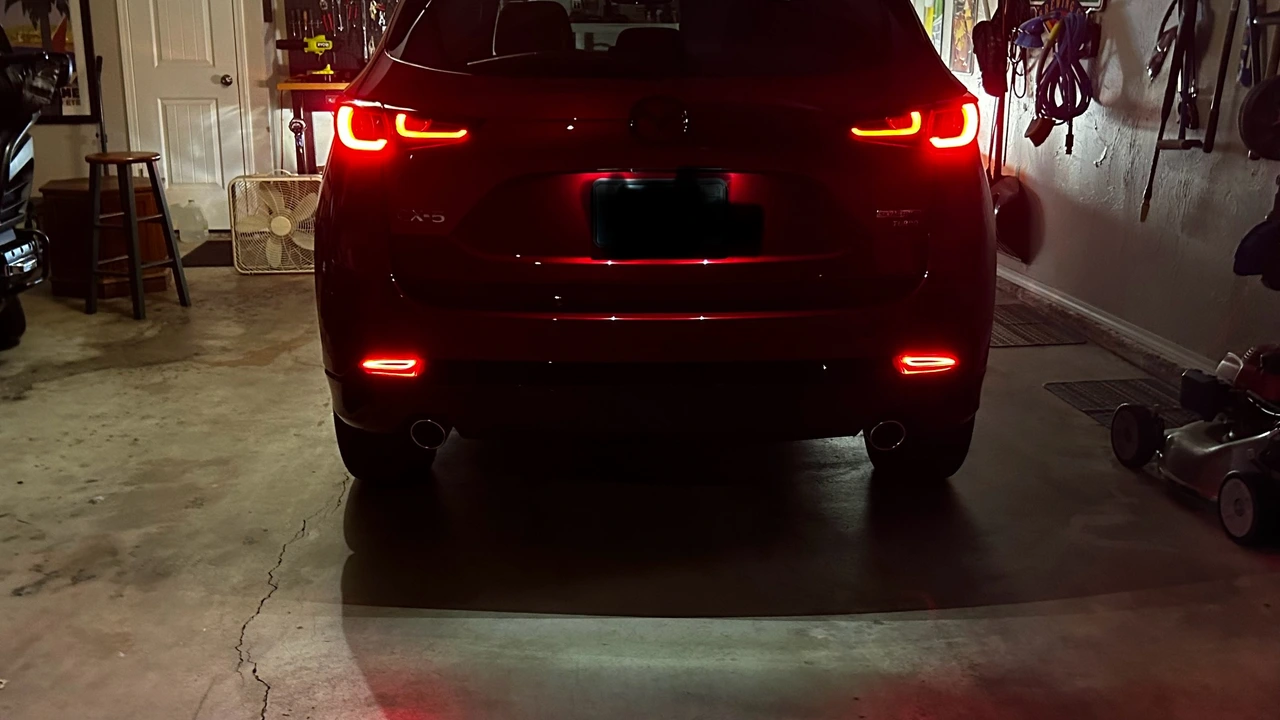

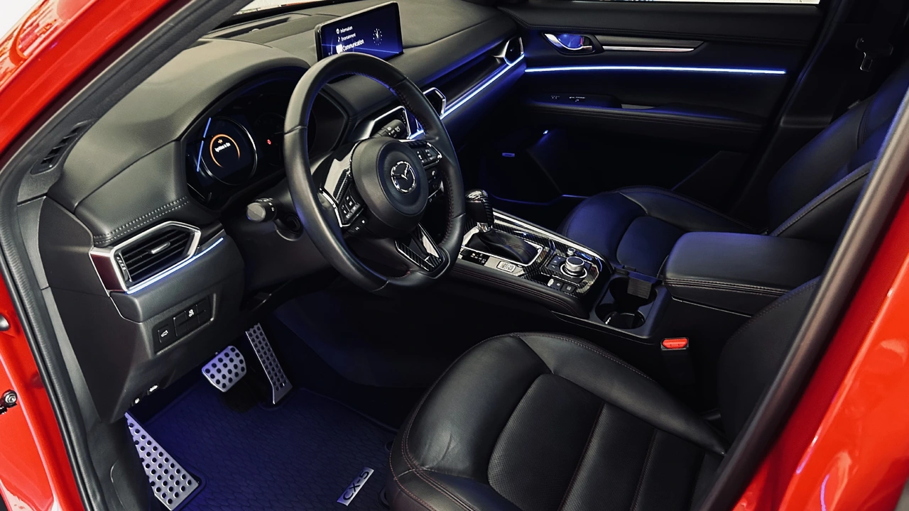

I did the Everstart from Wallymart. Most all batteries in the US are made by Johnson Controls, regardless of the lable, I learned. The platinum AGM everstart was $179 and had the longest warranty I could find, 4 years. In the application guide at Walmart, it’s not listed as compatible but it was a perfect fit in my 22 turbo. It took about 2 weeks of normal driving for the computer to adjust. Initially, after a drive it would take a trickle charge for about 10min to top up the battery. After about 2 weeks, it seemed to adjust the charging to accommodate the different tech of an agm, top up no longer needed or would not go into a charge mode, by the tender. My cx5 has 37,000 miles and Im a detailer and modder. My jbl sub and frequent interior cleaning with the doors open and lights on killed the oe battery that was probably on its way out anyway. Im running a custom interior light kit, added some led brake, turn and running lights in the rear bumper and the jbl basspro sub. It doesn’t seem like the load would be that much more but it was. I had a battery tender remote sae terminal in my front grill so hooking up my tender didn’t require opening the hood. I checked the charging voltage after the new battery, 13.8, just in spec for the AGM. Group 35 for the turbo.Oh, and it seems to start faster, almost instant as compared to the old flooded acid panasonic.

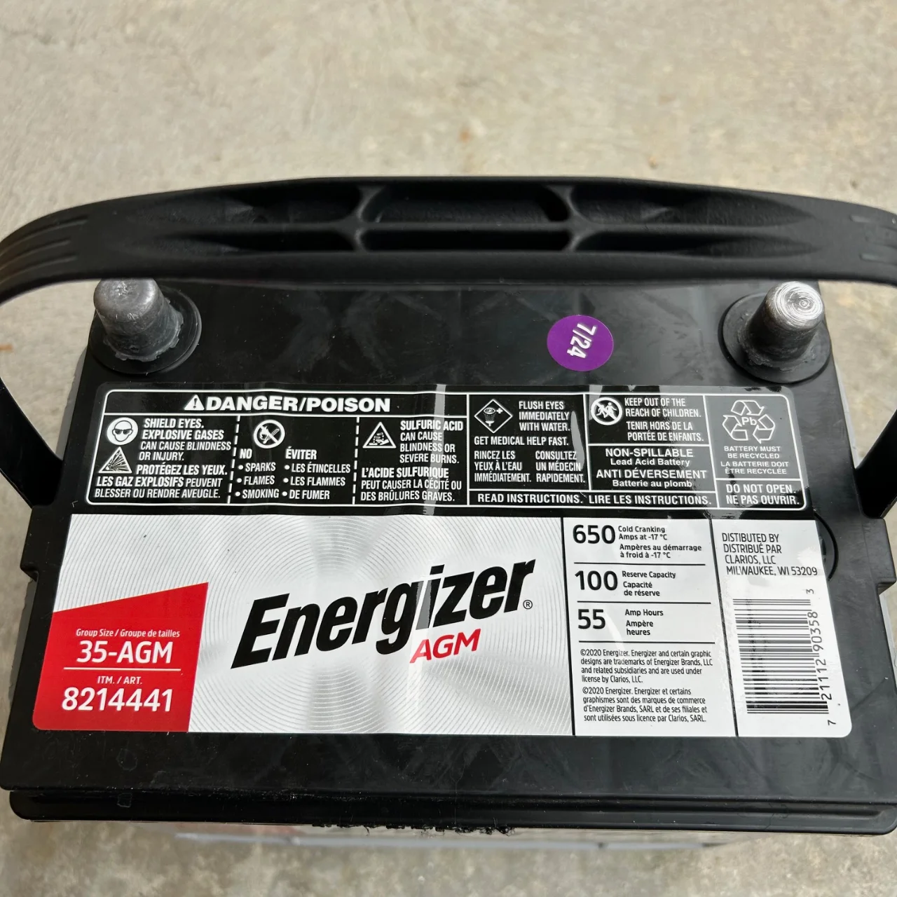

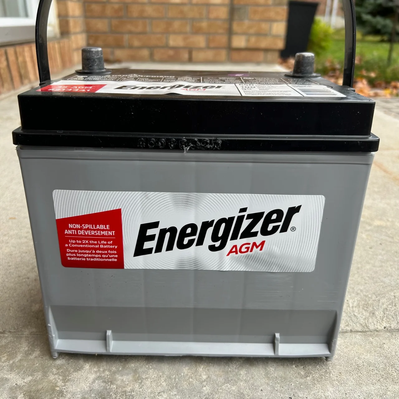

Thanks for the advice! I bought the Energizer AGM battery from Costco and installed it. Straight swap. The engine does feel like it fires up faster, definitely an improvement from before.
I don't know the country of manufacture though, there is no "Made In..." label on it.
