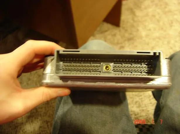

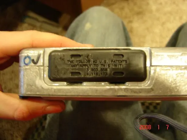

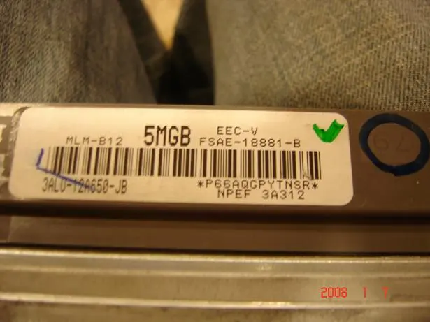

here ya go its a p5 ecu but hopefully it helps
