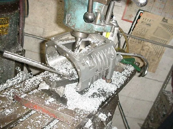

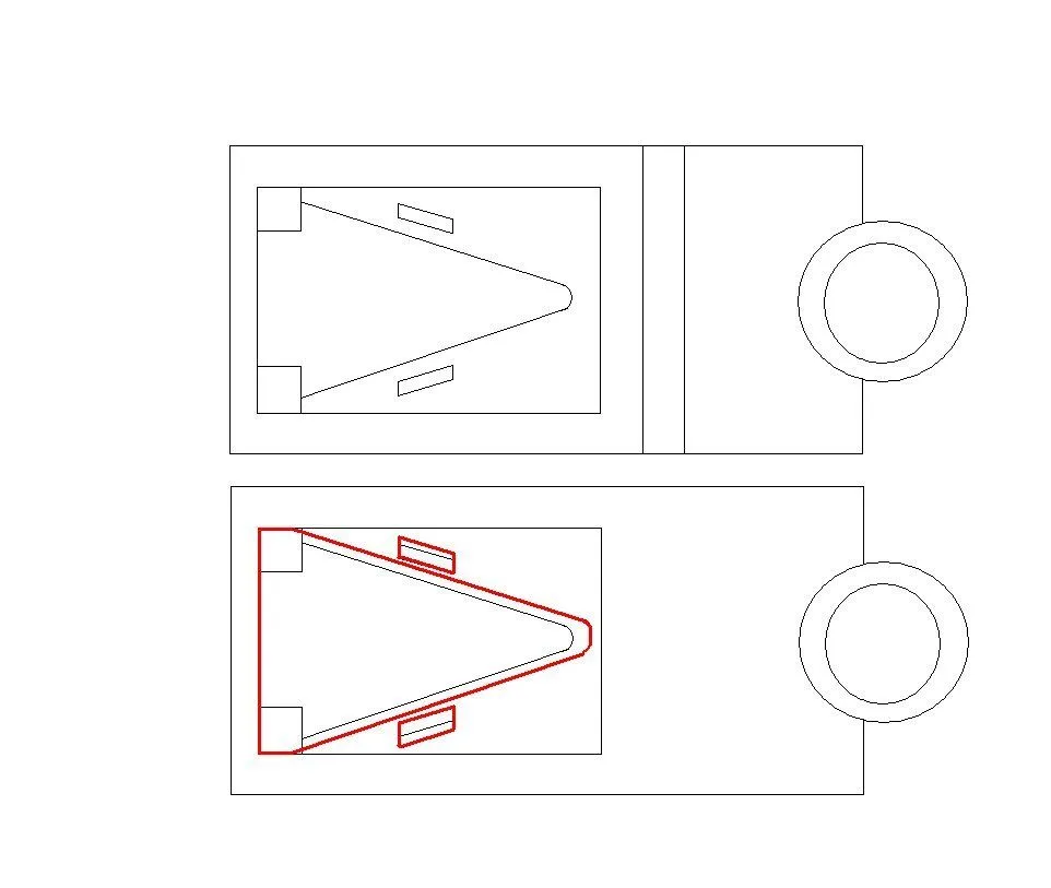

MY STOCK 94 PROBE SE MADE 95 WHEEL HP STOCK. AT 6 PSI WITH HEADERS AND EXHAUST I MADE 164 WHEEL HP. I WILL SEE IF I CAN DIG UP THE DYNO SHEET.
I HAVE BEEN BUILDING EATON SUPERCHARGERS SINCE 1990. I AM ONE OF ONLY A FEW THAT UNDERSTAND HOW AND WHY YOU PORT THEM AND RAISE THE THERMAL EFFICIENCY FROM 58% TO JUST AT 70%. IT TAKES NEARLY TWO DAYS OF MACHINING ON A BRIDGEPORT ANDF THEN HAND PORTING TO ACCOMPLISH THE WORK. I REPLACE ALL THE BEARINGS AT THYE SAME TIME. COMPARE IT TO BUILDING A RACE ENGINE USING A SEASONED BLOCK. ALL NEW BEARINGS, RINGS, ETC, WITH A FULLY BUILT ENGINE COST MORE THAN A FACTORY REPLACEMENT THAT IS NEW. I CAN USE NEW SUPERCHARGERS AND THE COST GOES UP $1100 PER KIT--THEY CAN CHOOSE WHICH ONE THEY WANT. RAISING THE EFFICIENCY MAKES COOLER AIR COME FROM THE EATON, TAKES LESS HP TO TURN IT, AND ALLOWS A BUILT ENGINE TO MAKE 30-50 MORE HP AT THE SAME BOOST LEVEL. HAVE THE WORRIERS LOOK INTO RACE PORTING EATON UNITS AND MAYBE THEY WILL UNDERSTAND WHY WE DO IT TO ALL OUR KITS. THAT IS WHY MY KITS MAKE MORE HP THAN ANY OTHER KITS OUT THERE--NOT EVEN A CLOSE SECOND. HOW ABOUT 278 WHEEL HP FROM A BONE STOCK KL-V6 PGT @ 7 PSI? THE BEST TURBO KITS MADE 255 WHEEL HP ON THE KL V6. ONE CUSTOMER WITH A FULLY BUILT FS MADE 365 WHEEL HP @ 18 PSI WITH ALCOHOL INJECTION.

For one, not mentioning any inlet work is a bit concerning. Although porting the outlet yeilds the most dramatic gains, so I can understand not letting all the tricks out of the bag.
For similar cars with the same engines running a roots supercharger making more power at the wheels than one with a turbo, is more an issue of tuning and flow. The adiobatic efficiency of a centrifugal supercharger is far better than even a ported roots. A "turbo" is simply a turbine driven centrifugal supercharger. The losses from the turbine impeding the exhaust flow is less than the losses from driving the roots supercharger. Throwing around peak HP numbers is not how to sell roots superchargers. Explaining the benefits of a nice long flat torque curve is. Seeing how he throws around HP numbers bothers me A LOT. Although, I can see how someone in the business would get driven to do that based on what the customer wants to hear.
Also, the Gen5 Eaton had extensive redesign of the inlet and outlet over the Gen3. Consequently, gains from porting are not as dramatic. If efficiency is a concern, look into a twin screw supercharger like Whipple: no spool time like a roots, with top end similar to a centrifugal.
