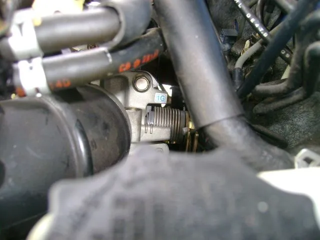

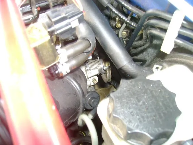

thejetman said:
heres an idea.....start your car....put the parking brake on, open the hood, grab the throttle with your hand and give it a couple of "flicks" of the wrist. IF you have any lash, you will see your motor moving back and forth in the engine compartment. befor i put the mounts in my car, it did it. Very violently might i add. After i installed them, the engine does not move. As far as your 'bucking" problem goes. It is BECAUSE you have the stiffer mounts. all that power is now getting to the ground, causing more traction and "launching" you forward if you will. You just have to get used to it. I have a stage II clutch and lightweight flywheel and i have to be gentle at low rpms. Just push the clutch in more at low speeds, coast. Your problem will go away.
Thanks for the idea. About where is the throttle cable located?
This feels like wheel hop, except it's when I try to back out or move slowly around a parking lot. Does yours feel that way?
Negative ghost rider, i have No wheel hopege.
the throttle is located next to the firewall on the drivers side by the intake on top of the motor.(screwy)
