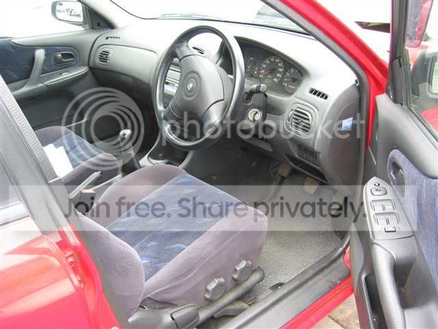

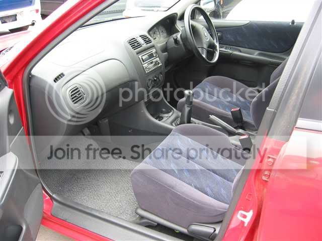

im a rhd guy in a lhd country too bad, i've been drivng rhd for the past 5 years now and i hate lhd so i'd eventually swap rhd with a front clip from japan or Australia
