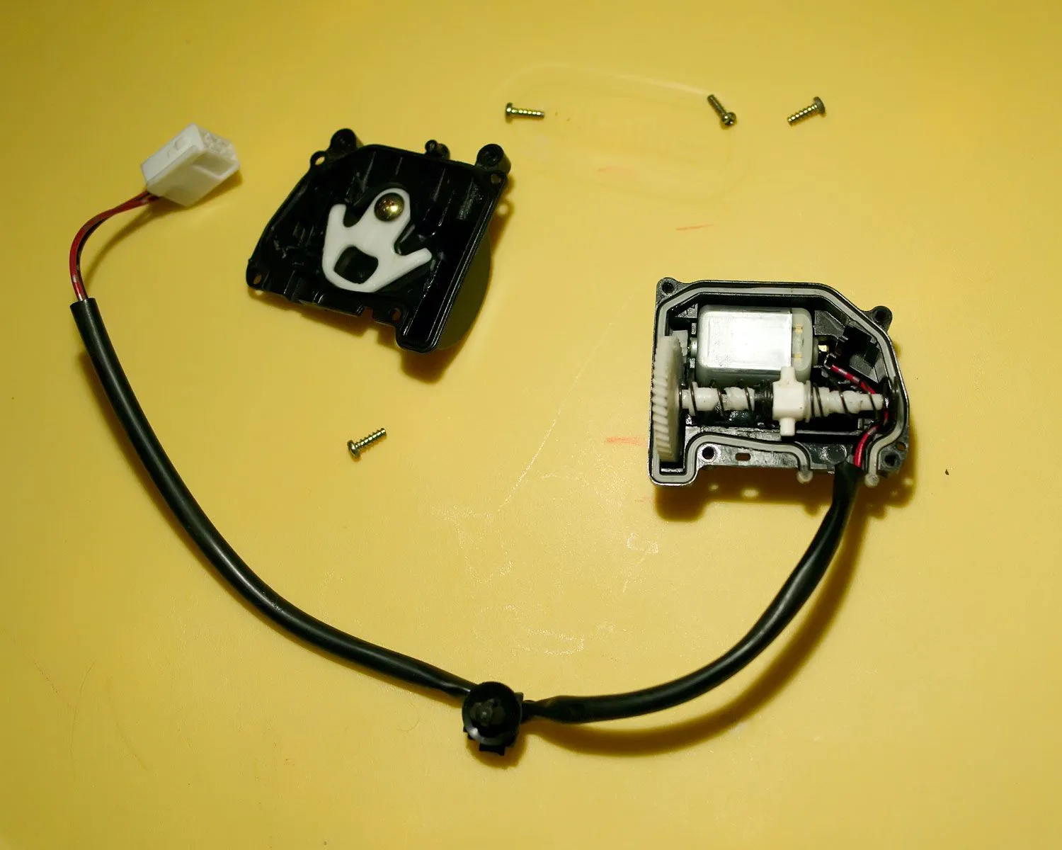

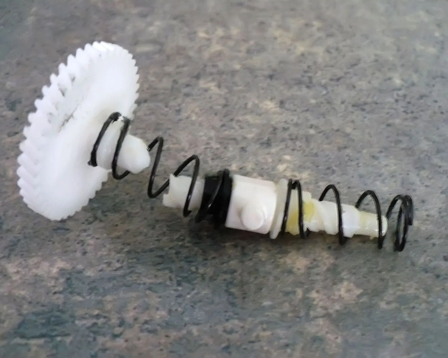

Here's the broken worm gear....brutal cheap plastic.

That's what rolls down the back window or locks the back door? doesn't look anything like I replaced to lock/unlock the front door but I've never done the back door. Worm gear just seems like something to roll down the window.
Yes this controls the power lock. It's the gear that is inside the actuator. The term worm gear, I believe, is generic in nature and is consistent with the configuration of the gear itself.

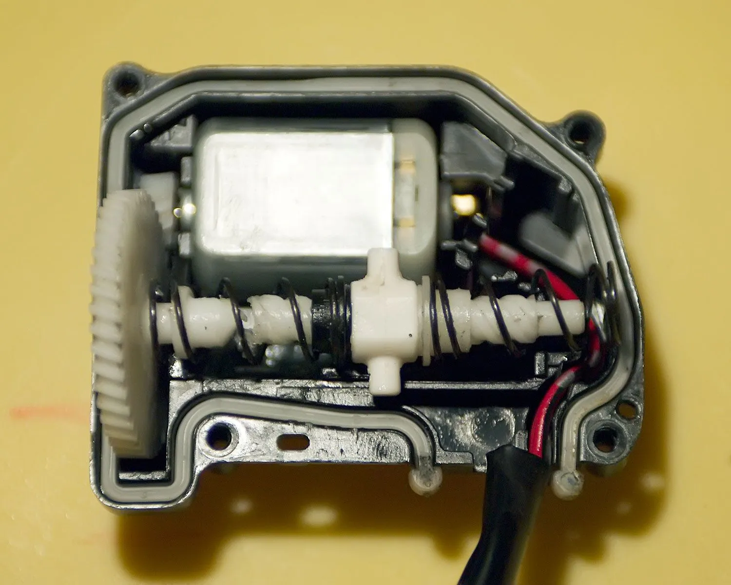

Here is the gear sitting in the actuator. I only posted a pic of the gear in the previous post without stating that it came from inside.

Oh, gotcha. Cool, never opened mine up, just tossed it after replacing the assembly. Never opened the bag on just the actuator piece I got new from the fs section, just stashed it. Thanks for the pics. Can you buy just the gear piece to fix others if they break? Makes me wonder if the gear from the new one I have would fit in the others if they break or if they're all different.
I'm not sure if you can buy just the gear or not. That would make things pretty easy wouldn't it. The only reason I knew to open it up was because somebody on this forum had done it before and I just wanted to see how cheap it was inside. There is also a post on this forum where somebody has super glued the gear back together. I think I am going to try that and keep this one as a spare. May work or may not, but worth a shot.
