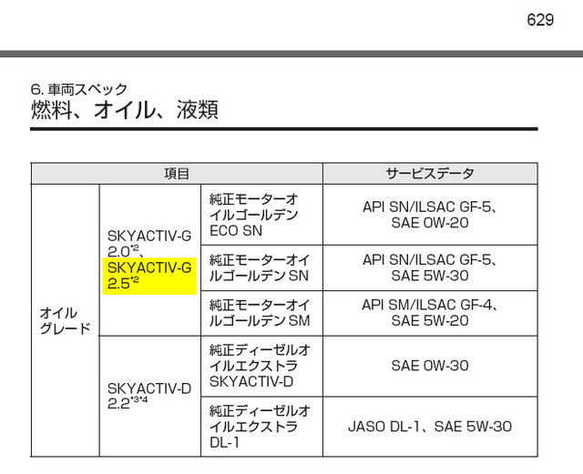

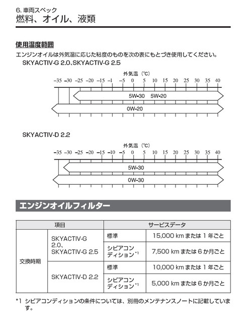

well I just checked myself, right there in the owner's manual, 0W20 is used for fuel economy for USA and Canada (hint hint CAFE),
everywhere else use 5w30 (I'm assuming this includes Japan, so even Japanese users are using 5w30 ?)
Everywhere else except USA and Canada, use 5w30. Well there you go, that about sums everything up I think

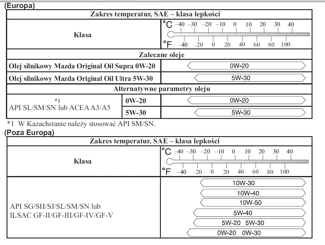

That's from the north american owners manual.
0W20 oil isn't really available at a reasonable price anywhere in North America except USA and Canada...
Notice that even 10W50 doesn't extend the upper temperature range the engine can run in...
attachment.php
So 0w20 is useful only for -40c to -30 weather and thats it? releastically it shouldnt extend past 20c either.
