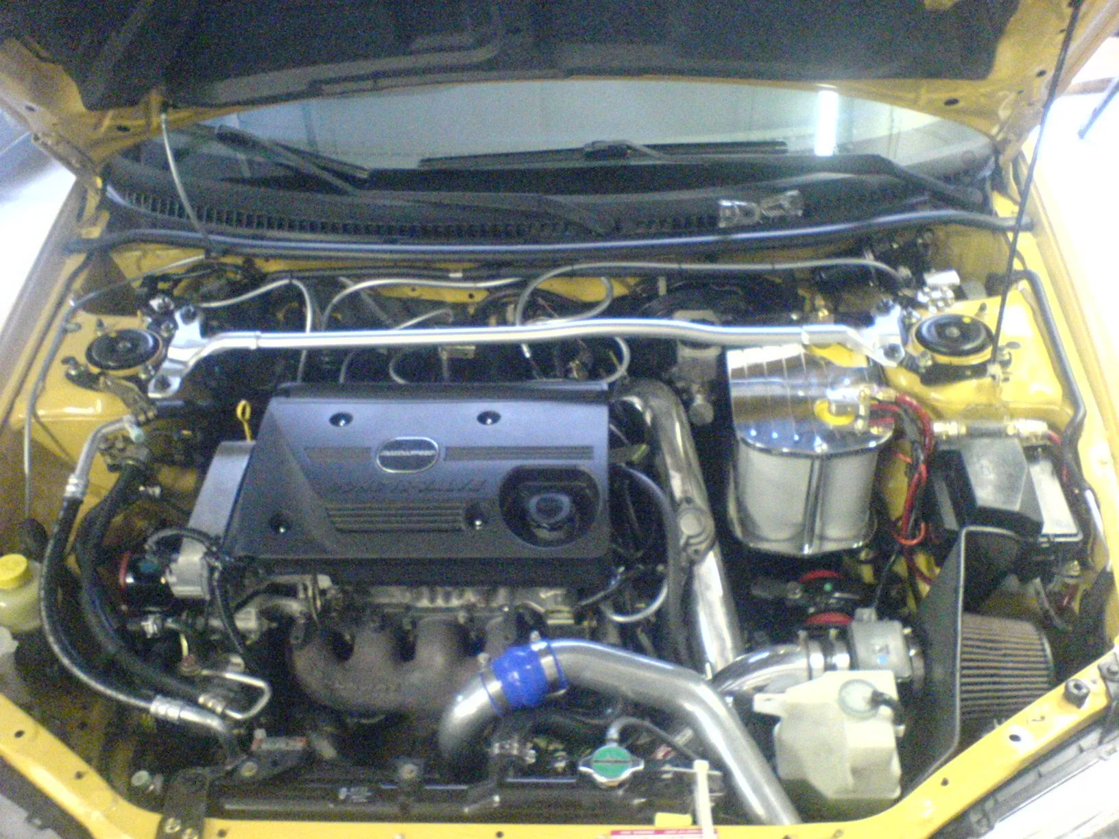

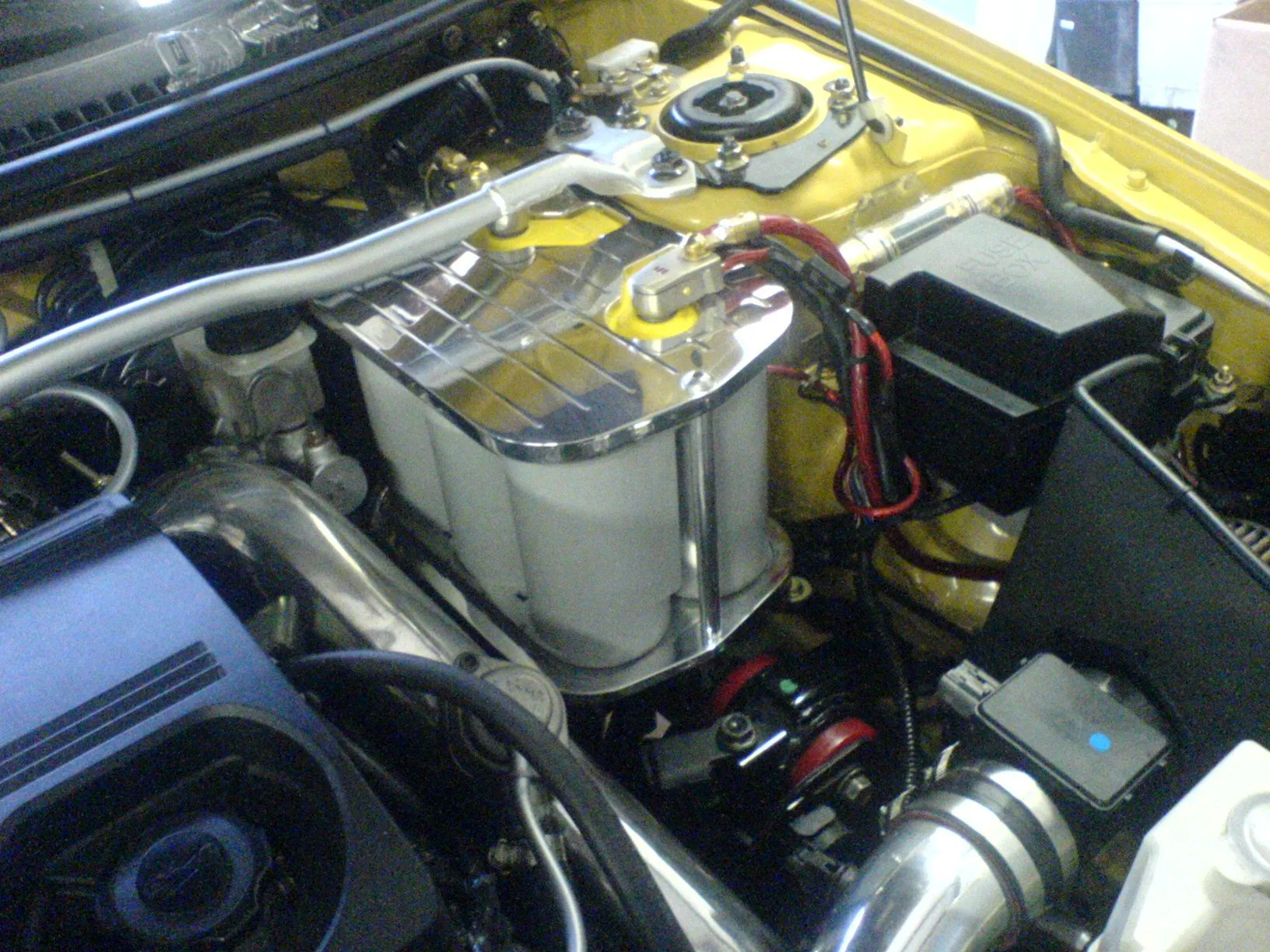

A couple of engine bay pics before the turbo, tubular manifold, etc.
nice stuff man, betcha can't wait to get the gt28rs on and tuned!!
FWIW i'm running a 12" and a 9" SPAL slimline fan, they've worked fine for me although the 9" in particular is a little noisy. My A/C condensor fan is on the front of the radiator, which could help you get more clearance as well.
Pretty sure you can get the SPAL fans from *************.com.
