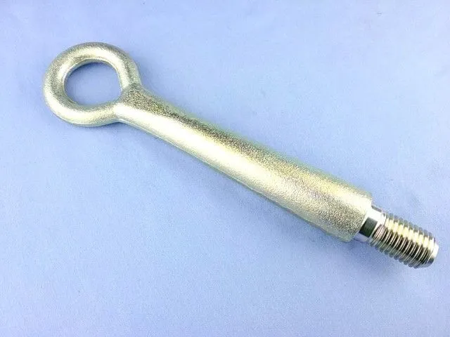

I was checking the tire pressure in my spare this morning and noticed that there is a cutout in the styrofoam panel forward of the spare for one of those eyelet type tie down hooks or tow hooks but the tool was missing. They are supposed to thread into the hole under the plastic covers on the front or rear bumpers.
Mazda shows it as part # KD53-50-EJ1B and I have attached a photo.
The manual says that the hook is just to tie down the vehicle while being transported but I thought they were also useful should your car end up in a ditch and someone wants to hook a cable onto it to recover the vehicle.
Anyway, did anyone receive the part with their CX 5 ? If so I am going to call the dealer and request that they send me one.

The part number you quoted is the proper tow eyelet that should be used for recovery purposes. The hooks that the manual mentions are shipping eyelets that should only be used when the cars are on their way to the port. They are not suitable for recovery, which is why Mazda stopped leaving them in the cars starting in 2014.
I believe the part you need is about $15-20 at the dealer.

previously I had gathered this information
Front tow hookKD53-50-EJ1B
Rear tow hookKD53-50-EJ2B
note both will work in either location (threaded the same). The front part number is longer, to help clear plastic parts and such.

There are long and short towing eyelets. You only need the long version as it works for both front and back. My 2016.5 didn't come with them but when I mentioned this to my salesman, he ordered a set for me. My 2016 MX-5 didn't come with them either, I bought the long version for this car.

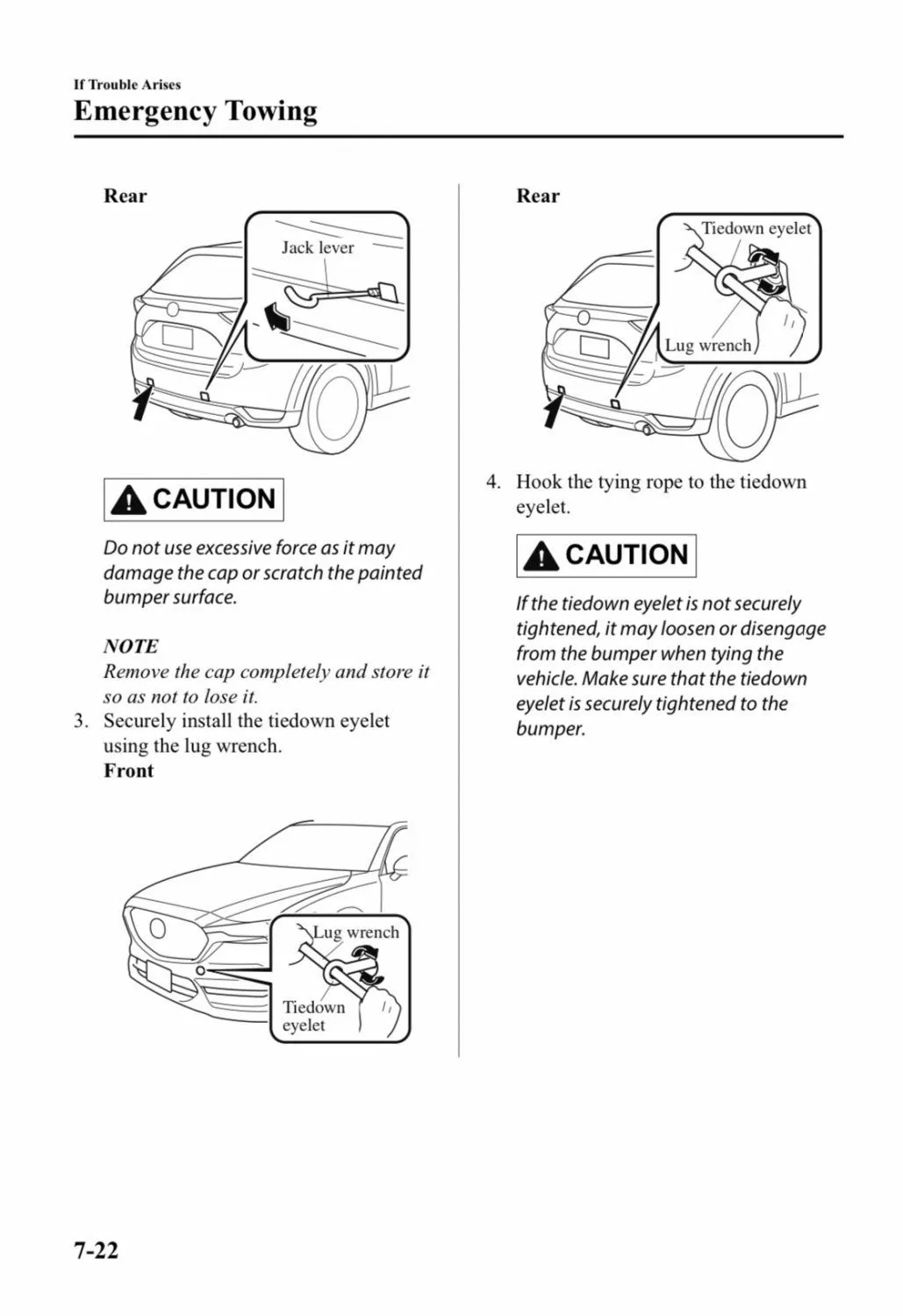

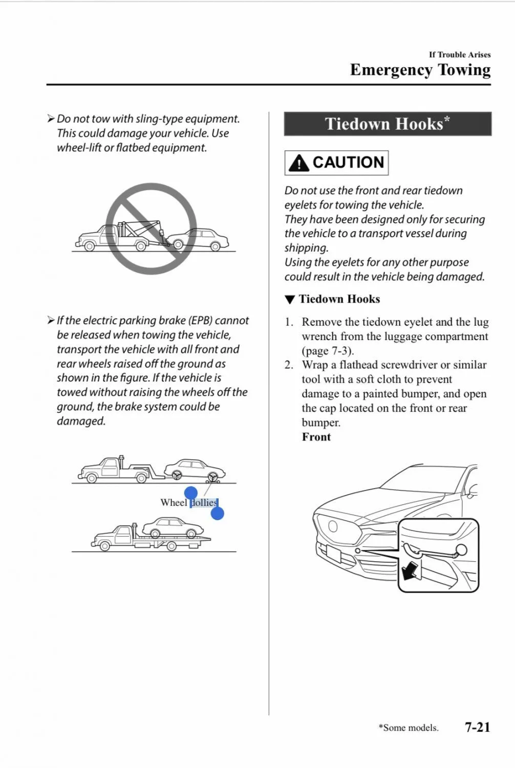

The tiedown eyelet showed in the picture is “designed only for securing the vehicle to a transport vessel during shipping. Using the eyelets for any other purpose could result in the vehicle being damaged.”, “Do not use the front and rear tiedown eyelets for towing the vehicle.
The damage would be the frame where the tiedown eyelet screwed in, not the tiedown eyelet itself. You certainly don’t want that happenIng to your CX-5!
For gen-1 CX-5 there’re 2 tiedown eyelets. The longer one is for front and the shorter one is for rear. For gen-2 CX-5 Mazda uses only 1 tiedown eyelet showed in your picture for both front and rear. There’s no such thing as tow/recovery eyelets
And Mazda stopped providing any tiedown eyelets since 2016 MY CX-5. I had to purchase 2 tiedown eyelets by myself for my 2016 CX-5, just for filling up 2 empty slots to look nicer!

You must have a gen-1 CX-5 so your owner’s manual shows 2 tiedown eyelets. Gen-2 CX-5 has only 1 tiedown eyelet for both front and rear.
The yellow plastic round disk is flat tire hold-down bolt and you have to use it to hold the flat road tire down in the spare tire well. The one with shorter thread holding the compact spare tire won’t fit as the road tire is much wider.

Again, the eyelet mentioned by DwightFrye (P/N KD53-50-EJ1B) is absolutely the correct recovery eyelet for the 2nd gen CX-5. It does indeed exist, as referenced on many different parts sites. It is also the same recovery eyelet used on the 2016+CX-9, 2014+ Mazda3, 2014+ Mazda6, and 2016+ Miata. They do call it a "tow hook", but IMO it should only be used for recovery or to tow the vehicle onto a flatbed.

@yrwei52 yes the manual says not to TOW. Towing is the act of dragging a disabled vehicle by means of rope or strap for a great distance. There is the whole other conversation about lubrication for axles and differentials while in neutral. Often people TOW (often called flat towning) their vehicle using another vehicle to a repair shop if tow trucks (flat beds or tow trucks will dolly) are not available. The act of towing any vehicles is risky and dangerous. For this vehicle and unibody construction with no real tow point or chassis anchor it is even more so dangerous.

KD53-50-EJ1B “tow hook” is the “tiedown eyelet” (longer one) for front on gen-1 CX-5 and front and rear on gen-2 CX-5 provided from factory. I bought one with that part number, and also mentioned by CX5_Driver’s post above. The naming is confusing for sure, but Mazda does remove them starting 2016 MY to prevent the frame damage by owner’s misusage of these tiedown eyelets. The tiedown eyelets are very strong, you simply can’t damage them. But the frame where the tiedown eyelet screws in is not. Any towing action on these tiedown eyelets, especially with some angle on pulling force, could damage the frame as the result. And that’s what the owner’s manual says, and that’s the reason why Mazda took away these tiedown eyelets since 2016 MY once the new vehicles have delivered to the dealerships.
Incorrect. The tow hook (KD53-50-EJ1B) is not a tiedown eyelet - do not call it that. Calling it a tiedown eyelet just creates confusion. KD53-50-EJ1B is used for recovery. It can also be used as a tiedown eyelet. But it is first and foremost a recovery tool used in emergency recovery.
Then don't go by the name, go by the part number. You bought the tow/recovery eyelet. You did not buy a tiedown eyelet. Either the person you bought it from called it the wrong name or you're calling it the wrong name. To avoid confusion with names, just use the part number provided. Simple.

Whatever you call it, KD53-50-EJ1B is the “tiedown eyelet” stated in the owner’s manual. And both the short and long ones were there in the new 2015 CX-5‘s and prior, but got removed by Mazda since 2016 MY. When I got my 2016 CX-5 in March, 2015, I personally checked these 2 tiedown eyelets in the new 2015 CX-5 which came from factory in dealer’s lot, and compared those I bought, KD53-50-EJ1B long onr for front and KD53-50-EJ2B short one for rear, and they’re exactly the same. Besides, these 2 part numbers are the only items available as “tiedown eyelet” or “tow hook”, whatever you prefer to call them, from CX-5 parts list.
2014, not 2016.
As I said, those “tiedown eyelets” were provided in 2015 CX-5’s and prior, but were missing in 2016 CX-5’s at the time I got my 2016 CX-5.

Yeah but not just against towing with these “tiedown eyelets” (or “tow hooks”), the caution also said: “They have been designed only for securing the vehicle to a transport vessel during shipping. Using the eyelets for any other purpose could result in the vehicle being damaged.
You can use these tiedown eyelets or tow hooks for any other purposes as you wish such as to tie down the canoe carried on the roof top. But just use them with common sense and caution, as Mazda has warned owners these “tiedown eyelets” (or “tow hooks”) are designed ONLY for securing the vehicle to a transport vessel during shipping, or the damage (to the frame, definitely not to tiedown eyelets or tow hooks themselves) could occur.
Finally, although the parts list calls these 2 tiedown eyelets (or 1 for gen-2 CX-5) mentioned in the owner’s manual as tow hooks, they’re exactly the same parts. Don’t get confused by different naming standard between 2 different systems by Mazda.
