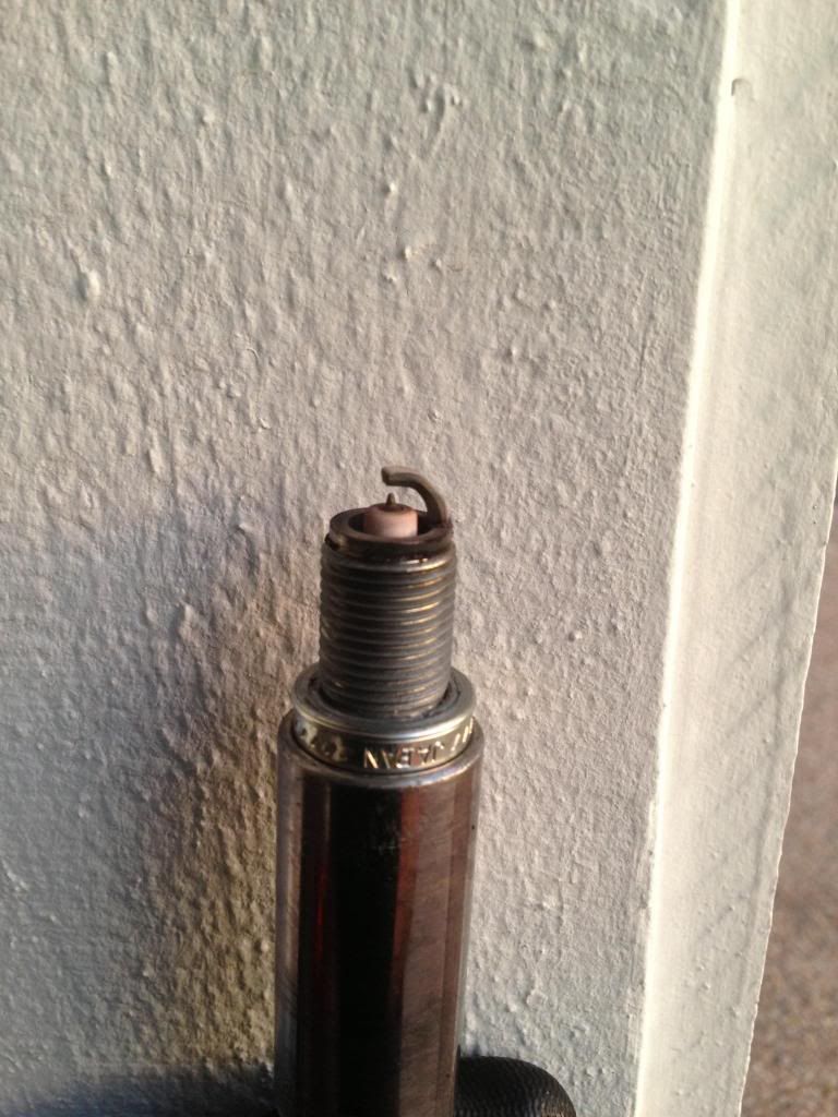

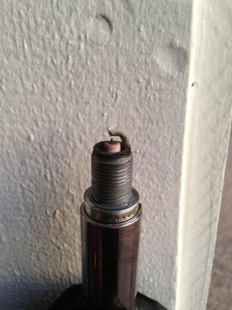

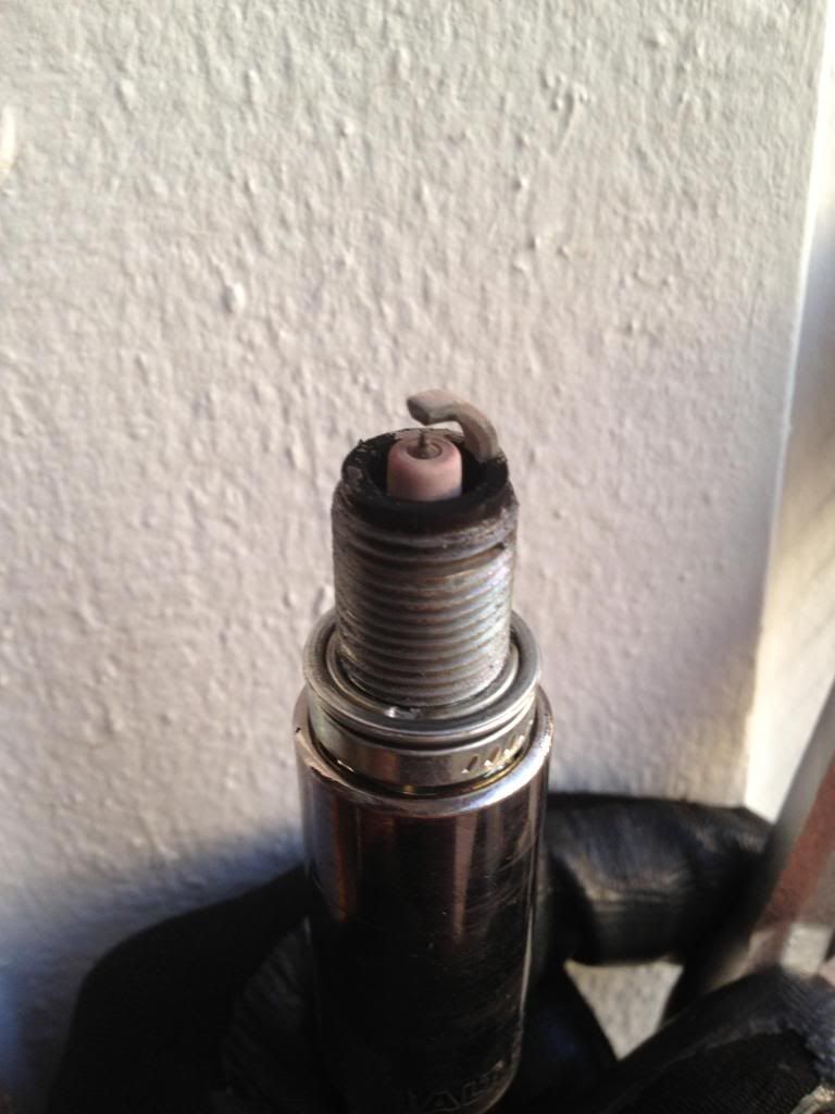

Does this sound like Detonation or pre ignition? I ran a tank of 91 over the last week and it did not make a difference. In the video I am holding the brake and giving it throttle while the shifter is in D. It only happens under load after the car is fully warm, and get louder/more prevalent the hotter the car gets, this was just after driving in rush hour stop and go on the 101. I pulled the spark plugs and they look fine, not sure if there would be any indication on them.

From passenger side (plug # 1) to Driver's side (plug#4)
Plug #1
Plug #2
Plug #3

Would I not see some indication of it on the spark plugs?
