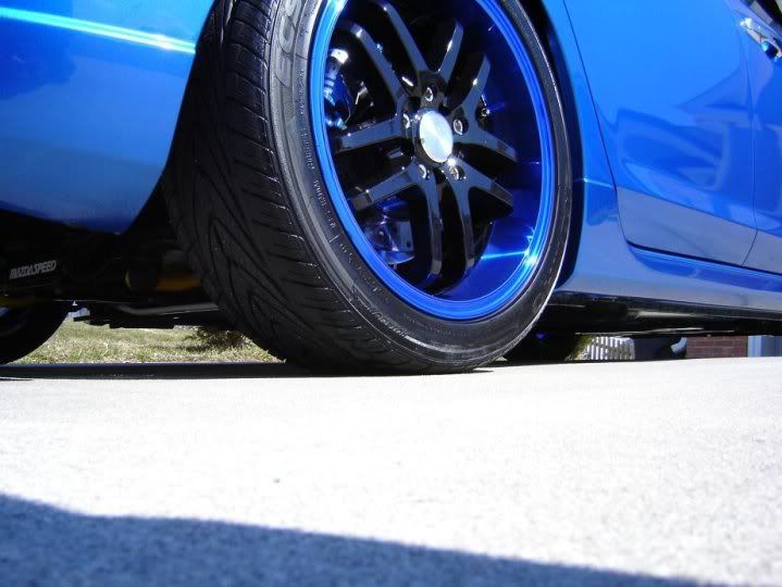

These look like my Kazera 18x8 KZ-L, but obviously painted

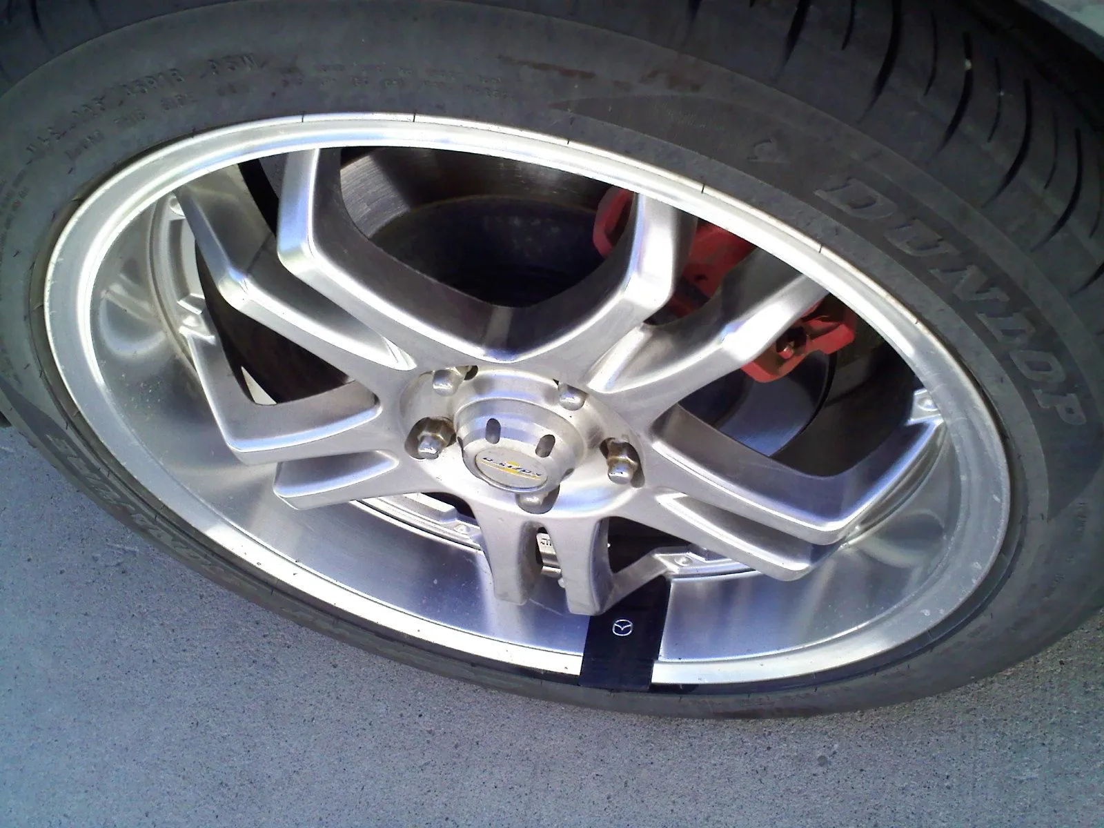

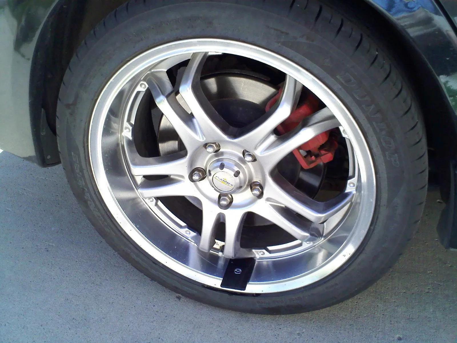

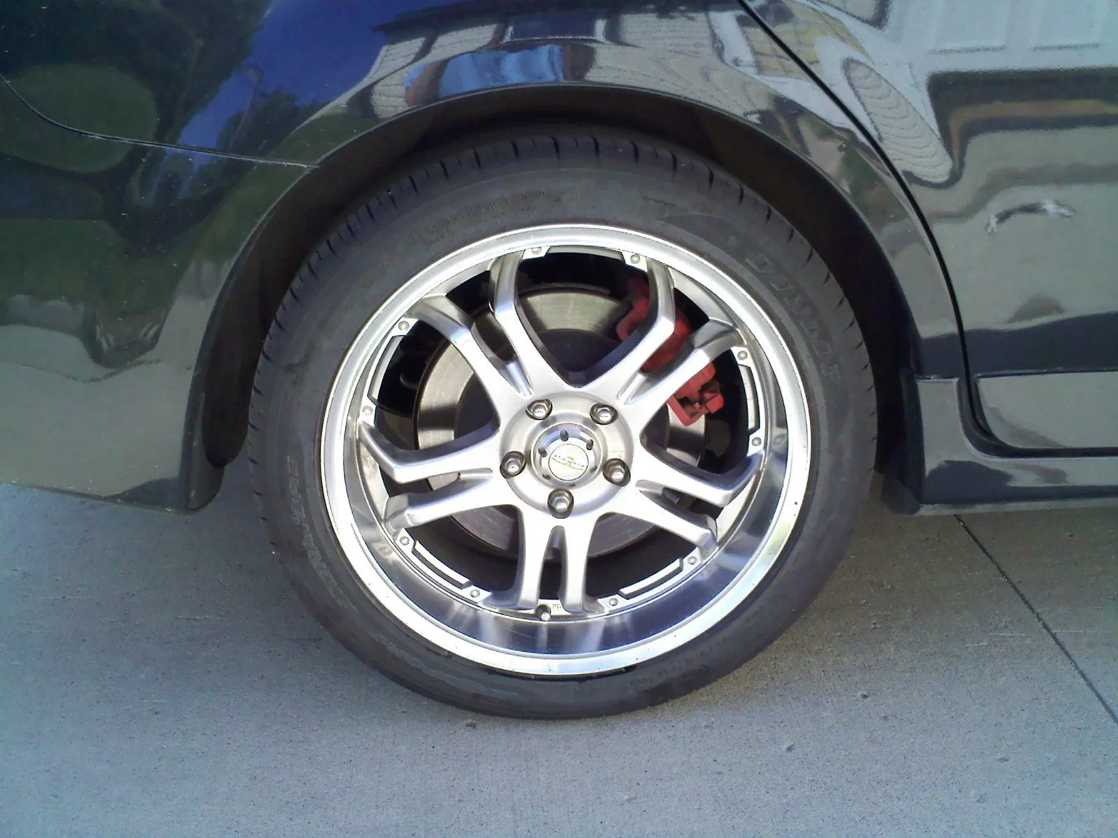

Mine have a reasonable size lip on them with ET45. The are 19x8", but they are available in 18" with the same offset. They are Lenso S73, black gloss with polished rim. When I had 215/35x19's on they didn't rub at all with no fender rolling and running H&R springs. Having just switched to 235/35x19's, I have had to get the rears rolled, but they are fine now. This is how it looked with the original 215's on.

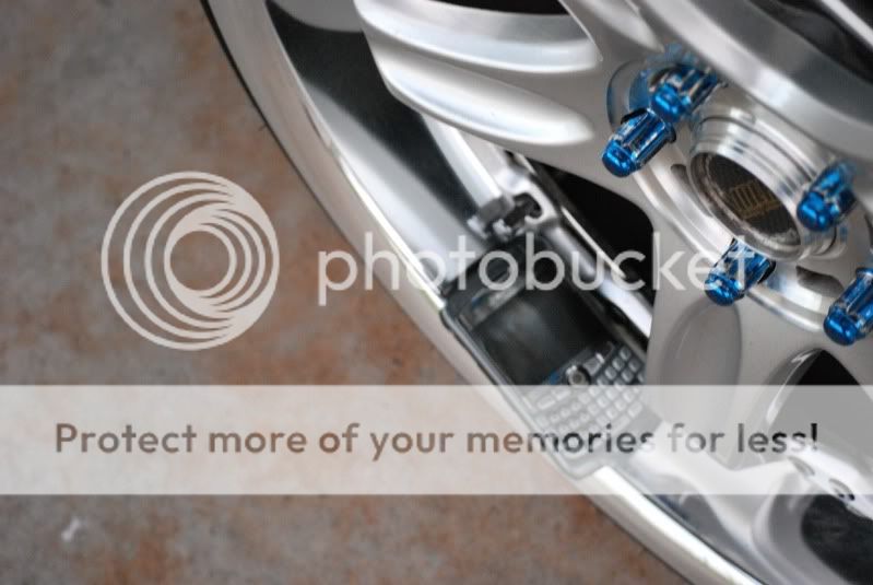

2.5" lip. My blackberry will show you how deep it is on a 10" wheel. If you want your wheels to meet the fender at the same point I wouldn't go with offsets any lower than +37/8.5" wide, +43/9" wide, and +49/9.5" wide. Even then, it wont be an easy fit.
