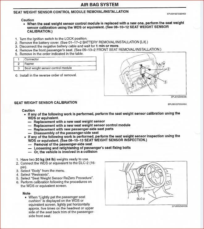

I checked the workshop manual and so far I don't find any code that relates to that subsystem.
It is simply a 'weight sensor'. how can there be a code? There is no way for the computer to compare
the actual weight of the person or object on top of the seat. with the reading of the sensor.
So I think it is just an independent 'switch' (i.e. it tells the airbag not to deploy because its a child sitting there.
I suggest you ask MAzda or the dealer, What codes are they 'expecting' to see for this particular problem.
Or ask them to check their workshop manual. There is another part of the manual that's titled "Troubleshooting by
symptoms'. This part does not need codes. There is a complain, then they should try replacing parts
and you observe if it happens again. And so on... I mean that's what I would do If I'm the mechanic.
who knows in the process of checking out the under neath the seat, maybe they will find out something maybe loose
connectors etc..
I scanned this page in the workshop manual.
They should do this to confirm the subsystem is working ok.
there is no need for codes:
