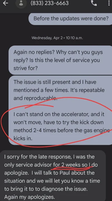

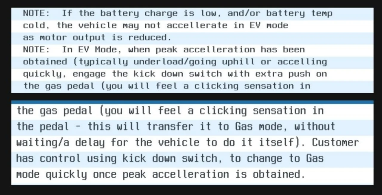

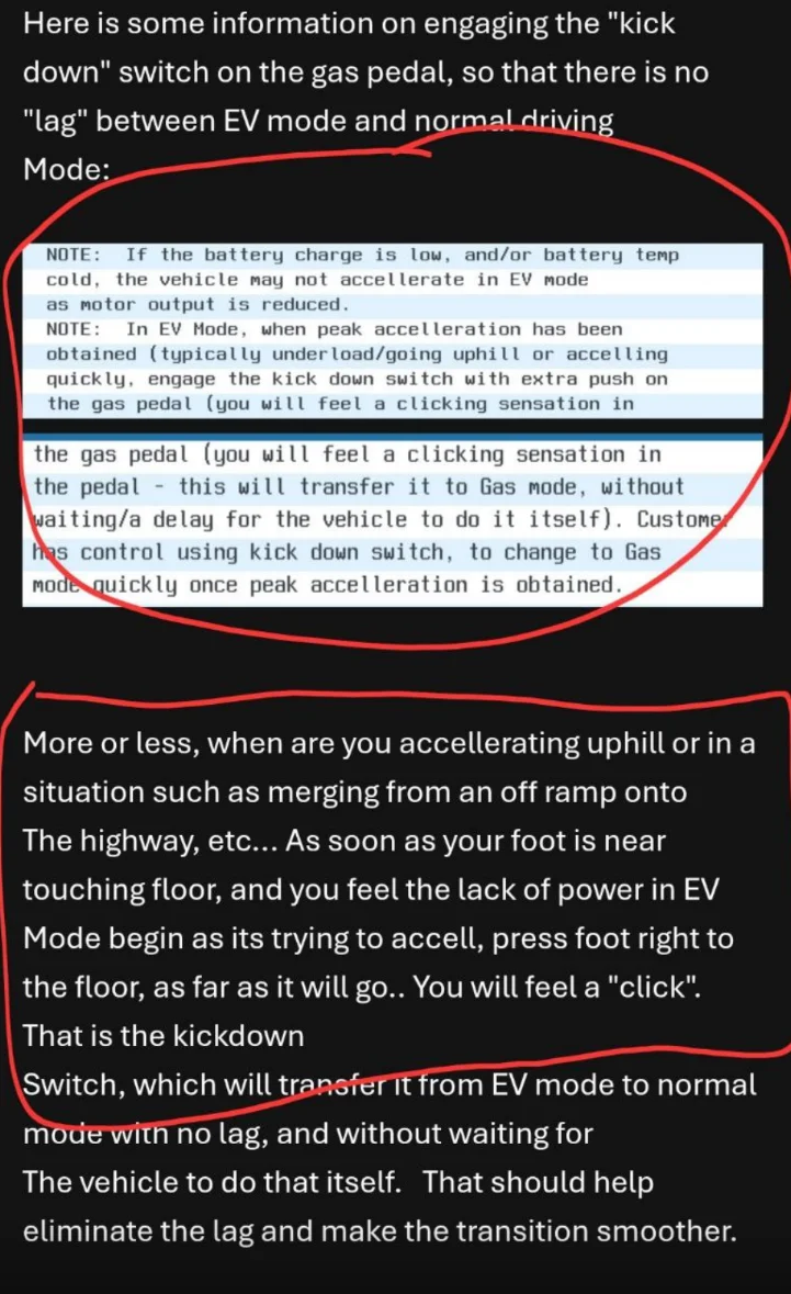

1️⃣ CX‑90 Acceleration Lag
  • Severe acceleration delay when merging or entering highways — sometimes taking several seconds to respond, which is dangerous when trying to merge into fast traffic. This is a nightmare for my wife, with our two kids in the backseat, 5-6 second delays in throttle response is not uncommon.
  • This acceleration lag is not covered by any Technical Service Bulletin (TSB), but Mazda has been unable or unwilling to fix it after 7+ months. They just want us to keep trying to diagnose it. They have no clue, and both the dealer and Mazda Canada field techs can't figure it out.

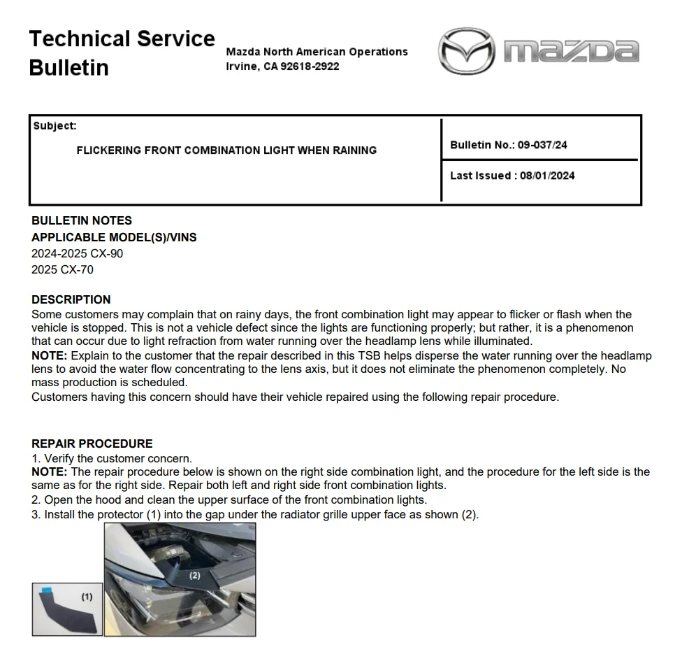

2️⃣ CX‑90 Headlight Water Intrusion
  • Rainwater leaks inside the headlight, which is covered under an official Mazda TSB.
  • Even after acknowledging the issue in January, Century Mazda in Halifax did not order the TSB repair part until March, and only after I followed up multiple times. Then they just ghosted us, and Mazda Canada is OK with that. They have shared that its OK for dealers to not respond to customers if they choose, even on serious safety issues.

Thanks! I am following the Mazda escalation procedure. Mazda Canada has been involved since February, so its not really just a dealer issue anymore. Mazda Canada would love nothing more than to reset the process and further delay it, but we have met the requirements already and had their field service Managers attempt to fix without success.
