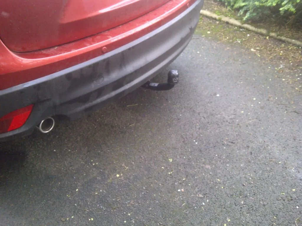

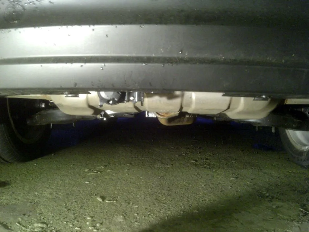

Had the Mazda fitted towbar fitted here in the UK and there is a cut to the bumper but not noticeable unless you get down on your hands and knees.
Would not be very happy with the quality of work shown.

I'm getting my detachable towbar fitted tomorrow.... It apparently requires a small cut (max 30mm deep) in the underside of the bumper.... The Mazda dealer has assured me it won't be visible unless looking from underneath..... I hope he is right.
I certainly would not accept what has been shown by the photos earlier in the thread.

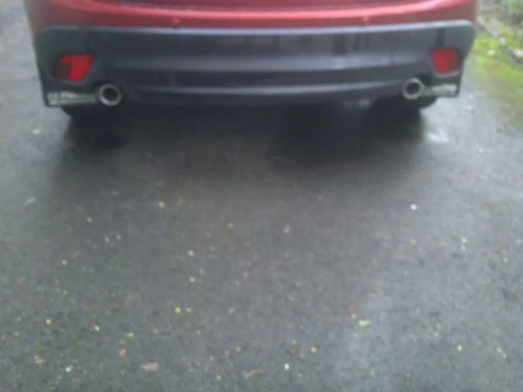

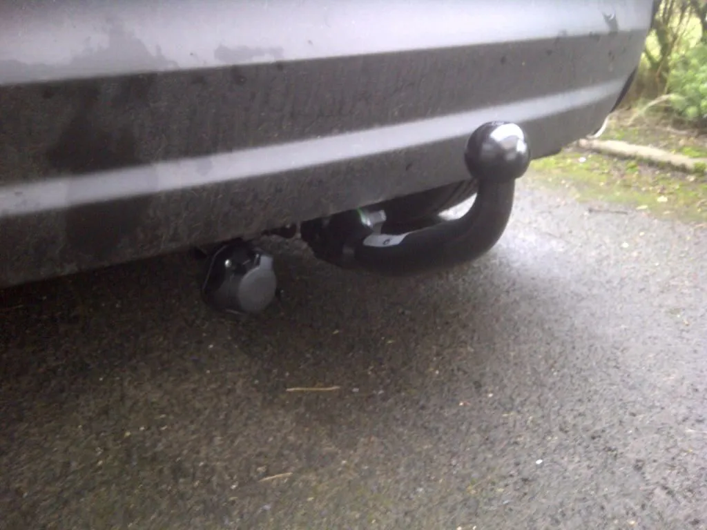

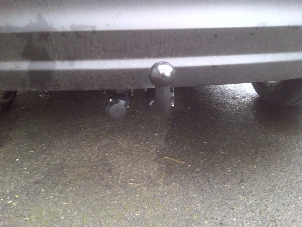

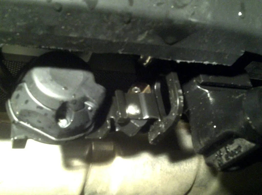

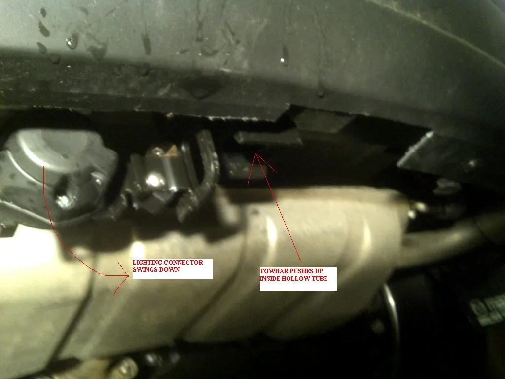

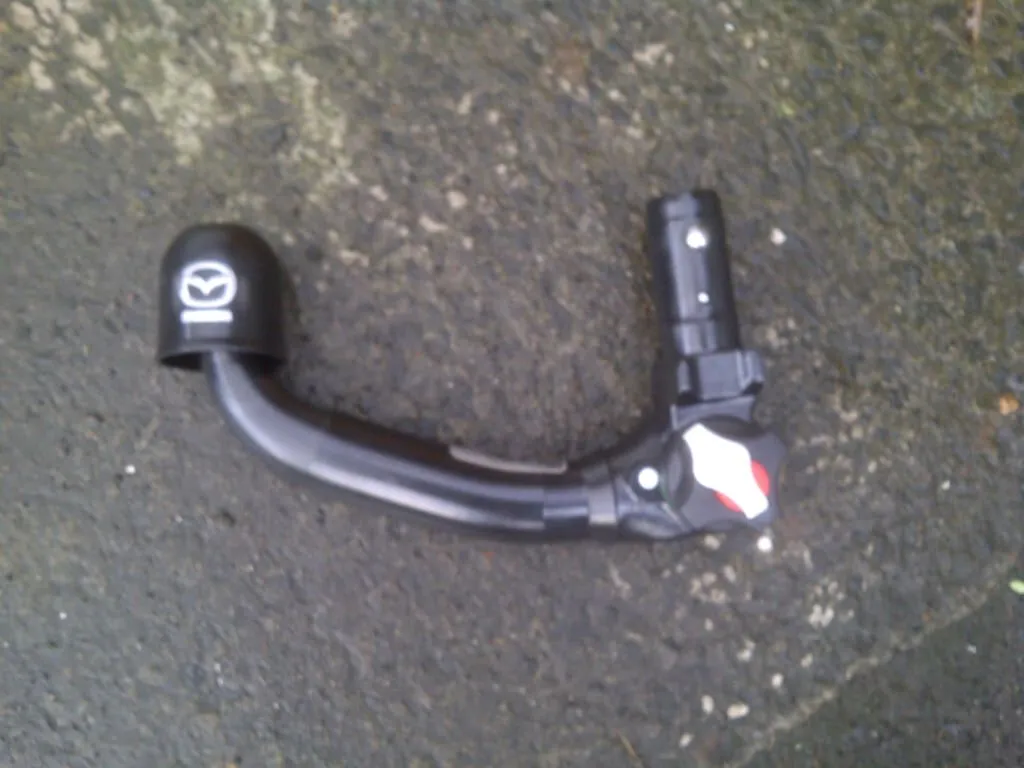

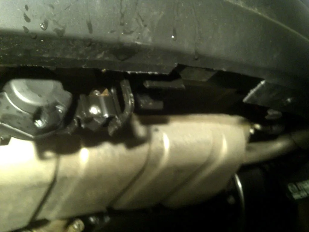

The US seems to get a different detachable tow bar than here in the UK.... the UK one seems a lot more visually pleasing. When the towbar is removed from my car I can see nothing, unless I get down on my hands and knees and then I can see the bottom of the swing down lighting connector..... I attach a few photos, one of them marked up to show what I mean.
IMG-20130130-00205.webpIMG-20130130-00204.webpIMG-20130130-00202.webpWORKING DIAGRAM.webp
View attachment 200646View attachment 200647View attachment 200648View attachment 200649
My hitch looks exactly the same,very discrete
The US towbar is completely different, and has no lighting connector either. Is there a chance that either of you could post a pic of what it looks like when it is in place for use? I'm having a hard time translating those pictures into something I would expect to see as a tow hitch here in the US.
Some more photos attached... hopefully these will show it better.
The US factory tow bar does include a bracket for the lighting connector. It's up and out of the way and you can't even see it unless you kind of get under and look for it.
