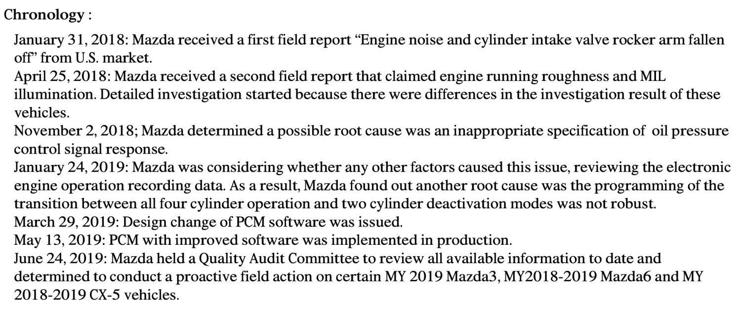

I enjoy reading the chronologies associated with recalls. This information can be found under "Associated Documents" for a recall on the NHTSA website.
Here's the chronology for one of the recalls on the 2018-2019 CX-5:
Interesting, I didn't know chronologies were available. Thanks for the heads up!
Thanks for the finding. Now we know the official story from Mazda why it took 8 months since Nov. 2018 when Go Hawks encountered the incident. But in Nov. 2018 Go Hawks did receive a newer version of PCM firmware and that’s why he kept wondering why Mazda didn’t update all PCMs to prevent this dangerous situation happening to anybody else. Mazda had another design change on PCM after Nov. 2018 based on the NHTSA’s chronology. Hopefully Go Hawks did get a recall notice and had his PCM updated again if he still have the CX-5.
Interesting fact is Mazda received the first report of fallen rock arm on Jan. 31, 2018, and they didn’t find anything on it until Nov. 2, 2018 for root cause?
