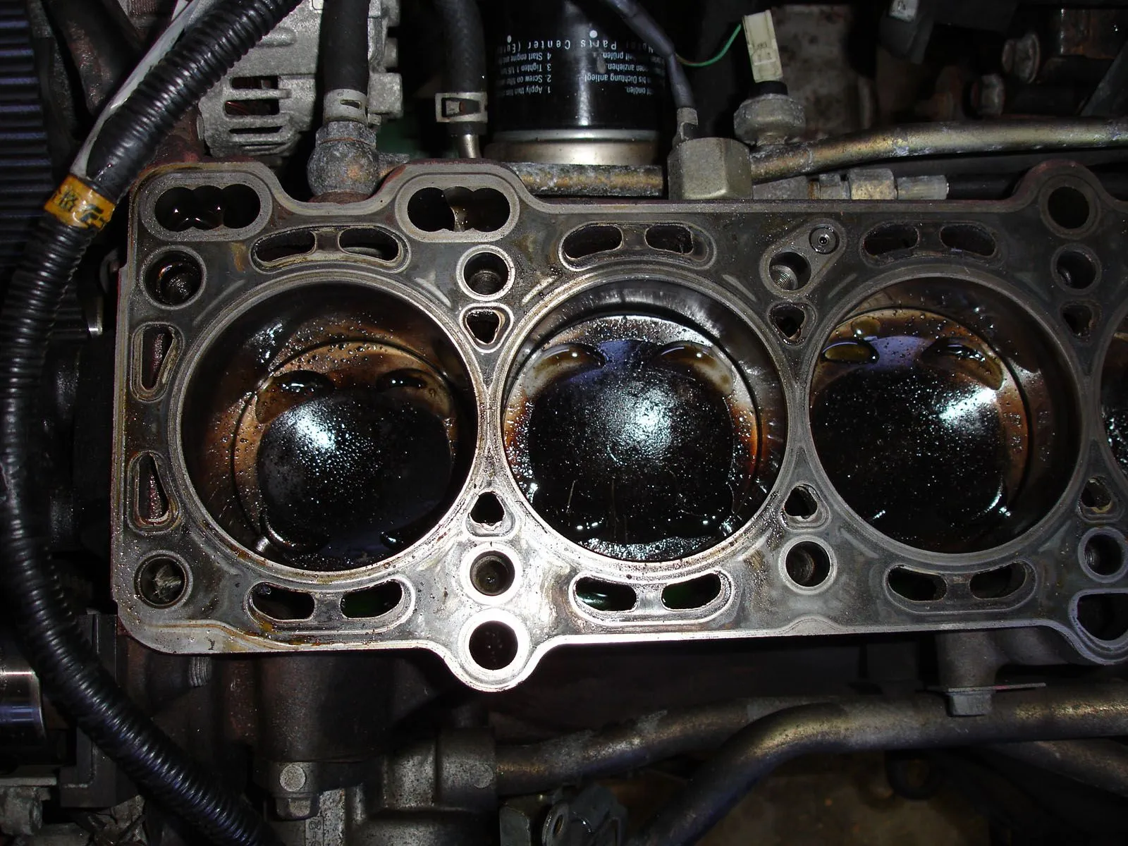

Here is a picture, please tell me if you want me to clean all the oil and take another

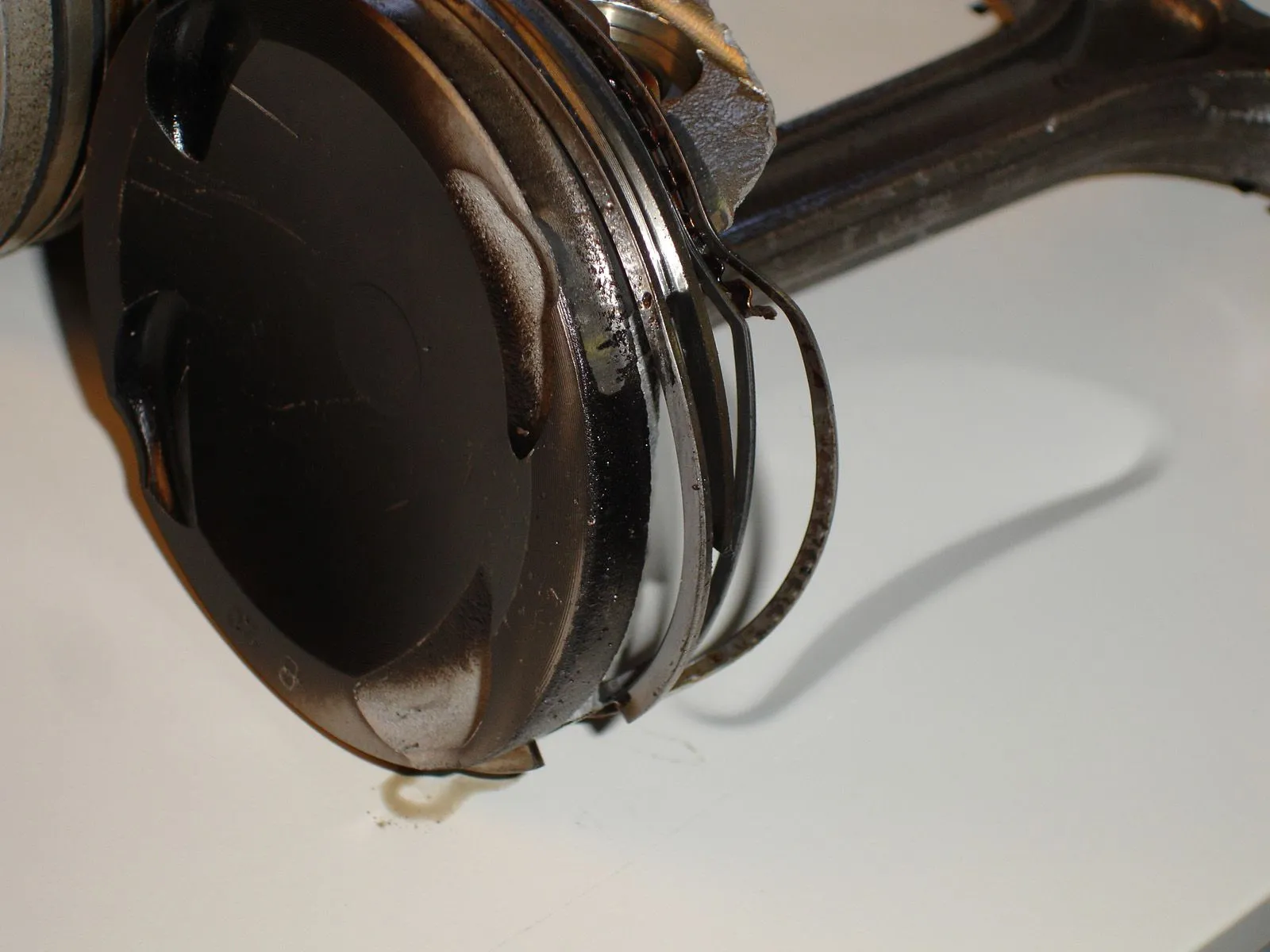

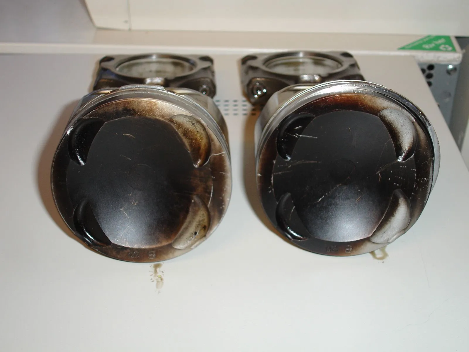

Not much response on the first picture, so I'm uploading two more. Here is piston 1 (working) and piston 2 (defective) and a picture from the side showing how bad condition the pistonrings was in. Still hoping someone might tell me what might have caused this.
I see the edge is melted. Looks like she got lean. Is the rod bent? Where did rest of the skirt end up?
OK, lean of fuel or lean of oil? Can this be the wrong tuning of the MPI or something in the engine block?
The rod is still perfect, but what do you mean by the rest of the skirt?
Lean of fuel maybe not enough timing retard? Looks like the whole side of the piston is missing. Were you able to retrieve that. Any damage to the block?
I don't know much about tuning unfortunately, the guy I bought the car from helped me tune the MPI. - about 1400 miles ago.
It looks more like something is broken off than just melted, but that is the thing, I didn't see any parts there. It was not in the oil pan. But when the guy helping me dissasemble the engine took the pistons off I wasn't there to look for it.
The block seems perfeectly OK, we tested by inserting one of the working pistons and look for imperfections, found nothing.
