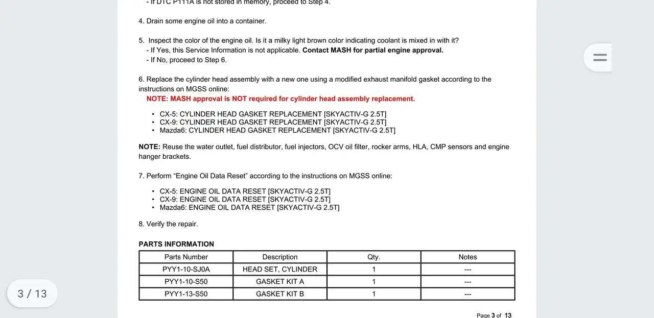

I am curious what the new revised head cost. Might be a good sticky. And the revised exhaust gasket too.
I just reread the tsb. Apparently there is no updated head. It's just an updated exhaust gasket. Wow.

Well that part number for the head in the above tsb has been revised a few times per my mazda dealer parts guy. Latest pn is PYY1-10-SJ0C. $850. Plenty of inventory. Says he sells about 1 head a month according to the computer between to his mechanics and customers off the street. This is a very large mazda dealership. Beginning to think this problem has been overblown a little? Hard to say.
It said in description of the TSB. Both exhaust manifold gasket and cylinder head have been modified.
“DESCRIPTION
Some vehicles may have coolant leaks at the cylinder head around the exhaust manifold (as shown below). There may be cracks at the stud bolt hole (1) or at the outside of the exhaust manifold (2).
Cracks may be caused by:
• Deformation of the exhaust manifold during usage causing unexpected force to certain areas of the cylinder head.
• Residual stress generated during production in the cylinder head material may be greater than expected. The
external force from the exhaust system when driving over bumps may cause unexpected force to certain areas of the cylinder head.
To eliminate this concern, the design of the exhaust manifold gasket and the cylinder head has been modified to reduce the force on the cylinder head.”
