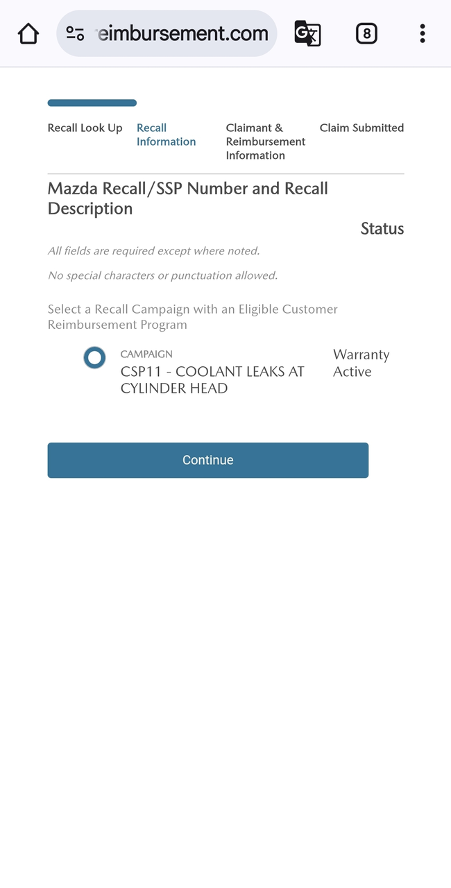

Just coming here to let everyone know and give some hope...We had to have our engine replaced in Sep of '22 due to this defect. After fighting with our local dealership we had to pay $2100 out of pocket for the repair back then. Received the CSP letter from Mazda in late December, applied for re-imbursement on Jan 1st, and was notified yesterday that Mazda has approved our claim and would be receiving payment in 10-14 days! Good on Mazda for FINALLY making this right.
Just coming here to let everyone know...We had to have our engine replaced in Sep of '22 due to this defect. After fighting with our local dealership we had to pay $2100 out of pocket for the repair back then. Received the CSP letter from Mazda in late December, applied for re-imbursement on Jan 1st, and was notified yesterday that Mazda has approved our claim and would be receiving payment in 10-14 days! Good on Mazda for FINALLY making this right.
