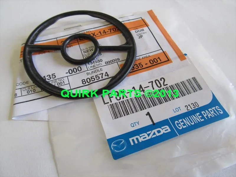

Thank you for the help and direction from all above. Unfortunately, the representatives of the Parts Dept. at local dealerships don't understand that the part-number IS available for the O-Ring Gasket, and it can be purchased for < $5. Again, thanks to the help from those that posted prior, NoSuchSol in particular due to his link leading to my discovery of this info & part-number:
Mazda Part-Number: LF8X-14-702

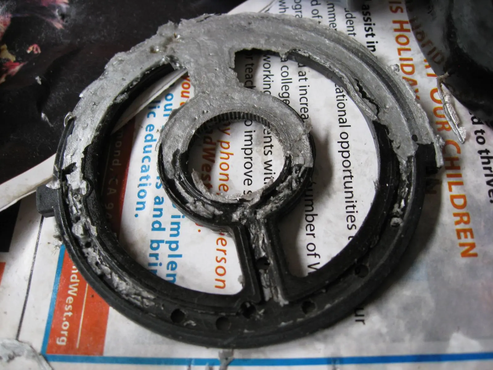

For the early models that have the black oil cooler there's now a rubber O-ring( 2 ) # LF8X-14-702 LF8X-14-702-d.webp that cures the well known leak. Once the cooler & oil filter housing are removed you'll want to clean all parts thoroughly, including the plastic OEM seal that requires removal of the old rubber seals so that when you reassemble it with the new O-rings (1 on each side) everything fits proper with a good seal.
