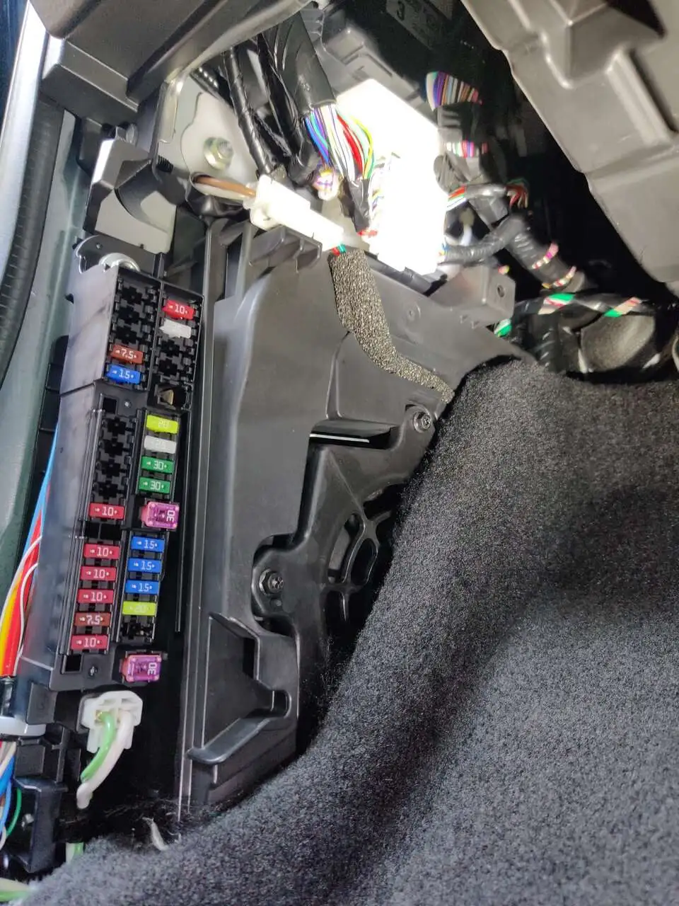

Not sure how you get this cover off or if there's enough space behind for a battery. Is this the right place?
There is no battery behind the cover, just junction boxes, cables and a speaker (black section bottom right). Suspect this is a noise suppression speaker (noise cancelling).

I´ll bet it is in the right side, don´t think they change harness because it is a RHD (thx Hawke ;) )
Yeah I thought the same also, but according to my source, the harness is different between LHD and RHD, and the sub-battery is on the left side in RHD vehicles.
Apparently it's located under the foot support, under a cover located there.
If you lift up the carpet, you should be able to see the foot support, you need to remove that, but I'm not sure if that's possible without removing the passenger seat first. Proceed at your own risk :)

I just had to control my curiosity and just had a camera probe down behind the fairing on both sides, I can't see any battery anywhere, so what was linked to is probably not correct. :unsure:
So think, if there are any backup battery, Hawke maybe got it right, as located under the foot support, - I don´t know.

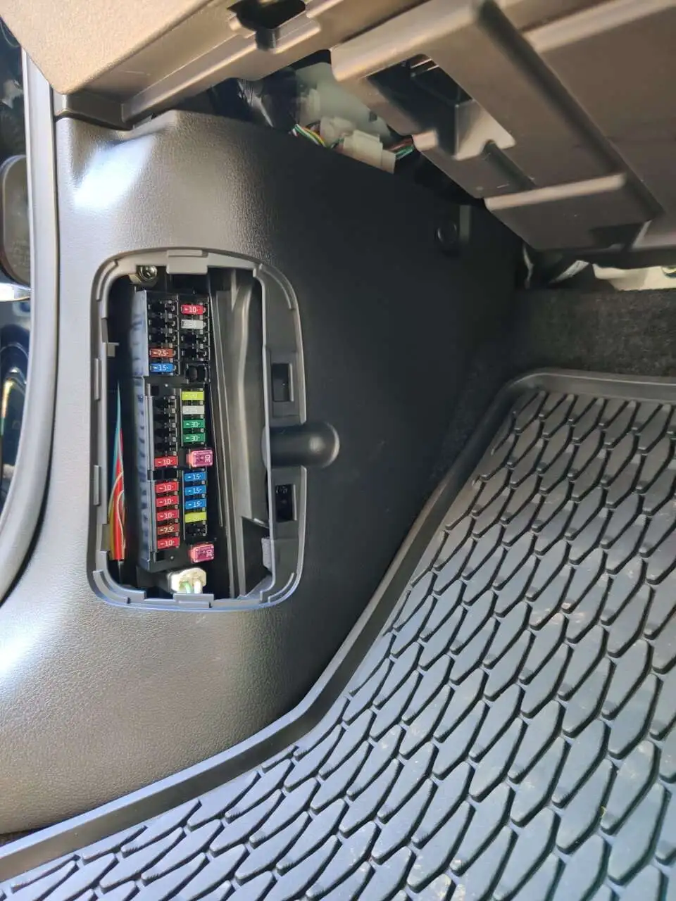

I had a peek in there but couldn't see beyond the insulation. I don't intend removing anything else. I will check the drivers side kick plate area though just to be certain. If no joy I will take it in for the 'experts' to figure out. This alarm is very annoying.
Thanks for your help. If you can't see it with a camera I think I'll leave the drivers side cover alone.
