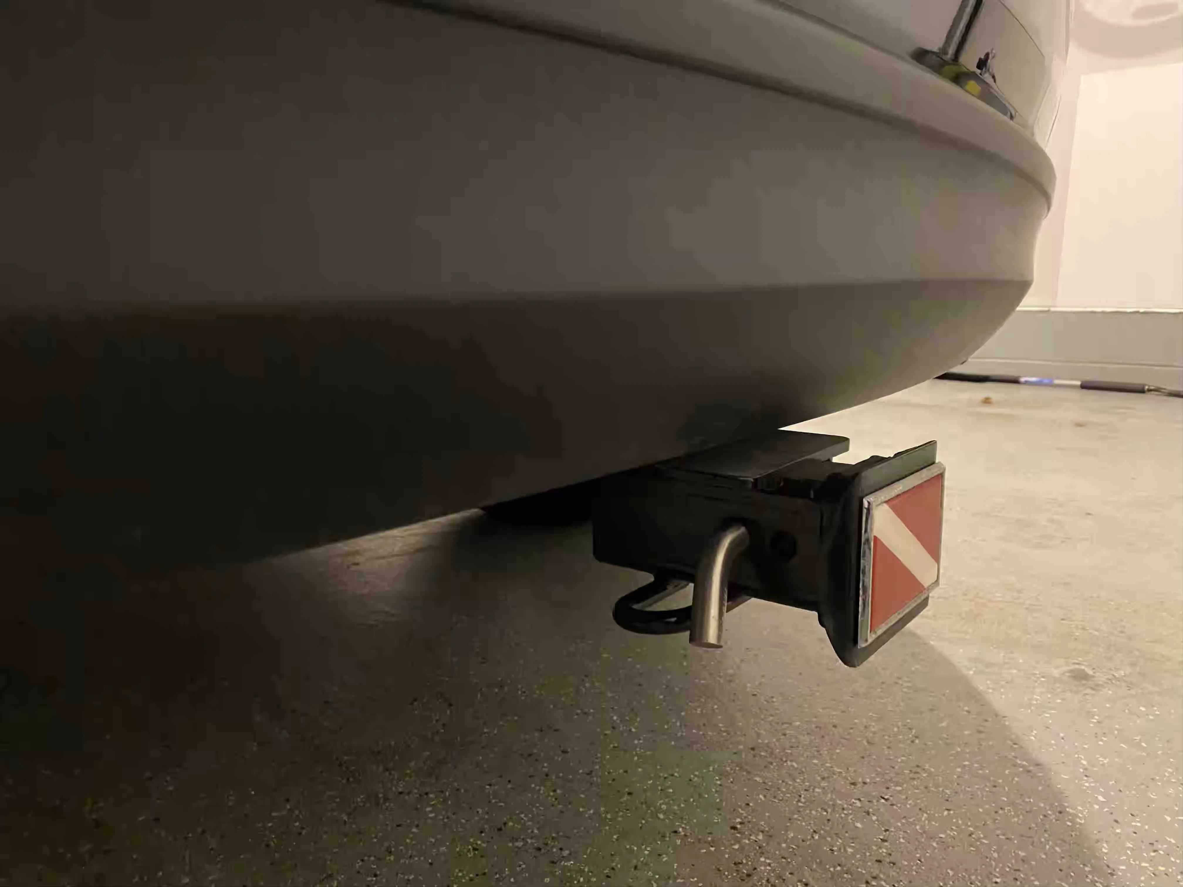

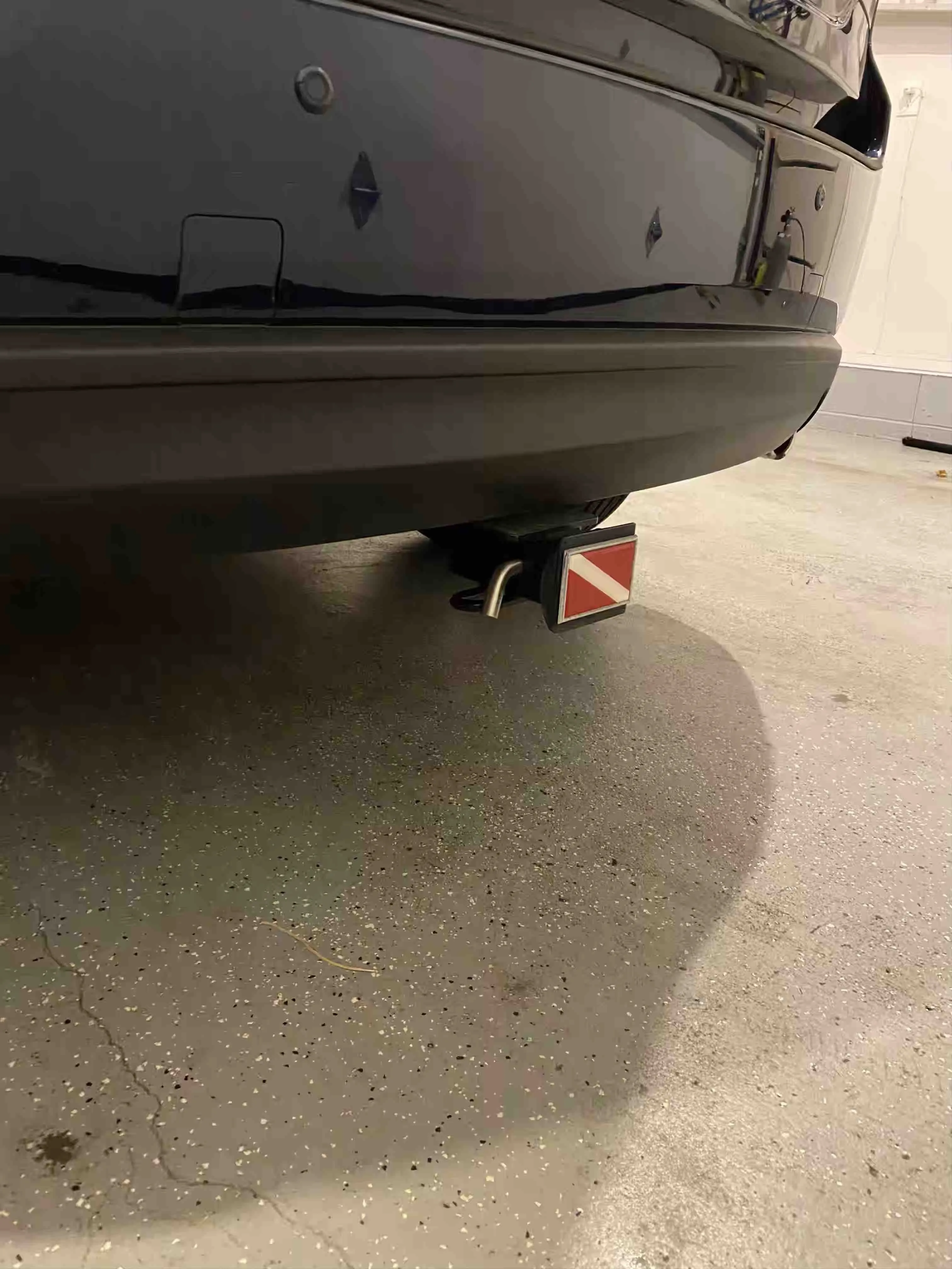

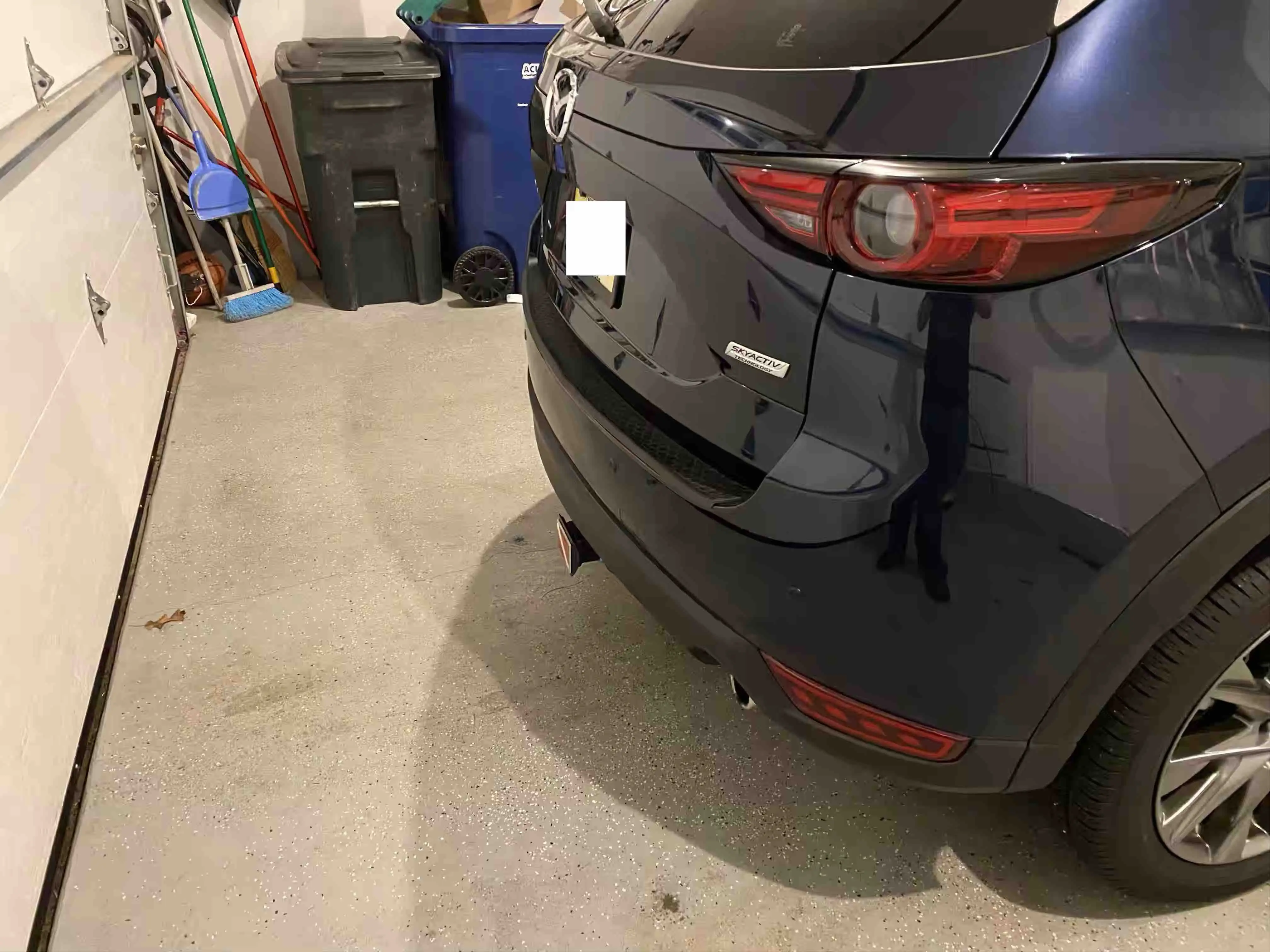

It is up to one's personal choice and what they will use it for. I got the Curt class 3 and am very happy with it. I already have 2" accessories from my last car. There is about 10 1/4" ground clearance and it is about even with the bumper (the first picture), it's unobtrusive and not all that noticeable. It's 34 pounds which isn't too bad. I picked the Curt over etrailer's draw-tight hitch because I didn't like the metal plate that is welded above the receiver on the draw-tight.

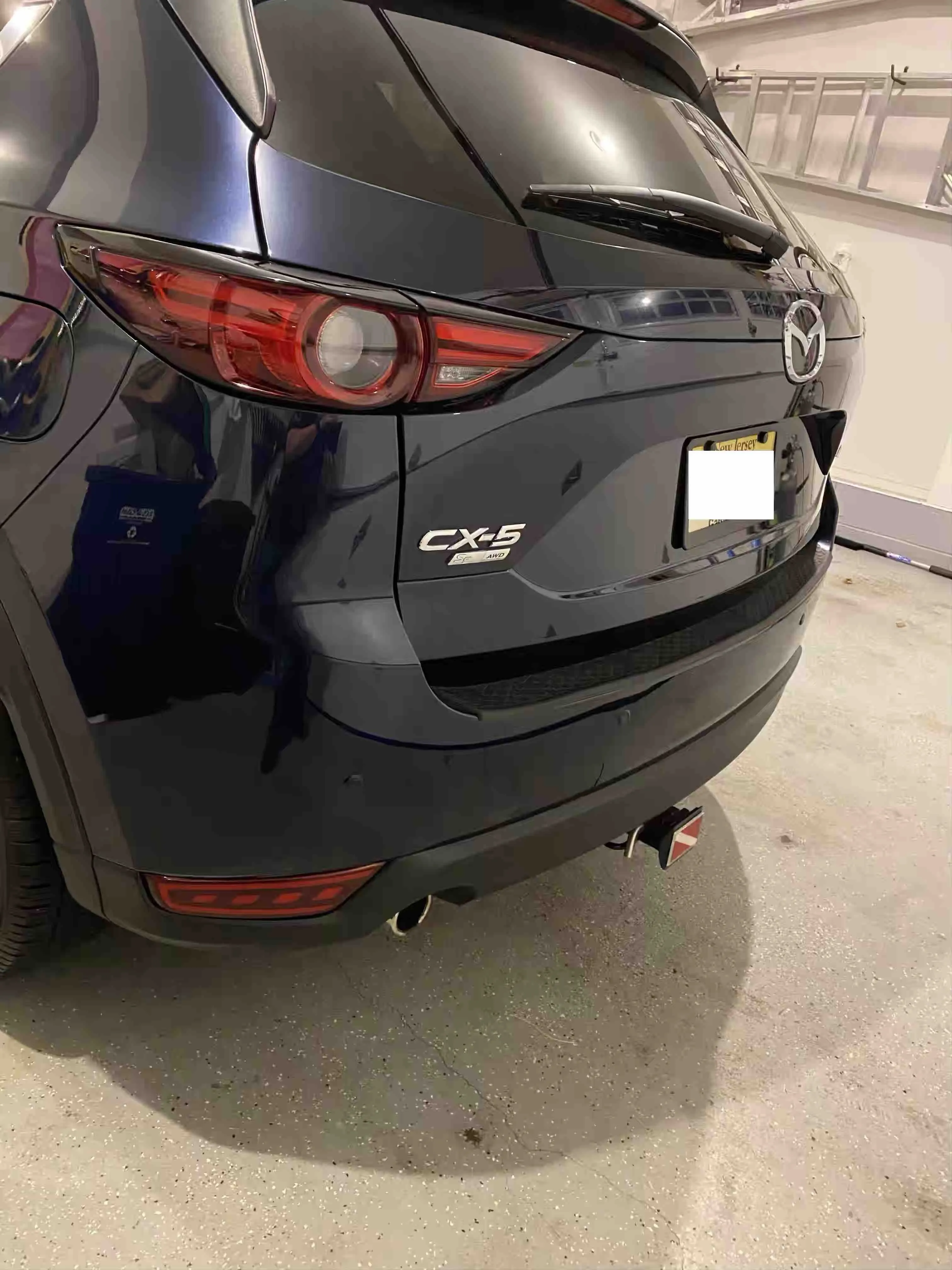

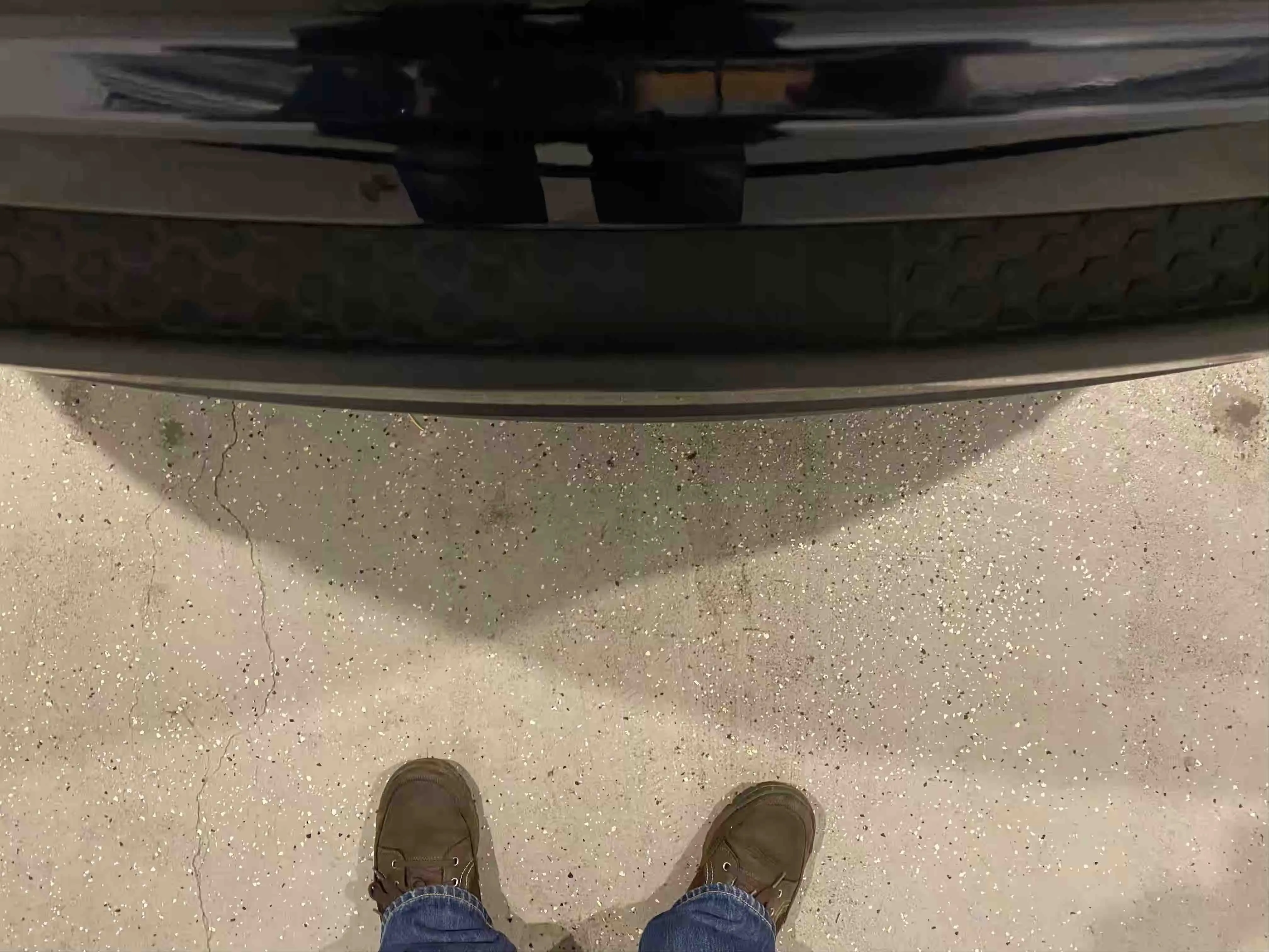

I'll add some photos for non-OEM installation. I went with the Draw-Tite (76138) one and installed myself (used some RhinoRamps and a torque wrench and had it done in under an hour). I tried to get a photo of the top plate so you can see how unobtrusive it is. Additionally, here is some info on the difference between the Curtis and Draw-Tite hitches: https://www.etrailer.com/question-325079.html. Don't get too caught up as both hitches are fine.

One of the photos I included was top down from the rear of the bumper. You definitely cannot see the Draw-Tite hitch from the top down and it is ever so slightly recessed behind the bumper. Mine even has a receiver cover (the dive flag) that sticks out beyond the receiver end just a tad.
