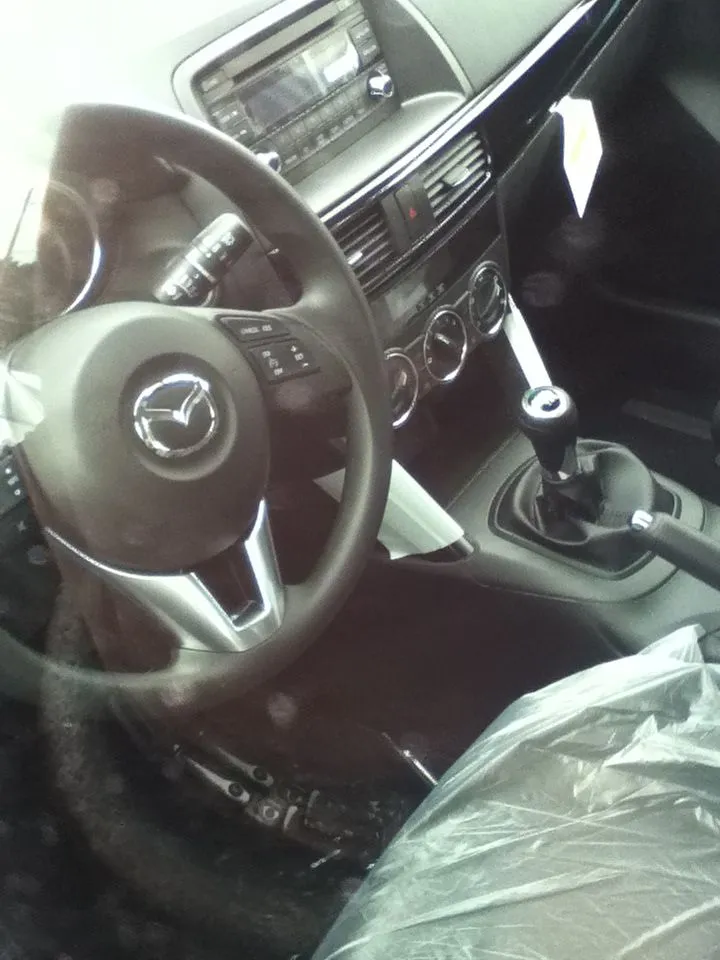

In the Toronto (Canada) area a dealer had the base model (called "GX"). I was supposed to drive it, but unfortunately it was damaged en-route to the dealer so I couldn't take it out.
The CX-5 looks quite big beside my Protege5.
