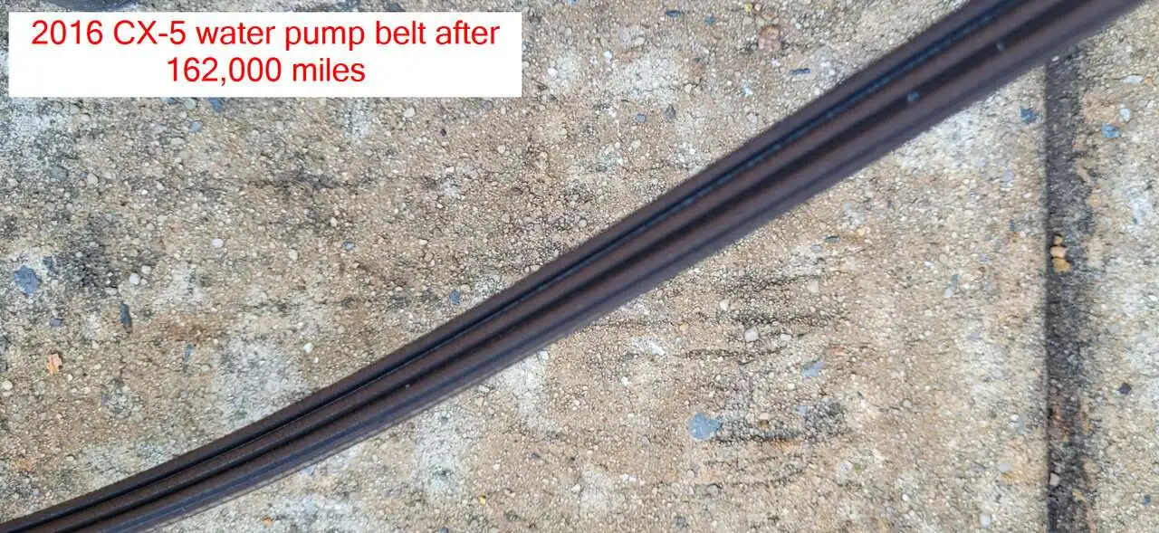

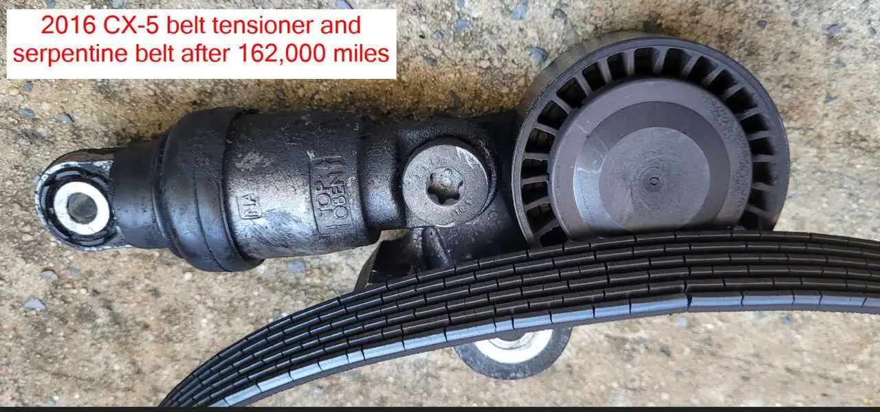

I did mine over the weekend, my 2016 has 162,000 miles on it. The belt tensioner was shot to hell, oil leaked..... probably a long time ago, but car still drove fine. The serpentine belt was in pretty bad shape, cracks all over the place. the water pump belt was okay, no cracks but hardened and turned brownish color. The process was pretty simple, I just followed fellow CX-5 owners instructions on youtube... How to Remove + Install/Replace Belt Tensioner on 2.5L engine for Mazda 3, 6, CX5 and Mazda CX 5 CX 3 Mazda 2 Mazda 6 Biante Skyactiv How to replace V belt / Water pump belt .
Are you using aftermarket belts such as Gates? It’s been said several times here that if you use aftermarket water pump stretch belt it’d be more difficult to install as it’s a bit smaller than the OEM water pump stretch belt.
Hi, I only used OEM, I had no fitment issues and the installation was easy, I just followed the youtube videos.. I figured if the original OEM parts lasted 162,000 miles, might as well go with OEM and try to reach 300,000 miles without changing again. I'm going to drive this thing until it can't run anymore, LOL. These are the part numbers I used for 2016 CX-5:
